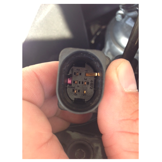

Any tips for removing a primary O2 sensor while the exhaust is still mounted to the car?
It's pretty tough to get to.

Honestly I think its easier to pull the exhaust off. Pretty easy to do.

I second pulling the exhaust off it will make it much easier. We offer a few different different 02 sensors, for more information Click Here.

Turned out to be a bent prong in the sensor's plug. Car runs great again, thank jesus.
