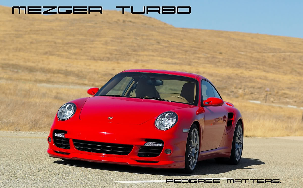

This is a very beautiful photo, I use it for my desktop background, though I wish it were 1920x1080.Originally Posted by cannga
BTW I have this old picture that I did a while ago, before this discussion ever exists:...
Do you have more photos, from other angles? (I have two monitors :-) ).
