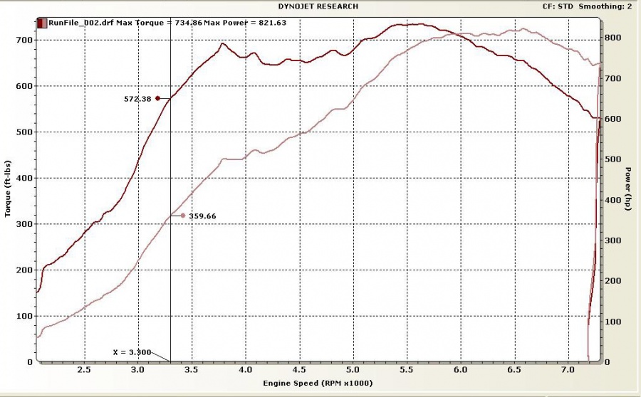

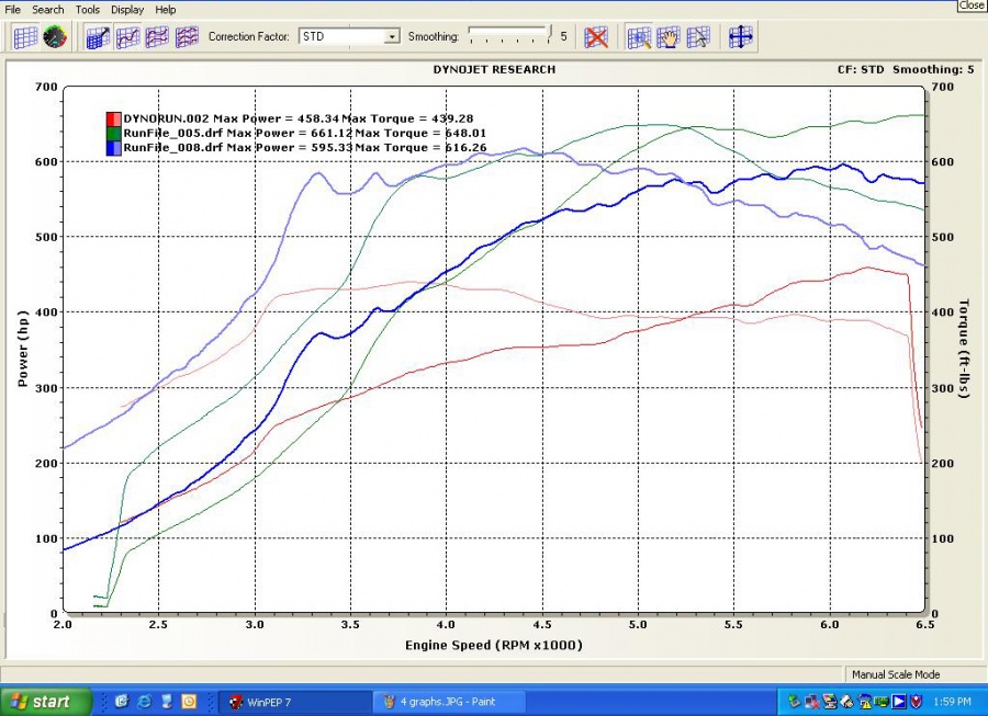

Old Jan 21, 2013 | 12:16 PM

Originally Posted by Tom@Champion
Here you go. There are two attachments. The first one has 3 graphs on it. A stock 997TT, our 65mm VTG's, and our full 68mmVTG kit. All three of these are cars with stock engines, never running more then 23psi.
The second graph shows our full 68mm VTG kit on a car with a built 3.8L engine at higher boost levels (28psi). No other hardware was changed except the modified engine and increased boost.
Thanks, seems amazing, but why havent you done some 60-130 runs, it takes seconds and can be done safely? Or since you are in the US, do a easy start and just go for a high trap speed in the 1/4 mile?
Well, where we are located in Florida is a very populated area. The roads are all congested and busy and there's a lot of traffic.
Sure there are some quiet roads where it could be tested, but we've chosen not to take any chances with our cars, customers' cars, or our lives lol. Some customers have done tests, maybe posted on here but I haven't seen them besides KerCar, Arone997tt and a couple others. However, now that it's such a problem for people not to know...i will do my best to try to get a test next time I have a car here available.
We're comfortable knowing the power our kits produces. From those power numbers, the performance will come.
