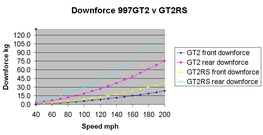

Although pricey, a GT2 decklid + a GT2RS blade insert would give you this (credit goes to Toby)
