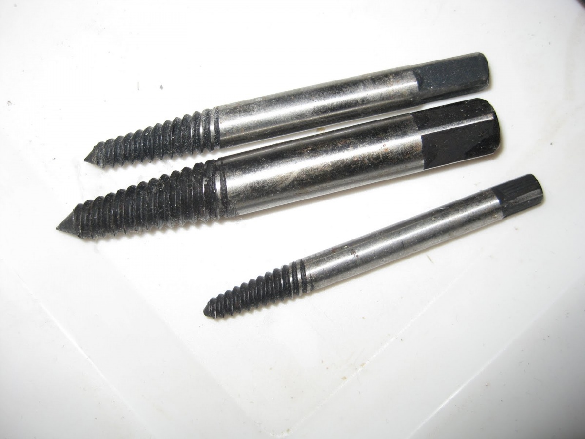

Vice grip...or you could either try and drill it out using one of these if it is broken flush:
Is the bolt broken, or just stripped? If it is broken and flush, you could even remove the entire turbo and have a fabricator build up the nib with a TIG and then use a vice grip on it, after which, chase the threads.

If you put some PB blaster on it tonight, you can try these tricks also...
Bolt extractor:
The Dremel trick would work, if you cut into the bolt, you can use an chisel and hammer to spin the bolt around.

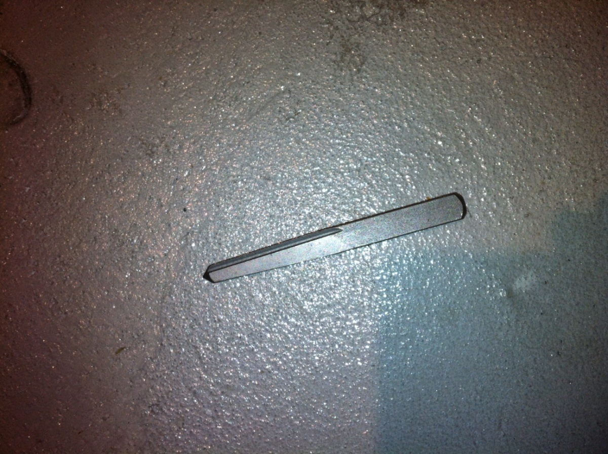

Lastly, my personal favorite (but may not be applicable in your situation)
Drill a small hole in the center of the bolt, and hammer this in then use the vice grip.

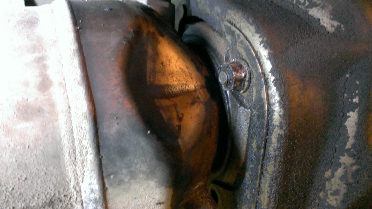

Bolt head

soak the nut and threads with Wurth Rost-off and try the vice grips again. Make sure they are TIGHT. avoid needle nose ones as the length causes them to twist.

Got it with a large set of Vise grips. Now i will have to figure out where to get some new bolts. Thanks for both of your help with this. I soaked the bolt with WD-40 rust release spray.
