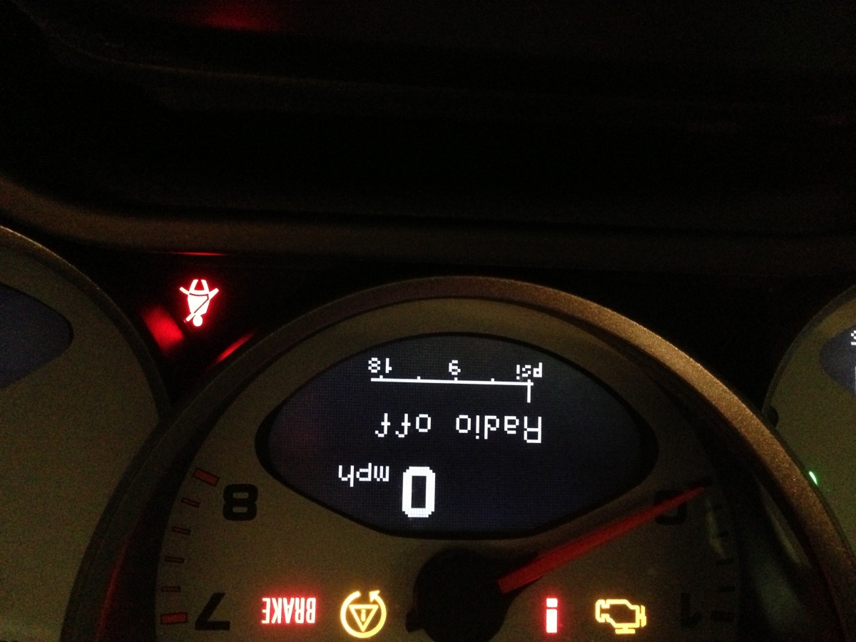

I have 2008 turbo and gauge reads from 0 to 18 and it reads like that even when boost is zero. Just went out to the garage, turned ignition on (didn't start) and selected the boost gauge - here's what it looks like. Show this to the service guys and ask why yours doesn't look like this. As I said 2008 turbo with SC option. Not sure why the picture is upside down - when I select to upload it is correct...but open it, flip it around and you'll see the range of psi from 0 to 18,

Thank you for the info. I have a 2007 though, so I am not sure. At this point I have to be absolutely sure.

My '07 does not have SC and max BAR/PSI are 1.0/12. My last TT had SC and the gauges were 1.2/18 respectively. My GT2 was even higher. Looks like it shows max performance capability that the TT came from the factory with.

My 07 TT with SC shows 18psi
