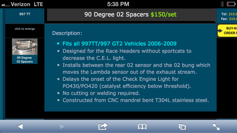

Exhaust faults.... 2 option
1- Get a better exhaust (I had fabspeed and I hated)
2-Get the 4 (2 sets) 90 degree 02 spacers from fabspeed
https://www.fabspeed.com/997TT.html

You have the version 3 (I had the 2) the version 3 should be louder.... So I guess is better....
The spacer should fix the problem
