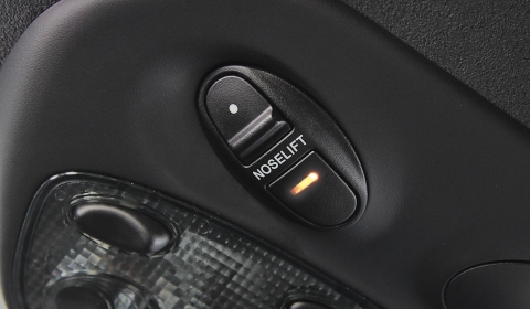

I have the TechArt on my GT2. Brochure is attached.

I think TA is the only setup that incorporates the lift into the car and looks OEM - don't Cargraphics and KW require a remote?

My KW's come with an illuminated button that I mounted in the ash try. It also comes with a remote. I didn't like the TA because you loose the universal remote feature which I need.
I also looked at getting the OEM GT3 lift kit but it took too much effort to source all the parts.
I mounted mine on the drivers side wall. I will get a picture.
