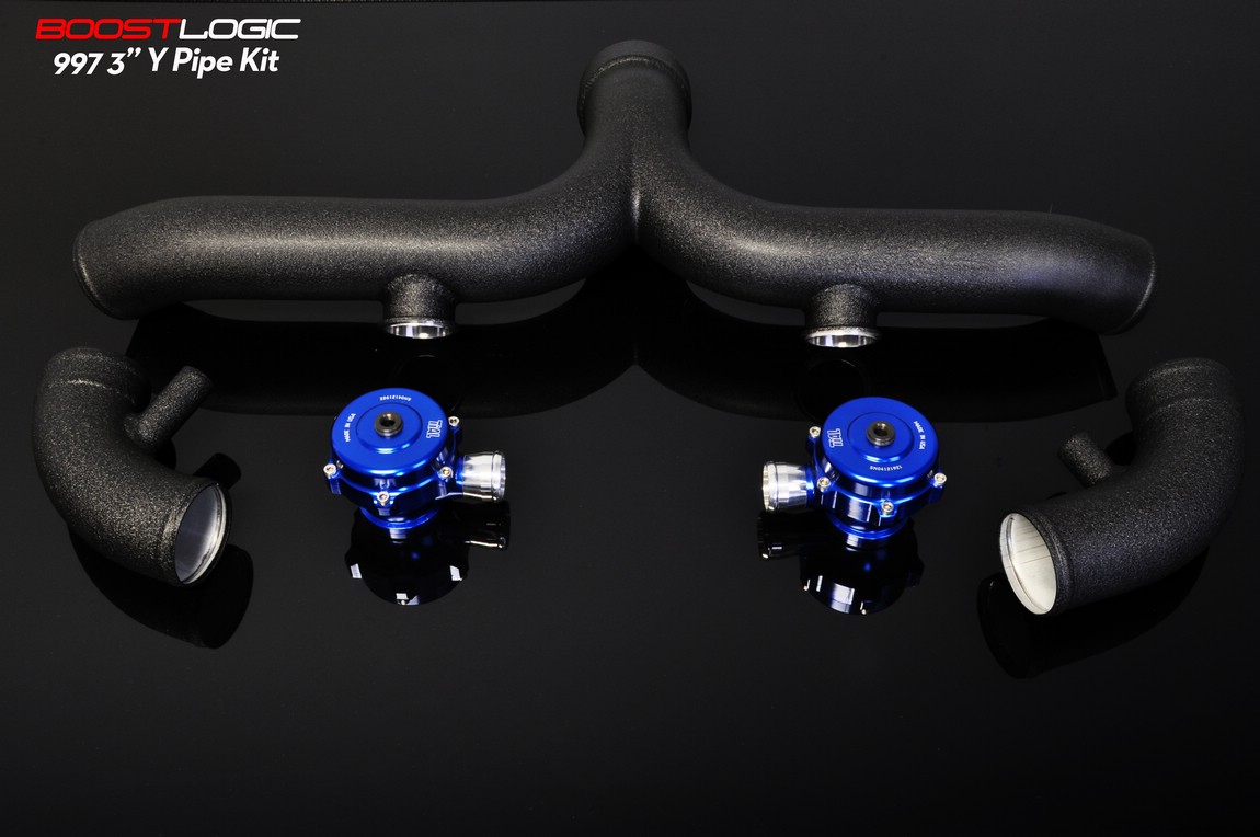

Y-Pipe and TiAL QR’s off the car

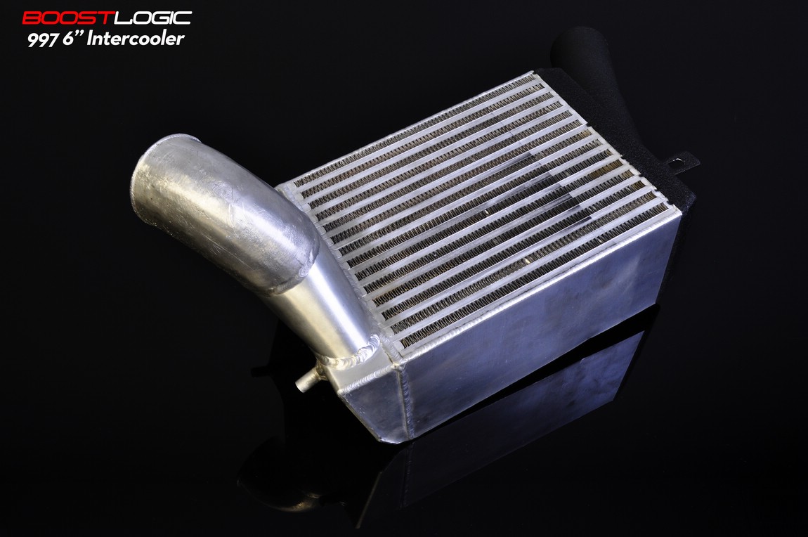

Boost Logic 6” Intercoolers

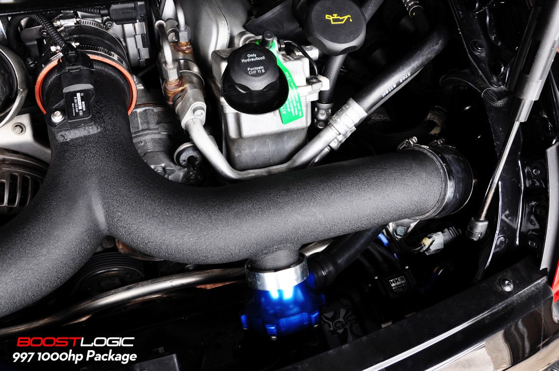

Y-Pipe Installed

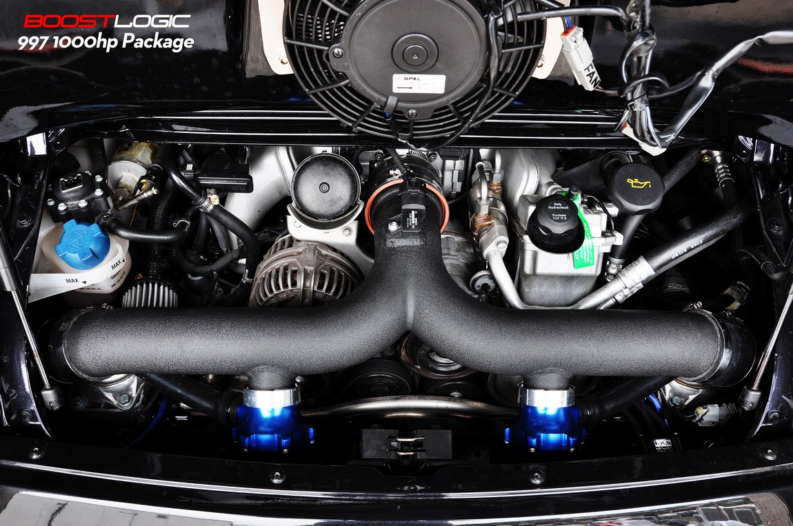

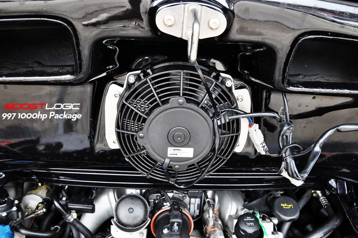

Engine bay fan modified with Spahl fan.

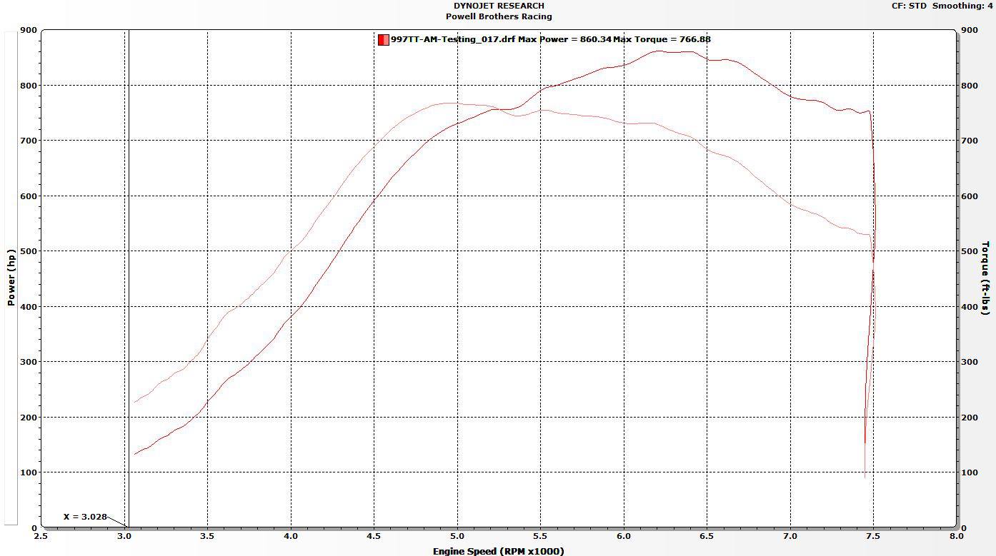

On 1.7bar on MS109 the car made a lot more than what we expected:
860rwhp / 766rwtq
