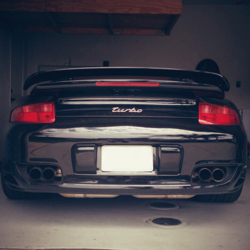

Does the Protomotive exhaust hang below the rear bumper at all? I'd love to see a picture of it installed if possible.

Awesome thanks. That looks good.

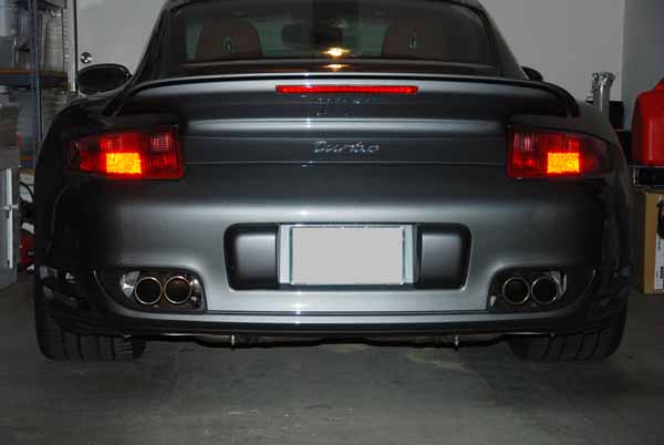

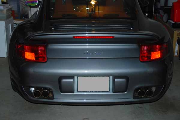

Couple of additional views....
photo taken from sitting
photo taken from standing

Your driver side exhaust tips look uneven?

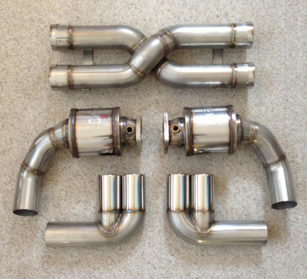

Just a quick note, that hole you see in front of each muffler is for the pre-cat O2 sensor. The post-cat O2 sensors are not used with this kit so you just unplug them from the car, access is easy from the engine bay near the engine mounts.
Then you will need your tuner to program out the post-cat O2 sensors.

Mine or TTdude's?

Looks like driver's side on mine but passenger's on yours. Bob's really analytic about stuff like that. I think it's some form of OCD -- LOL. Not sure if the outside and inside tips have the same diameter (will have to check on that). That could enhance the droopiness look from certain angles. We may have to bend them a little to satisfy Bob.
