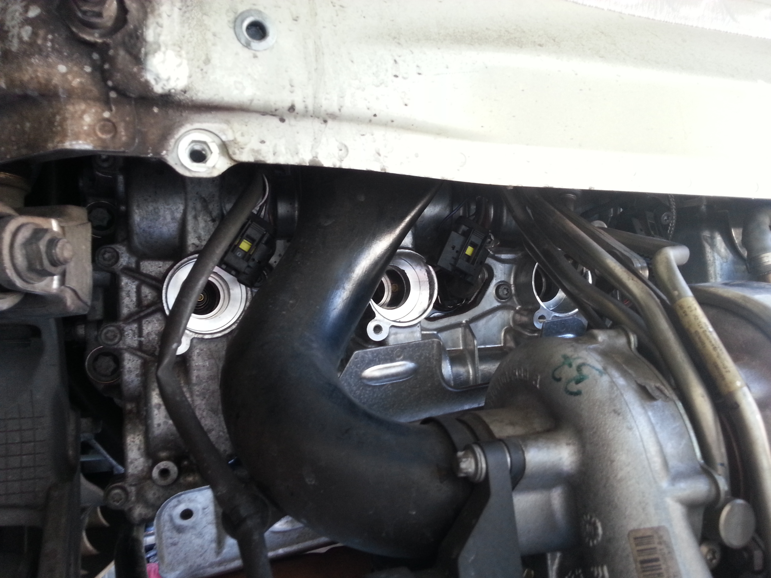

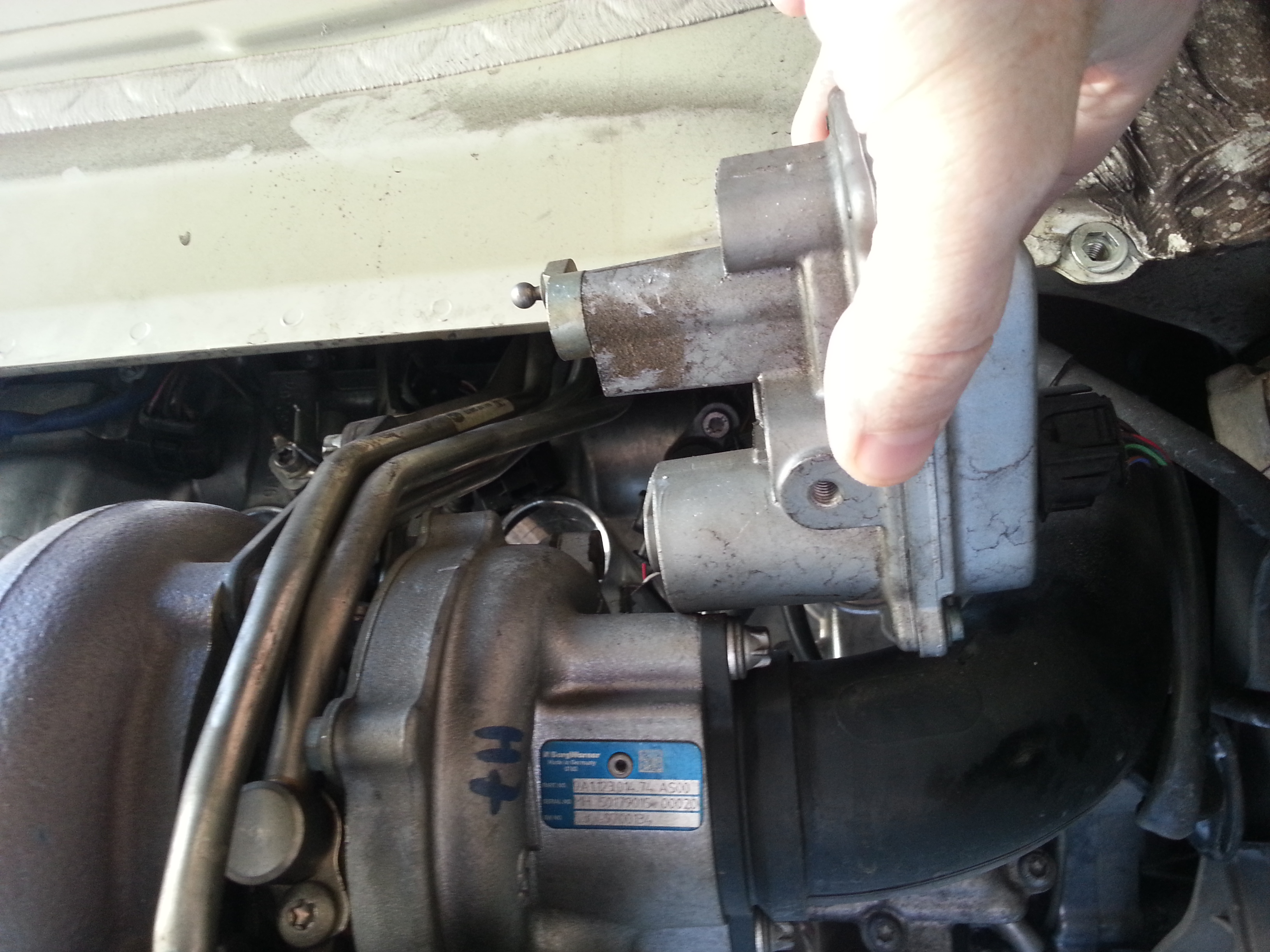

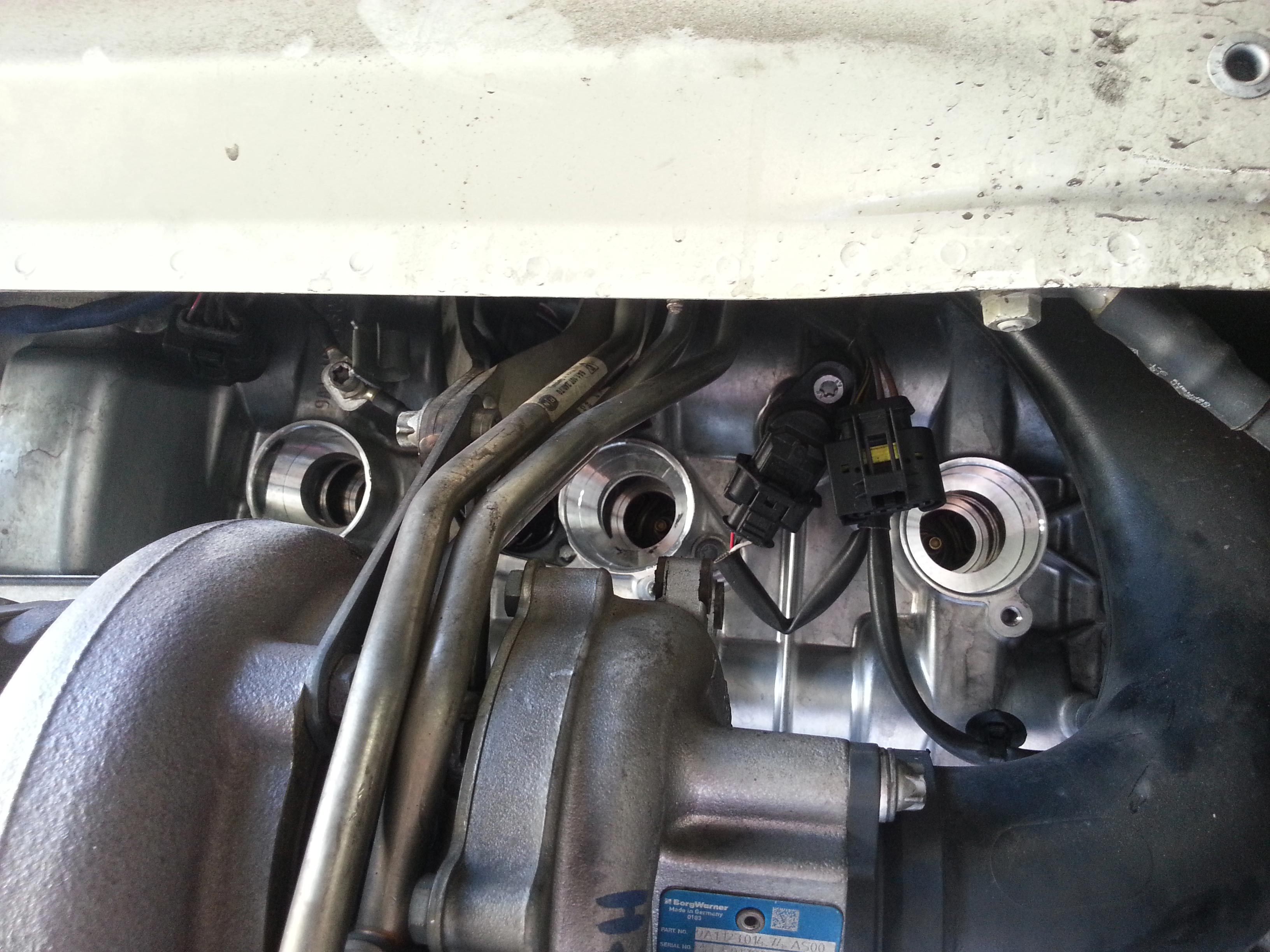

After doing a lot of research on how to replace spark plugs and seeing the difficulty, I was debating on doing this job myself. After procrastinating the last 3 months, I got the nerve to start the job today. I have a friend who owns a shop so he let me use his tools and lift. I started at 9:00am and was finished at 12:00pm. ONLY 3 HOURS!!!! I thought this job was going to be a nightmare and I was presently surprised how easy this job turned out to be I am not an experienced technician and only dabble with small projects. It turns out that the 997.2 Turbo is far easier than the 997.1. Here is what needs to be done for this model:
1. Remove rear wheels and inner fender well. Very easy
2. Remove rear taillights (2 screws on each side). Very easy
3. Remove rear bumper. Very easy
4. Remove intercoolers. Easy
5. Remove heat shield (2 screws on top of each side). Easy
6. Remove heat shield that cover plugs ( 2 screws). Easy
7. Remove the VTG on passenger side only. Easy with long extension and ball end allen
8. Remove one torx screw for each coil pack. The forward and rear are very easy to remove. The middle is easy once the VTG is removed.
9. Remove spark plugs and re-install new ones. Very easy
Note that the only difficult side is the passenger's side. The driver's side is very simple. No need to remove the VTG or anything else.
I did not have to remove any oil or coolant lines to the turbo. Just the VTG on driver's side so the coil would back out. I cant believe that both shops and the dealership wanted to charge me over $1000. I am not a mechanic and it only took 3 hours from start to finish. The hardest or should I say, most tidiest part of the whole project was the removal of the bumper, intercooler, and VTG. Removing and replacing the spark plugs took only 20 minutes tops.
Unfortunately I only took pics of each side showing the coils removed. I didn't want to tie up his lift so these are the only two pics. One of them shows the VTG unit that has to be removed. It is only held on by 3 allen type screws. 2 in the back and 1 in the front.
