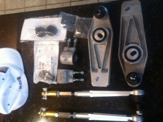

With gt3 Lcas I'm able to achieve -2.0 front camber with stock springs.
My setup:
