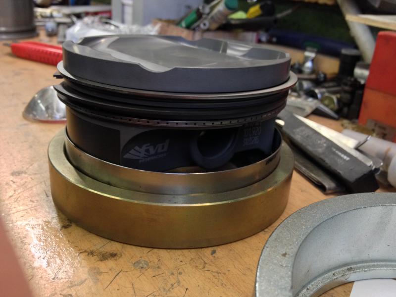

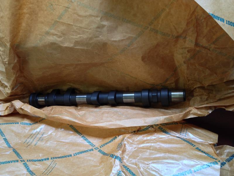

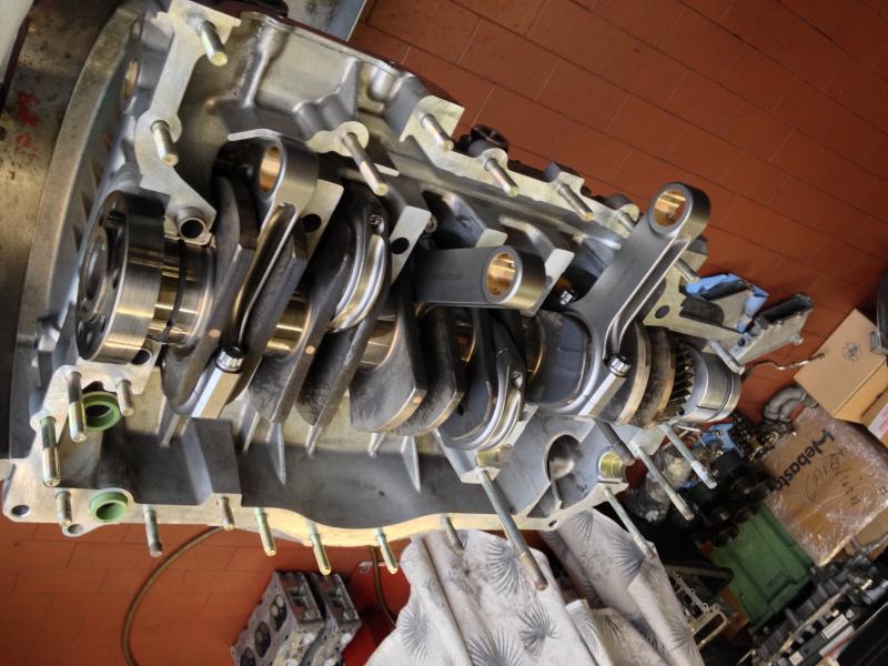

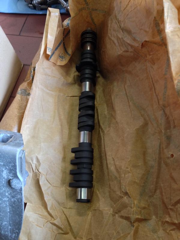

Mahle 3.8ltr slip fit pistons and liners,
Carrillo rods,
Shrick cams,
Gt3 RsR motorsport oil pump,
The rest is all new OEM parts.
By end of tomorrow they reckon the engine will be fully stripped and cleaned.

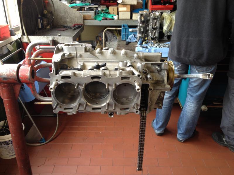

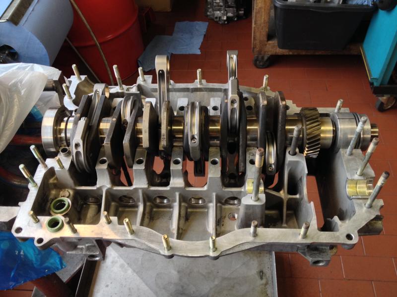

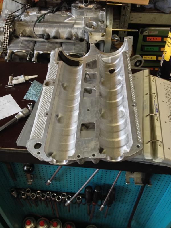

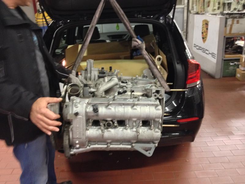

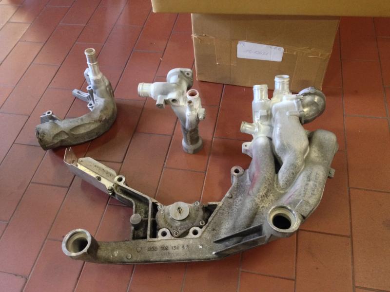

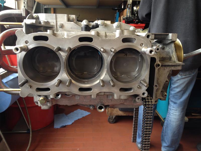

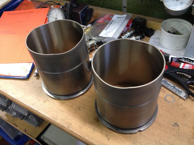

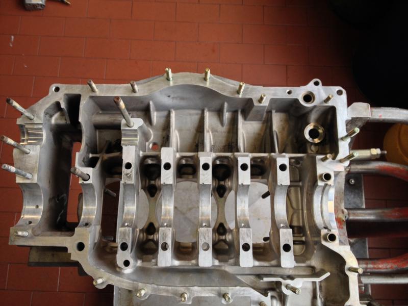

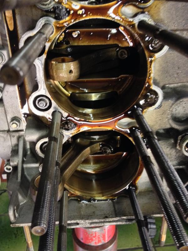

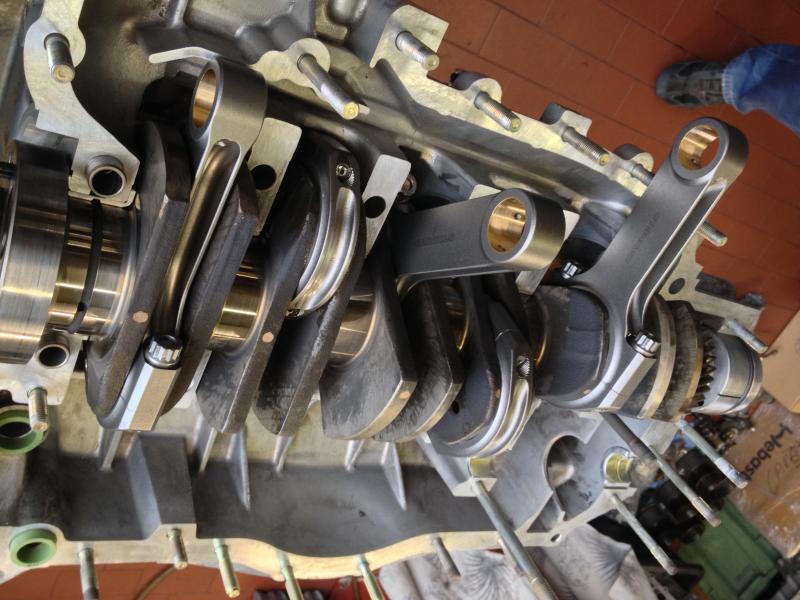

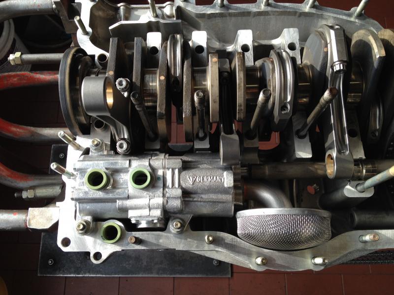

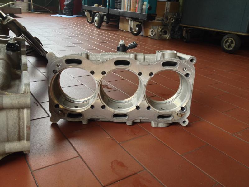

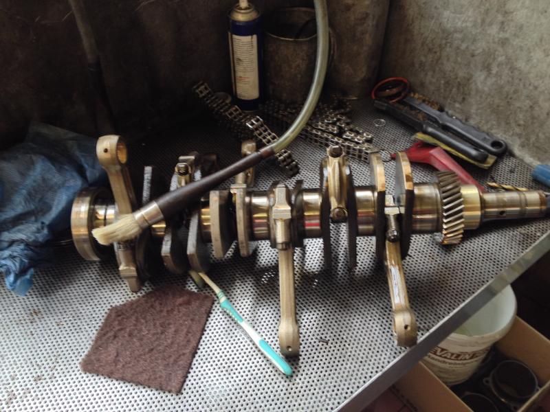

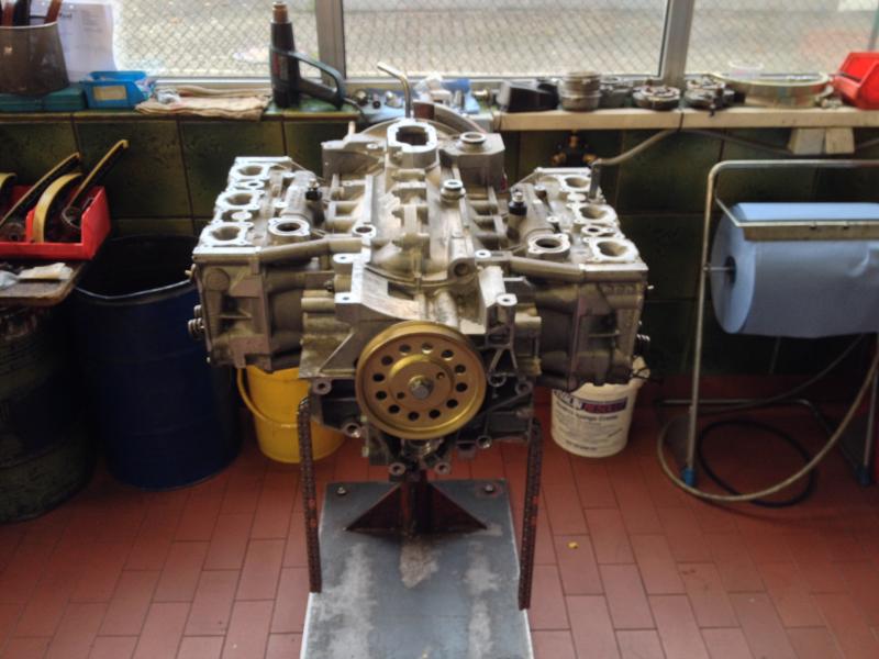

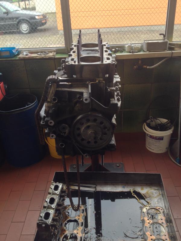

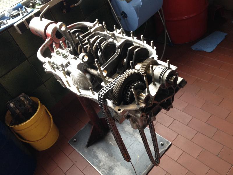

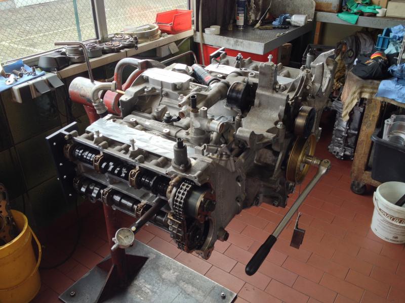

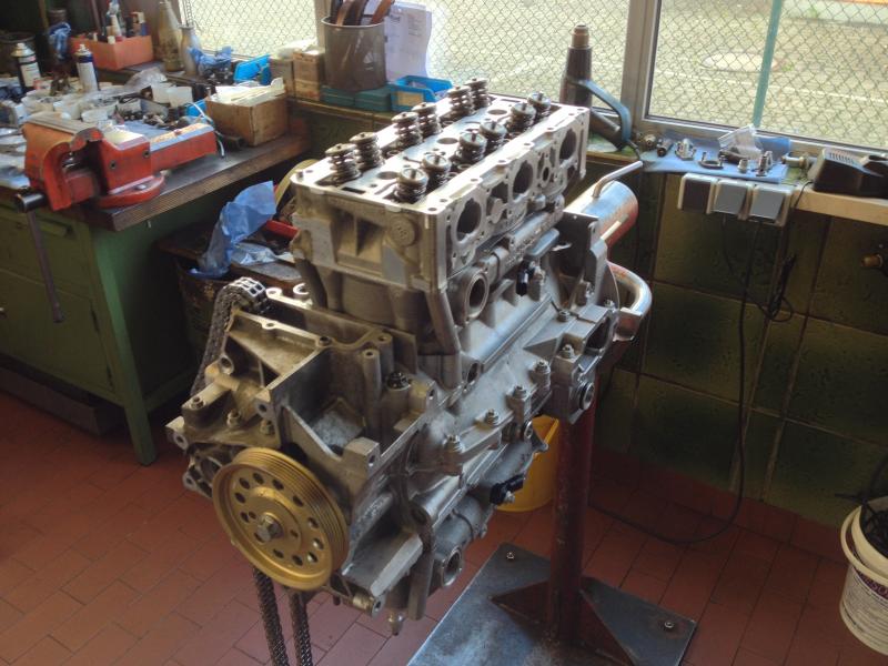

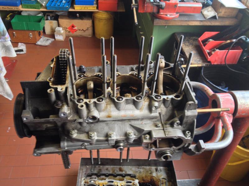

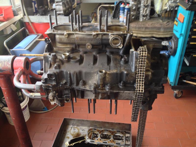

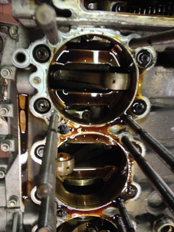

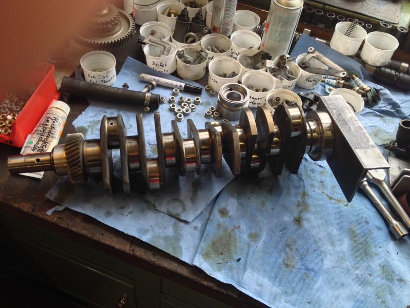

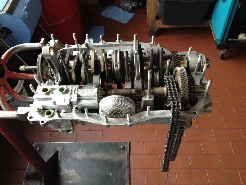

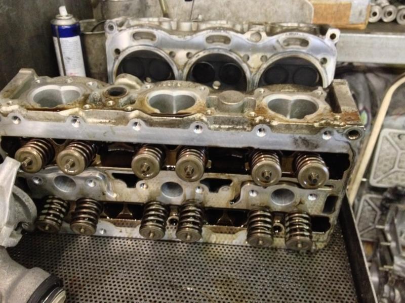

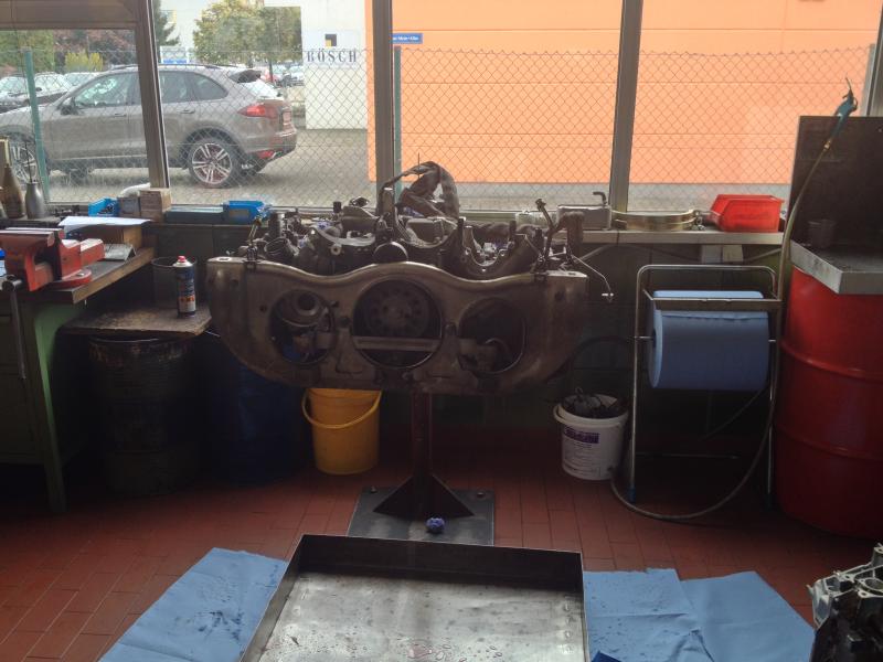

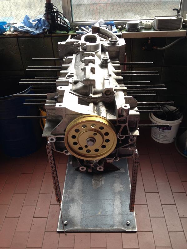

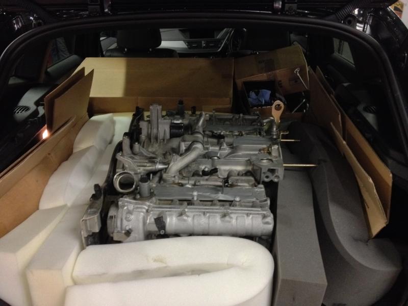

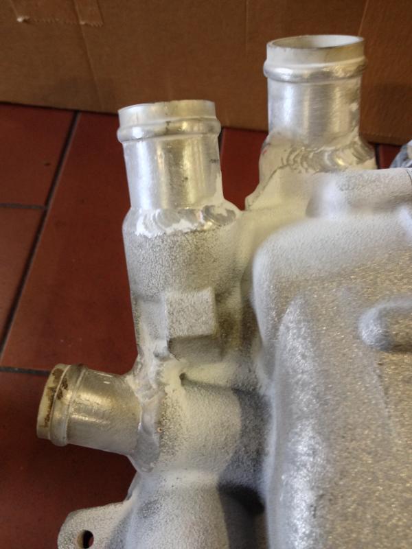

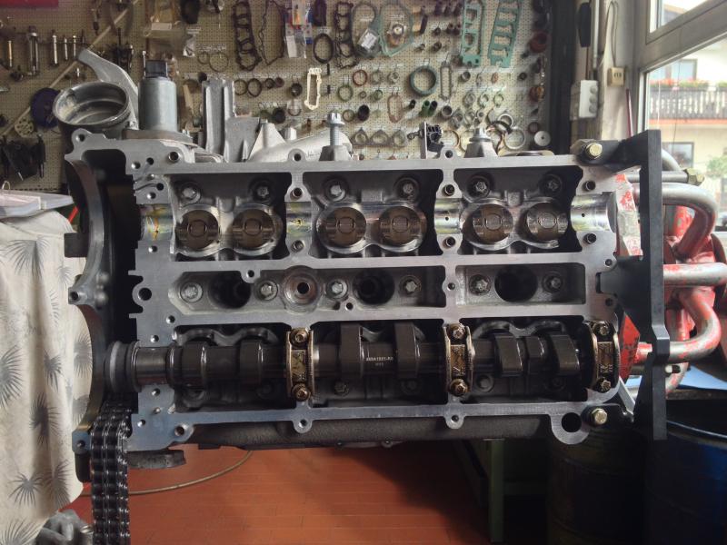

Engine Strip Down and cleaning.
ID:	299320   Click image for larger version
ID:	299321   Click image for larger version
ID:	299322   Click image for larger version
ID:	299323   Click image for larger version
ID:	299325   Click image for larger version
ID:	299326   Click image for larger version
ID:	299327   Click image for larger version
ID:	299328   Click image for larger version
ID:	299330   Click image for larger version

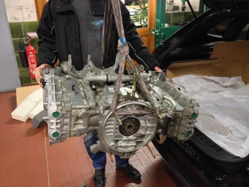

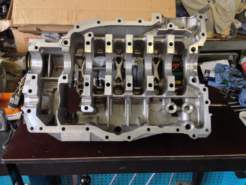

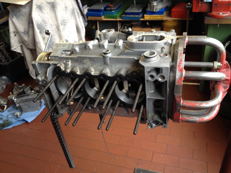

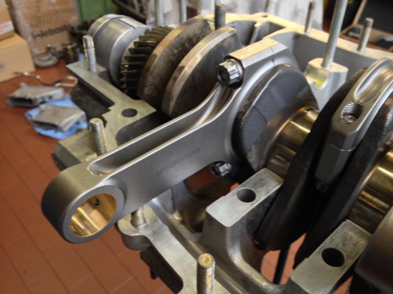

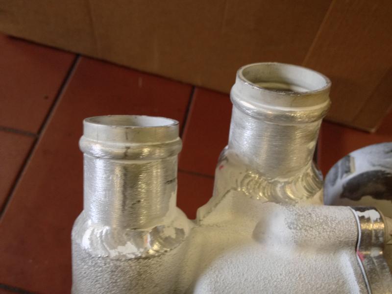

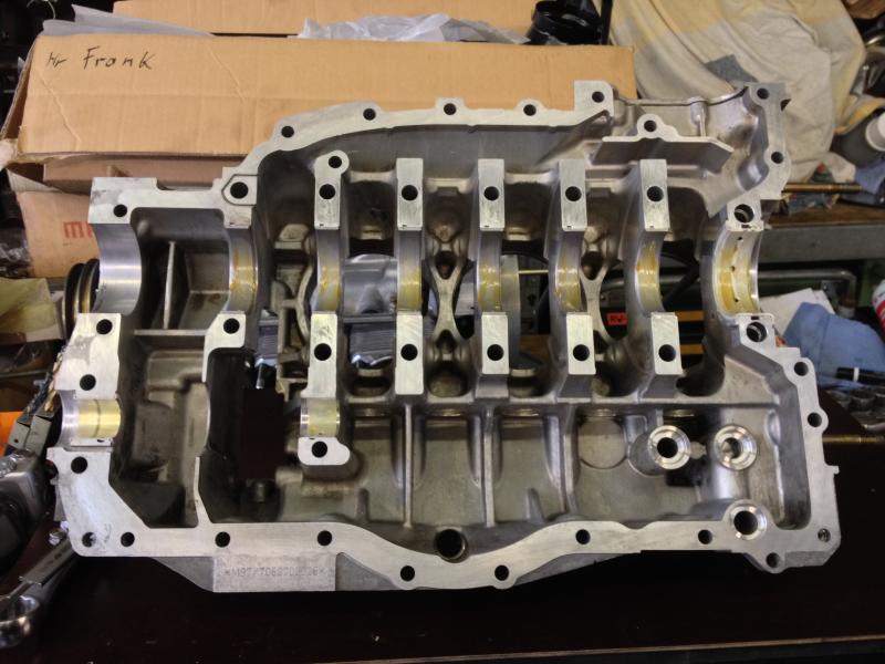

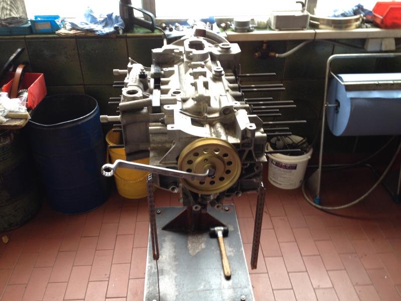

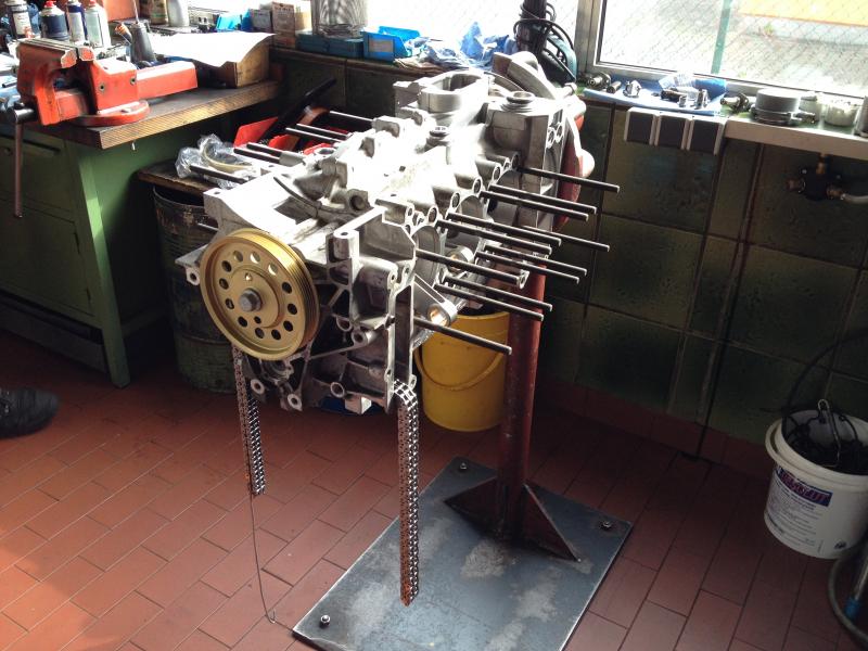

Engine Being Built Back Up!
ID:	299333   Click image for larger version
ID:	299334   Click image for larger version
ID:	299335   Click image for larger version
ID:	299336   Click image for larger version
ID:	299338   Click image for larger version
ID:	299339   Click image for larger version
ID:	299340   Click image for larger version
ID:	299341   Click image for larger version
ID:	299343   Click image for larger version
ID:	299344   Click image for larger version
ID:	299345   Click image for larger version
ID:	299346   Click image for larger version
ID:	299348   Click image for larger version
ID:	299349   Click image for larger version
ID:	299350   Click image for larger version
ID:	299351   Click image for larger version
ID:	299353   Click image for larger version
ID:	299354   Click image for larger version
ID:	299355   Click image for larger version
ID:	299356   Click image for larger version
ID:	299358   Click image for larger version
ID:	299359   Click image for larger version
ID:	299360   Click image for larger version

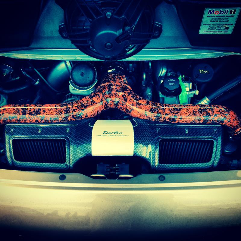

I'm still running it in but here is a vid of me just driving off from a friends house.
It sounds awesome.
And here is a pic of the engine bay.
Old Nov 11, 2013 | 02:13 PM
GTRNICK's Avatar
Joined: Apr 2006
Posts: 1,677
From: London (UK)
Rep Power: 156
GTRNICK Is a GOD !GTRNICK Is a GOD !GTRNICK Is a GOD !GTRNICK Is a GOD !GTRNICK Is a GOD !GTRNICK Is a GOD !GTRNICK Is a GOD !GTRNICK Is a GOD !GTRNICK Is a GOD !GTRNICK Is a GOD !GTRNICK Is a GOD !
I must say the guys at FVD did a great job with the build and worked on the engine solid for me to get it finished in a short space of time.
I had a great time watching them do the build and being able to take pics of the masters at work which I feel very fortunate for.
I just cannot wait to get the car run in and the ECU remapped for full power as it's on a safety map for now.
What I do know is it feels like a different breed now it is so torquey its unreal and it only hits a bar max under load so I can only imagine what it will be like when it is finished off.
