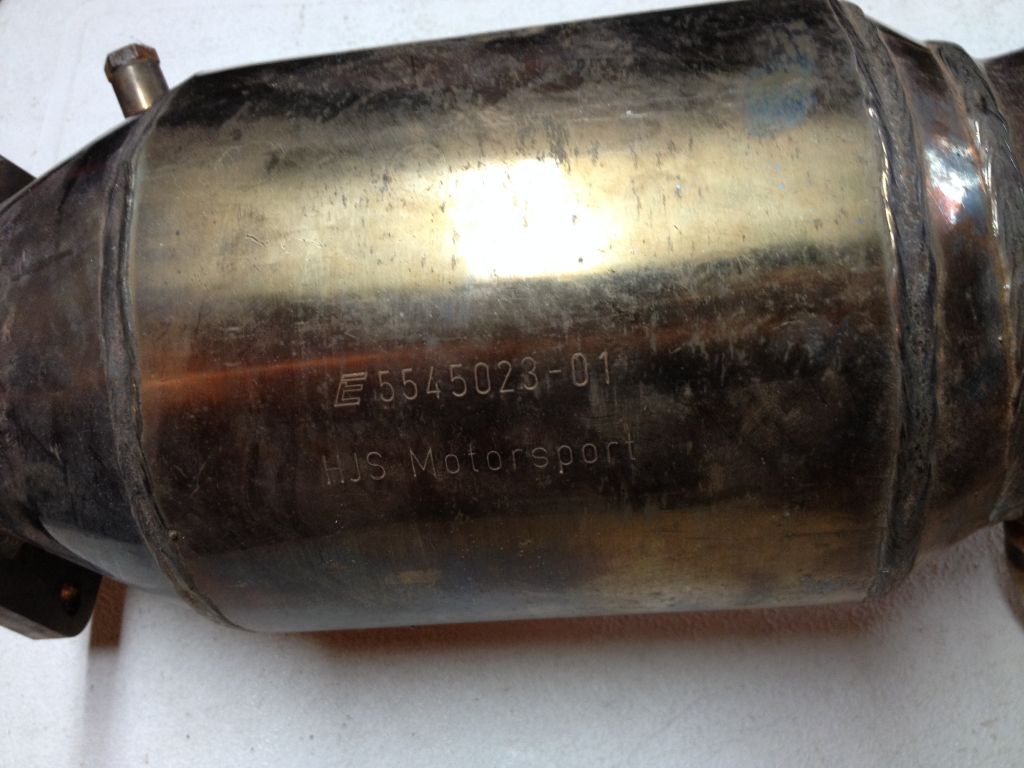

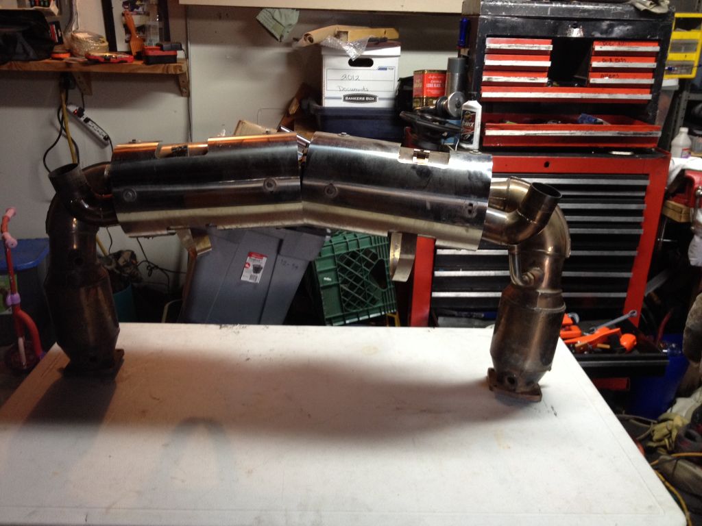

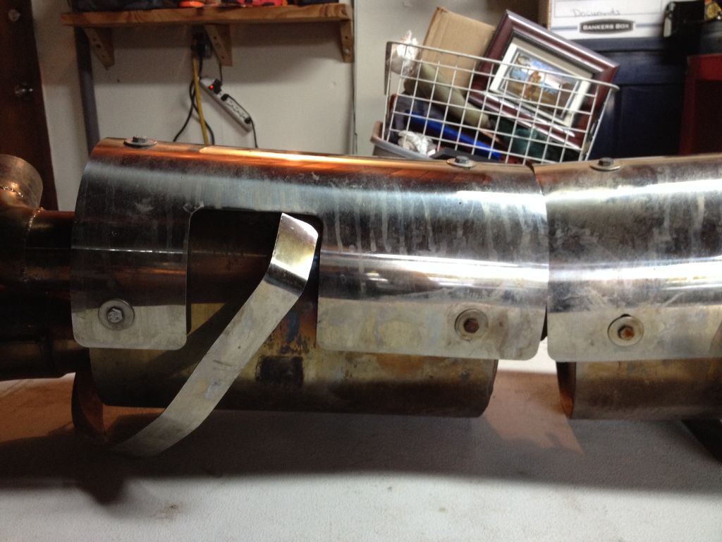

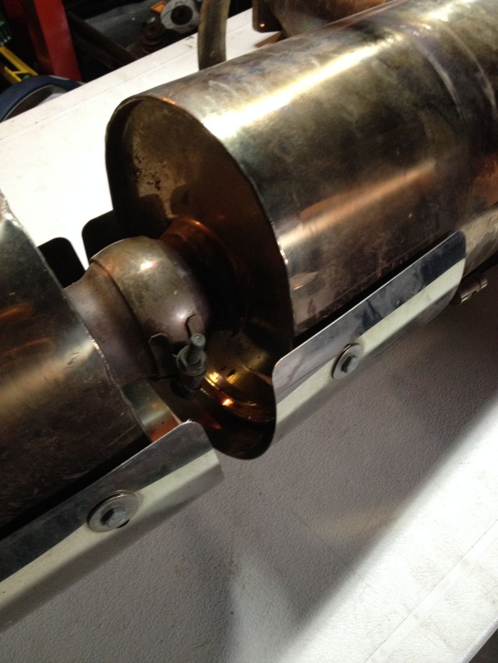

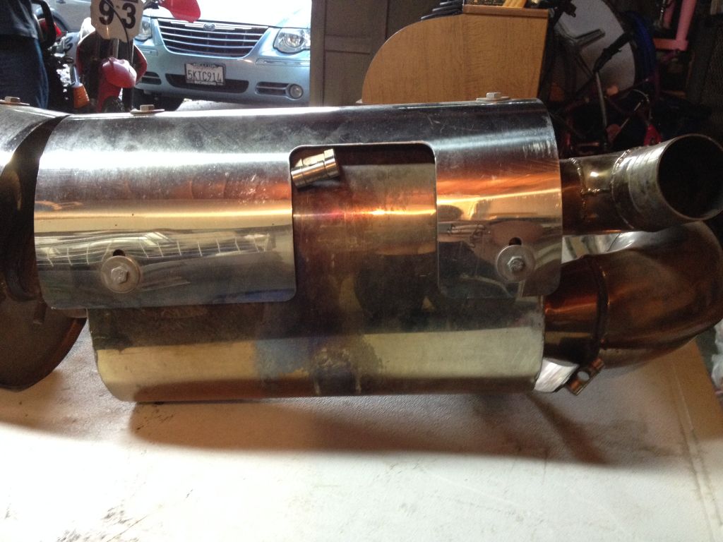

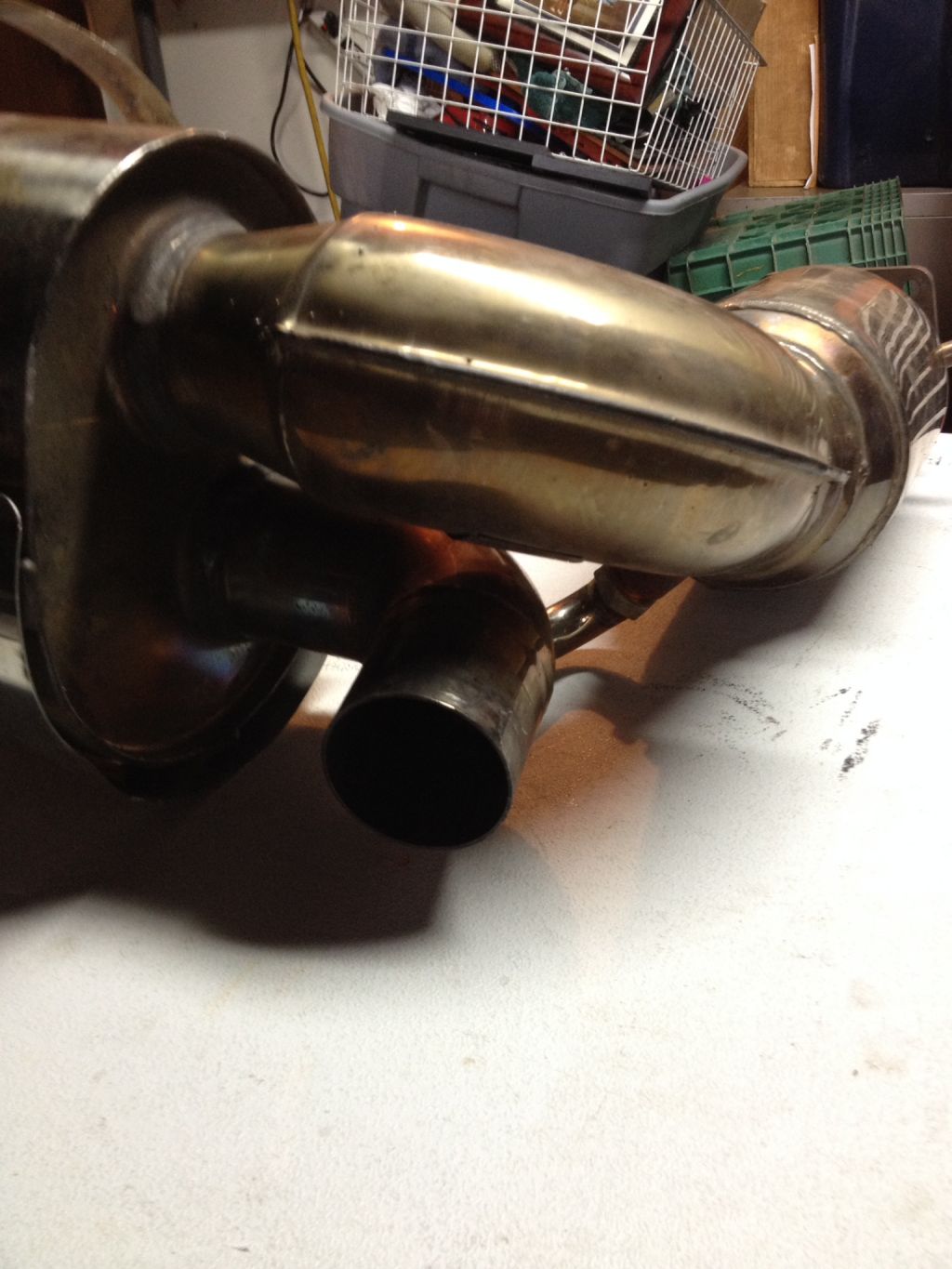

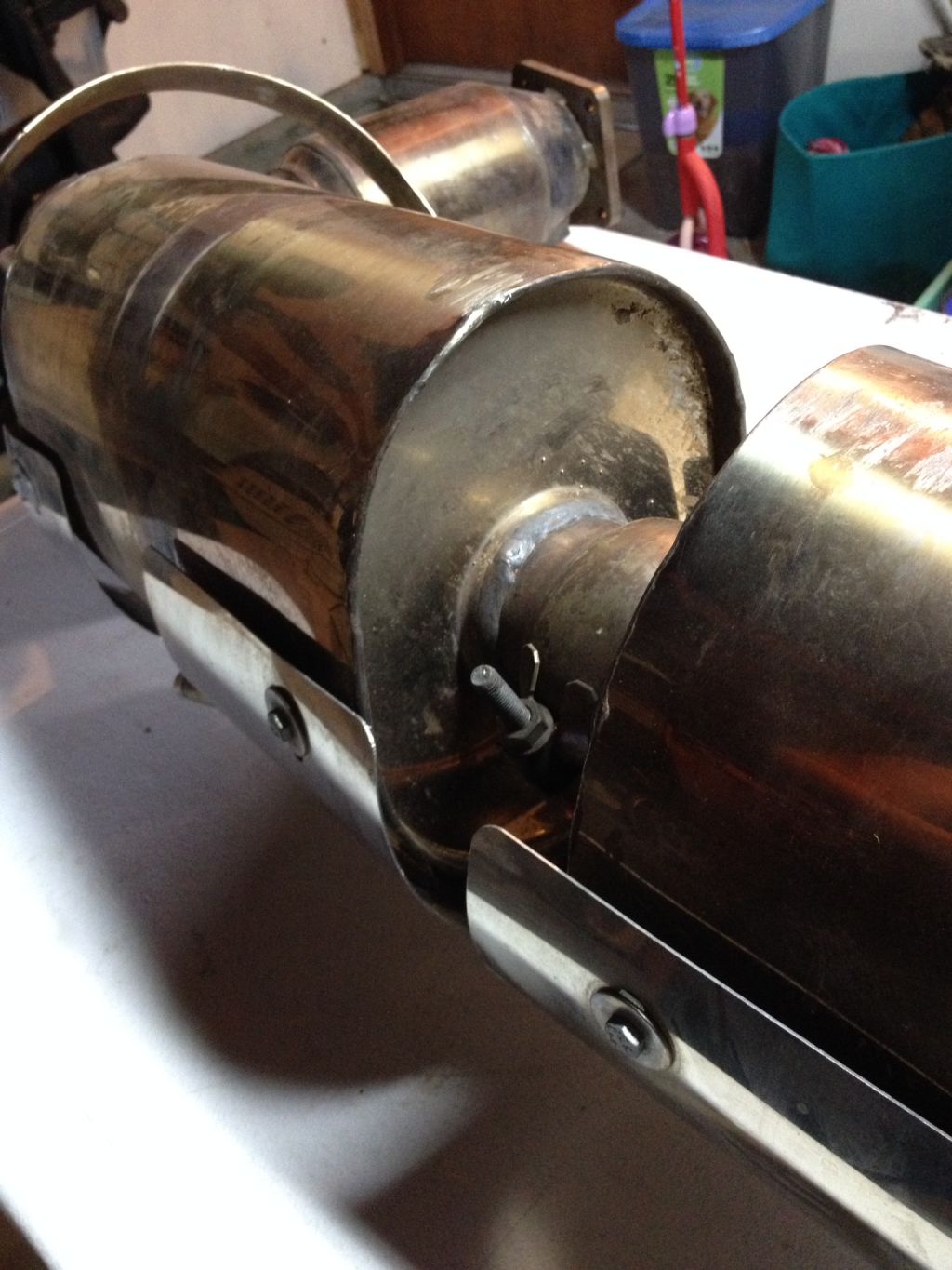

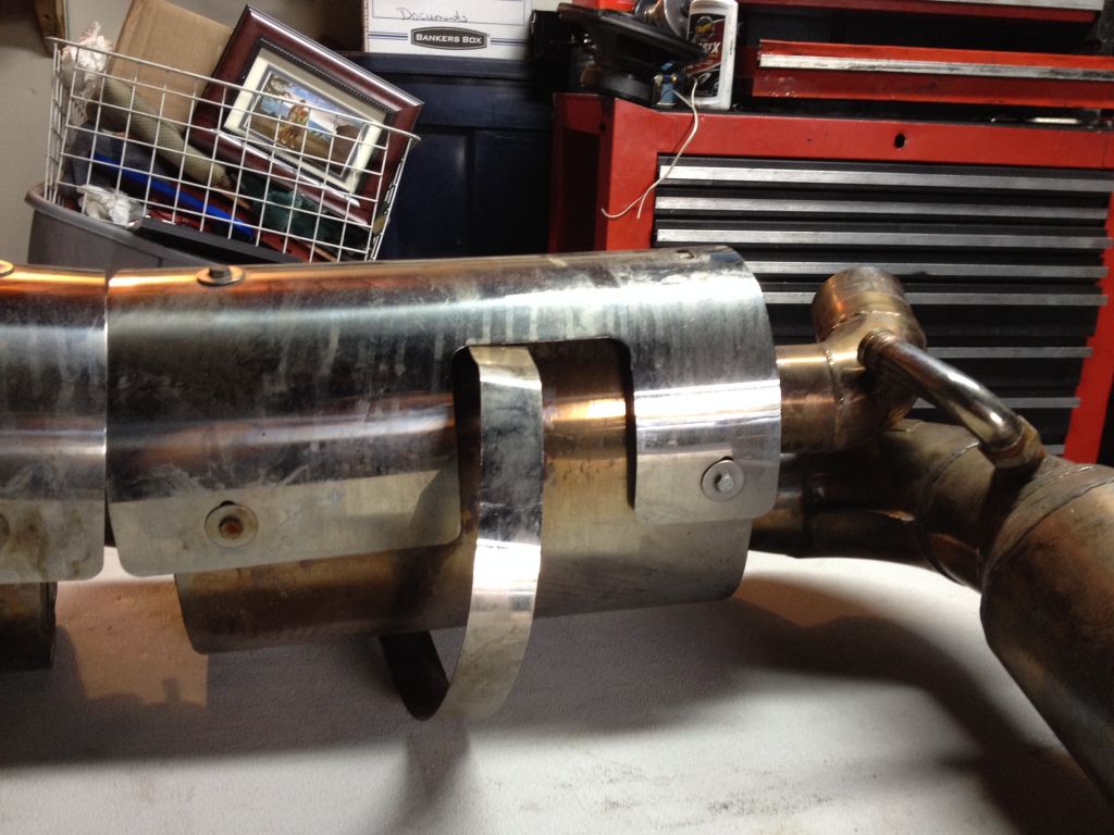

Is this an authentic Cargraphic Exhaust?
My friend just had this installed on this 997TT. He picked it up second hand, but I was almost positive that all the Cargraphic exhausts for the 997 Turbo were stamped with some kind of identification.
Here are some pictures and as you can see, the HJS cats are marked, but no Cargraphic ID on any of the piping or mufflers.
Are there any replicas in rotation right now that he may have gotten tricked into buying or is this the real deal? It looks to be made very well and he says it sounds great now that it's on the car.

Very hard to tell, you can compare it to my Cargraphic exhaust:
https://www.6speedonline.com/forums/...cell-cats.html

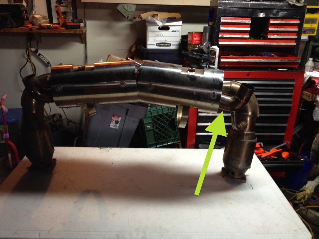

HJS cats are a plus, I guess. Hard to tell why there would be such a long pipe connected to the rear O2 sensor bung, this shouldn't be needed. Cargraphic welds ID plates to the bottom of the mufflers.

I'm pretty sure that one rear bung is an o2 extender to avoid a CEL, but with those HJS Cats I'm not sure why you'd need to do that anyways.
Then again, I don't understand why a knockoff company would use HJS high-quality cats.
I'm just confused at this point as to where those ID plates went if this was an original. I suppose they could have been scraped off by bottoming out or something?
I've just never seen a cheap, Chinese knockoff using this particular design.

BTW, this does look physically like a CG. But... my 5 year old Cargraphic exhaust does not have that long bung extension and has no CEL. It also has a plaque. To best of my knowledge (anyone pls correct as needed), Miltek is another exhaust that is also made in the same England factory and uses identical cat and core (HJS cat, Emitec core) as CG (and Porsche OEM). The Miltek also looks identical to CG and is equal to the quiet version of CG.
Why is there such a bend in the middle at the connecting pipe? It should be straight across.

I think you've solved the problem. Without the ID tags, I'm almost positive this is the Milltek. I'm still not sure why the extender is in place. And only on one side too.

Originally Posted by Chadillac2000

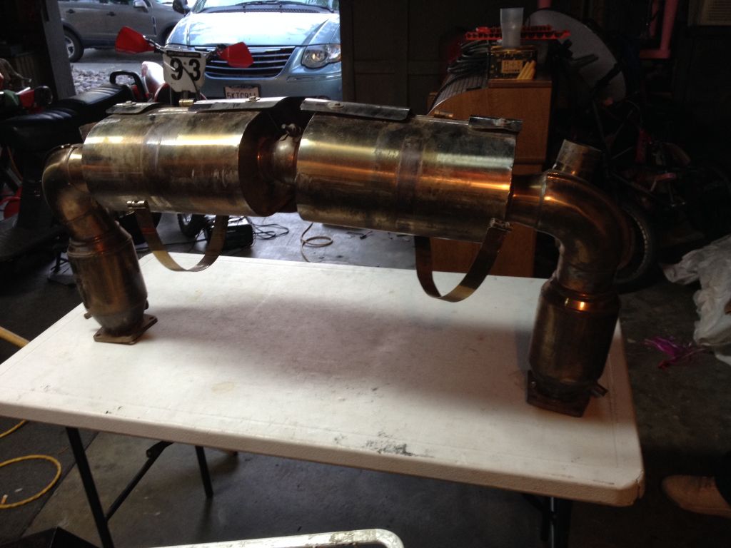

HJS Motorsport cats = 100 cell ( Milltek )
HJS Tuning cats = 200 cell ( Cargraphic )

Yes, what stef said, it's a miltek.

Agreed. I just took a Milltek off for a customer going back to stock that looks identical. Probably listing it up for sale next week.

It looks like a milltek. Phoenix in the uk makes theirs and cargraphic's.

stef@europipe Is a GOD !stef@europipe Is a GOD !stef@europipe Is a GOD !stef@europipe Is a GOD !stef@europipe Is a GOD !stef@europipe Is a GOD !stef@europipe Is a GOD !stef@europipe Is a GOD !stef@europipe Is a GOD !stef@europipe Is a GOD !stef@europipe Is a GOD !
The easiest way to determine whether it is a Milltek or a Cargraphic exhauist is by looking at the endpipes.
On the Cargraphic the endpipes are adjustable and reduced to 54mm - 2 1/8 inch right after the muffler can.
With the Milltek the pipes are fixed and 60mm - 2 3/8 inch.
