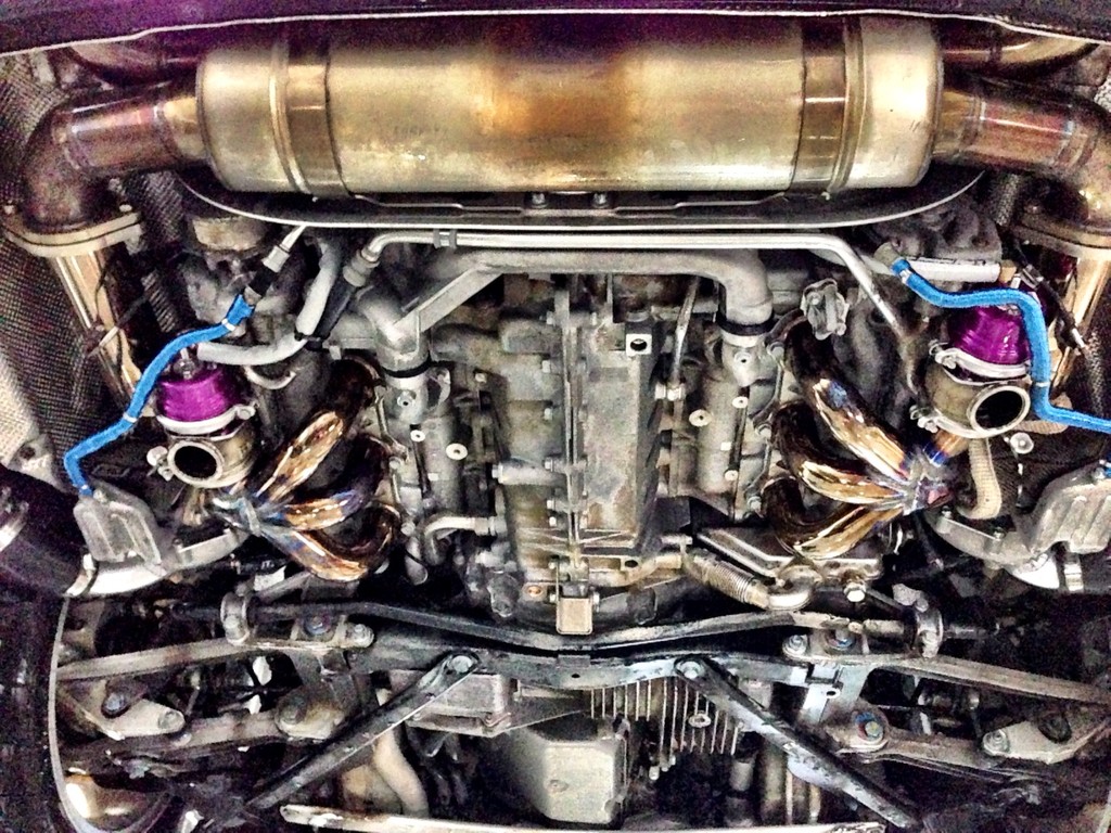

ESMOTOR new Symmetrical Turbo kit release
Hello guys,
I would like to show you our latest turbo kit for 997 Turbo featuring "Symmetrical turbocharger position" and counter rotating turbochargers.
We have equalized the design of the OEM headers. Now, both side headers are exactly same lenght and shape.
This equalization helped us to have better response, which was a problem with big turbochargers and stock engine.
I can say that first tests are promising, estimated power is 850 crank hp @ 1.65 bar boost (24psi)
I will post more information after we finish our full tests because it is snowing here
Here are some pictures;

Hmmm... Look identical to the HKS GT800's I had on my GTR, they where symmetrical too. Made 920whp and the low-end/mid range was insane!

I forgot to mention,
We made some special adapters that these turbos bolt on to the stock water and oil lines.
Yes correct, these are HKS GT800 counter rotating turbos, which we modify the compressor housing.
Low-end/mid range is really amazing.
