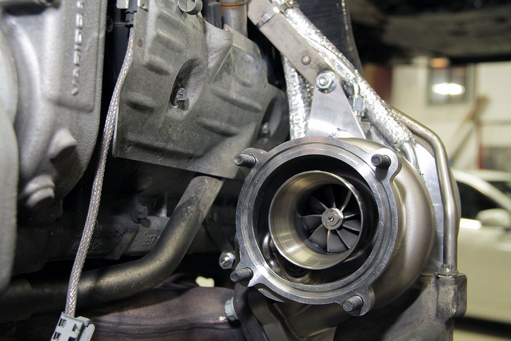

AMS Alpha 9 : A review
AMS Alpha 9: A review
It has been about 9,500 miles / 12 months since having AMS install their Alpha 9 Turbo kit on my 08 Turbo and I wanted to give forum members my (car enthusiast) review of the kit. In short, I can say that I am incredibly pleased with the Alpha 9 kit and the service provided by AMS! The core of their kit are custom Tial Alpha 28 turbos and their AMS intercoolers. Boost is controlled by a Greddy Profec-B mounted in the rear center console.
In 'close-to' stock form I was already impressed with the 997.1 turbo. It only had Milltek exhaust and tune and made a nice amount of power. I've had a few modified higher horsepower cars in the past and approximately 6 months after purchasing my car I started to get the itch for more power/torque. My goals for the car were power/torque to about 6xx whp/wtq while still maintaining OEM drivability and sensibilities (minimal change in turbo lag, no crazy loud exhaust, no ECU hiccups, etc.). The car’s primary use is street driving, but I am scheduled for my few DE events this year with the car.
This car was one of the first to have their Alpha 9 kit installed. As I understand, it was also used as the car to document the installation of the Alpha 9 kit for their dealers. In addition to the install of Alpha 9 kit, I also had the Sachs 2.5 clutch installed, GT2 Slave conversion, and welded coolant fittings done by AMS.
Timeline: Total -16 weeks – If I remember correctly, it was supposed to be a 4 week turnaround for the car. However, there were a few issues along the way, not all were issues from AMS. This wasn’t the first time I’ve had a delays with modded cars, so I wasn’t surprised, even if it was mostly for bolt-ons. I will let AMS chime in on this as now I’m sure they have a smoother timeline for doing the install.
Intercooler delay – 3 weeks - AMS was not happy with the initial castings for the end tanks for their intercoolers. The arrived the same time my car was received by them. They contacted me immediately to notify me that there would be a delay to recast the endtanks.
Exhaust issues – 7 weeks – There were multiple complications (my fault- in many ways) with what exhaust I initially wanted on the car and what eventually wound up going on the car. For the sake of brevity, let me say that I should’ve just listened to AMS from the beginning and gone with their suggested exhaust for the kit (AWE).
Dyno broke - 2 weeks– their dyno broke down and stalled the tuning of the car for a few weeks.
Results - This car essentially has 200+ more whp/wtq on tap everywhere along the rpm range when in boost. Power band is very favorable, and moves to the right every so slightly (see pre/post dyno sheets). The torque curve on this car is incredible. There is a LOT of power under the curve, it is not a peaky high power setup. It is a blast to drive!!! The Sachs clutch/Slave conversion requires significantly more pedal pressure, but produces a more repeatable pedal position to engage the clutch and modulate engagment. The exhaust note is ehh.... It helps the Alpha 9 kit make the good power and obviously flows well. Better and more aggressive sounding than my old Milltek, but I’d still like something with a deeper tone.

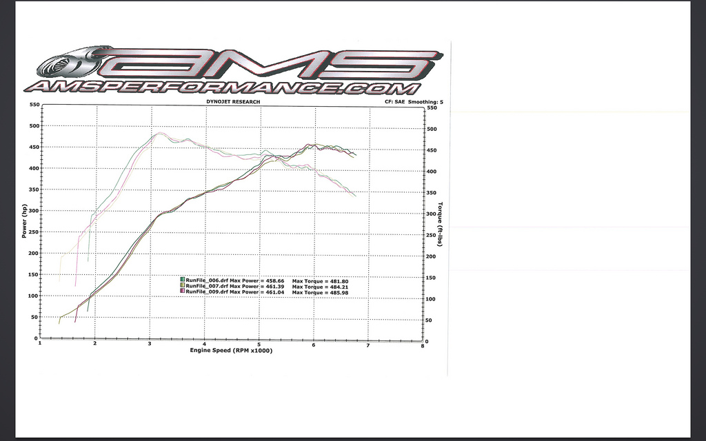

PRE Alpha 9 Dyno (Dynojet) 93 Octane (461 whp/485 wtq) – previously tuned w/ Miltek exhaust.

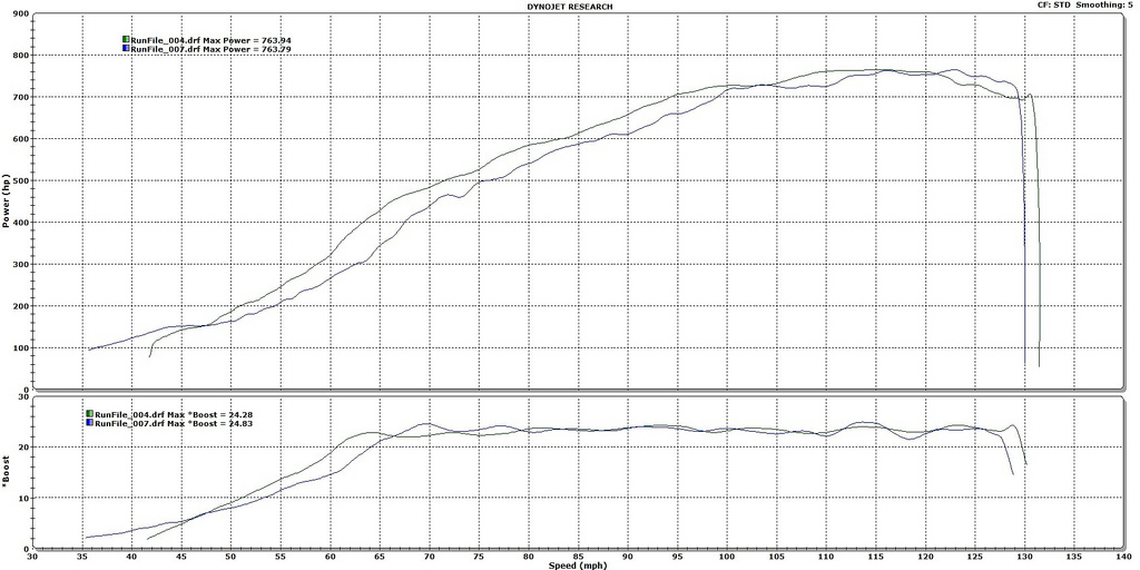

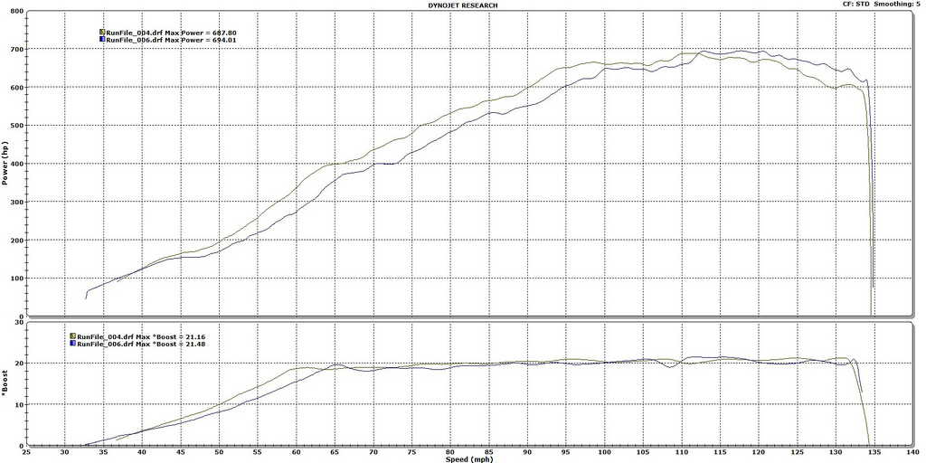

The car was tuned for both 93 octane ( 687whp / 661 wtq) ) and Shell URT Advanced (763 whp / 695 wtq). AMS did say that they did want to see the car back at some point to follow up. A few months after I received my car back, AMS notified me they had made some adjustments to the intial tune (with EPL) and were also tuning with MS 109 instead of URT Advanced due to race gas availability. Because of my distance I did not initially feel the need to send the car back, as I was pretty happy with the car and the power it was making.
About 4 months ago, I had an issue with my clutch (slave conversion issues) that I was going to have serviced by my local performance shop with some suspension work, I notified AMS and they asked to see the car back. We worked out a fair agreement to ship the car and they performed the clutch service and upgraded the tune at no charge. The car came back with slight bump in power and felt even smoother in power delivery.
Alpha 9 - 93 Octane 1st tune (They dialed back the tune to 687 whp)
Alpha 9 - URT Advanced
I was hoping to get a 60-130 time, but no P-Box was under the tree this Christmas. ☹
AMS has documented a 60-130 on 93 octane in my car here. This was before the car went back to refine the tune. I know that many will want to see 60-130 on full kill, so I will try my best to see this happens on race gas in due time.
Alpha 9 - 93 Octane (693 whp) - 2nd tune
Alpha 9 - MS109
AMS Service – I wrote this review really to just let other forum members know about the Alpha 9 and the excellent customer service I received from AMS.
I must compliment AMS on the high level of customer service and attention to detail regarding the work they’ve performed. Anybody on this forum is a car enthusiast to some degree. So most can appreciate that it took a lot for me to trust AMS to perform the work on my car 1000+ miles away. I appreciated the constant communication from my AMS Rep (Larry H.), I was literally updated weekly – car’s arrival, pre dyno, engine out, install pics, post dyno, delivery, etc. Even after the delivery I would periodically still get email followups from AMS regarding the car. Thanks again AMS for making a great product. I will be enjoying this car for many many boosted miles!
