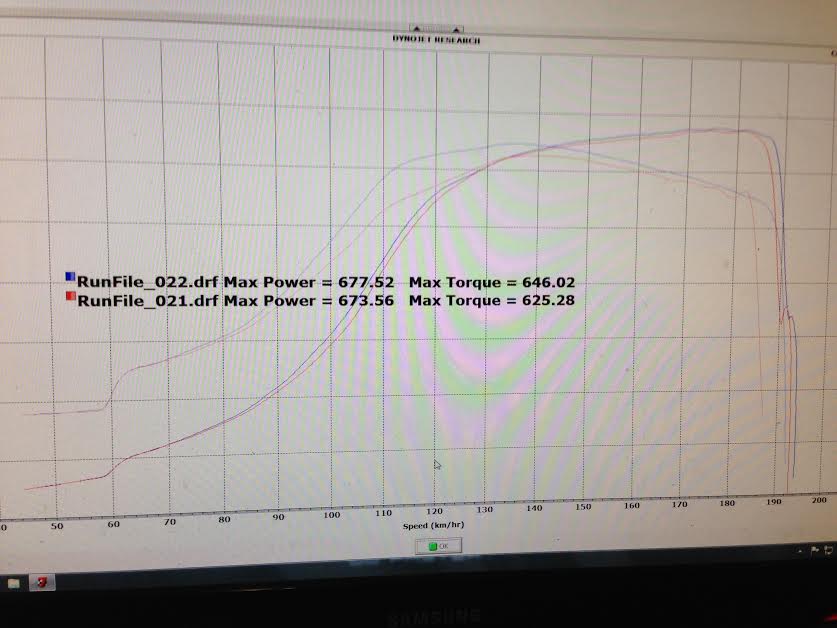

Topspeed Motorsports E85 tune with Proto 63.5 VTG's, Kline 2.5" exhaust (200 cell cats), and TSM 1150 injectors.
It spun on the first run, so had to have someone sit on the bumper for the second run.
I'm anxious to see what they'll have to do to mine then, I'll be at about 1000whp lol
