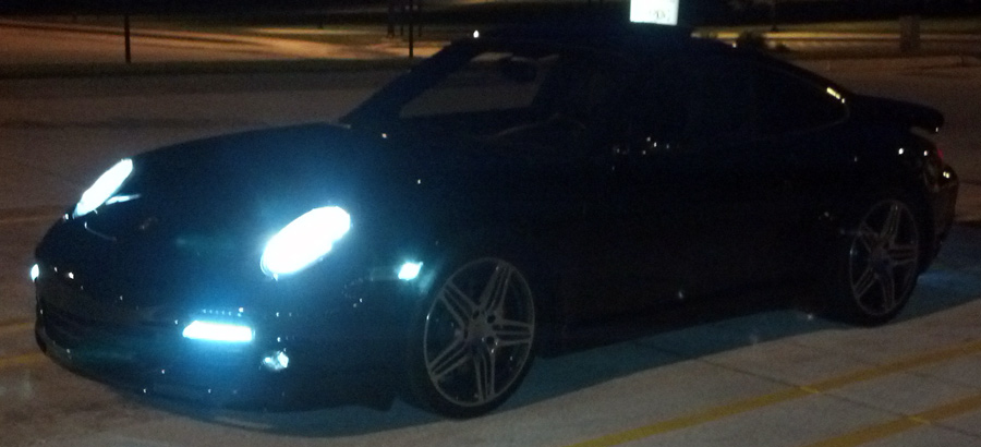

GTRNICK:
Do you have a picture of your .2 Fog Lamps at night head-on?. The replacement LED bulbs I have in are balanced quite nicely (color temperature) with the headlights. However, they really do not throw out much real usable light...they seem more cosmetic. The stock halogens were noticeable when turning on while night driving from inside the car. The LED's not so much. Not sure if its just because the DRL's are so bright that they might just be over powering the fogs?
Thoughts?

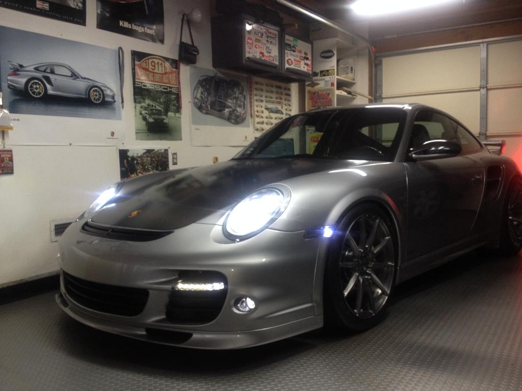

I just did the led bulb swap fogs very reasonable probably at least a year ago & used the Usps ones there sponsor here & have been fine so far also the Vivid DRL about couple years old no problems ,led side markers from Usps where the easiest to do ,Dectane rear Leds off Ebay at least 2 to 3 yrs ago no problems either & just did the 997.2 headlight conversion.To be honest i forget to turn on the fogs most of the time.

Originally Posted by therock88
Sure...Not the best photo but you get the idea. The bulb is H3, you get the LED and you need to reverse the polarity....they fit the same other than that.
Check this thread on this site:
https://www.6speedonline.com/forums/...available.html
How did you get the led strip and bottom fog to be on at the same time ? on my 997.2 if i turn the FOGs on the DRL LED turn off.
Old Feb 17, 2014 | 05:43 AM
  #41
therock88's Avatar
Joined: Feb 2010
Posts: 1,330
From: Pleasantville!
Rep Power: 167
therock88 Is a GOD !therock88 Is a GOD !therock88 Is a GOD !therock88 Is a GOD !therock88 Is a GOD !therock88 Is a GOD !therock88 Is a GOD !therock88 Is a GOD !therock88 Is a GOD !therock88 Is a GOD !therock88 Is a GOD !
Hi,
Not sure who installed yours? The DRL's should be wired to an ignition activated power source, unrelated to the fogs, or any other lights. Perhaps they were somehow wired to engage with the fog's?
It is pretty straightforward, so if you have the issue, perhaps see if that happened? The blinker/DRL strip has one harness to act a a blinker (normally), and and additional wire for DRL, that keeps the white LED's on while the car is on. Again, totally separate from anything on the fog light (unless it was wired that way).
Hope this helps...
DC
