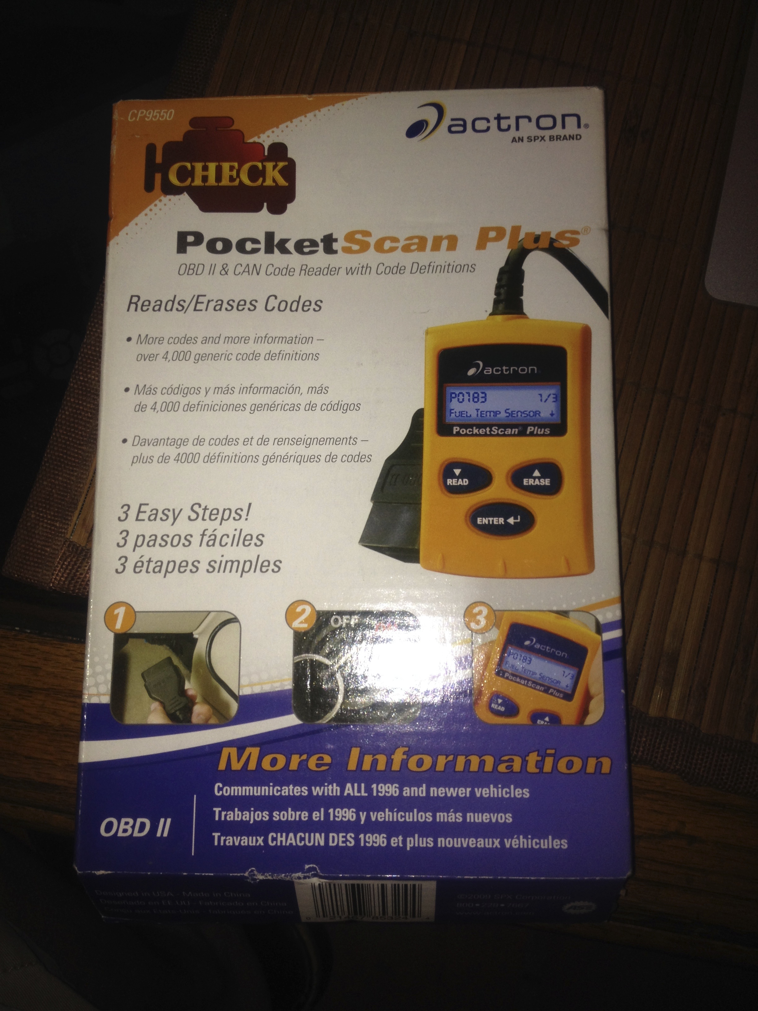

At least it's not the dreaded p0021 cam sensor issue , my cheapy obd reader from Pep Boys $75 tells you what the actual codes are ,not just the code # & can reset them .
You have a link for that reader?
Rep points to you! Thanks for the tip.

Here you go i got it from Pepboys reads actual codes & resets them ,plugs into OBD $75.00
