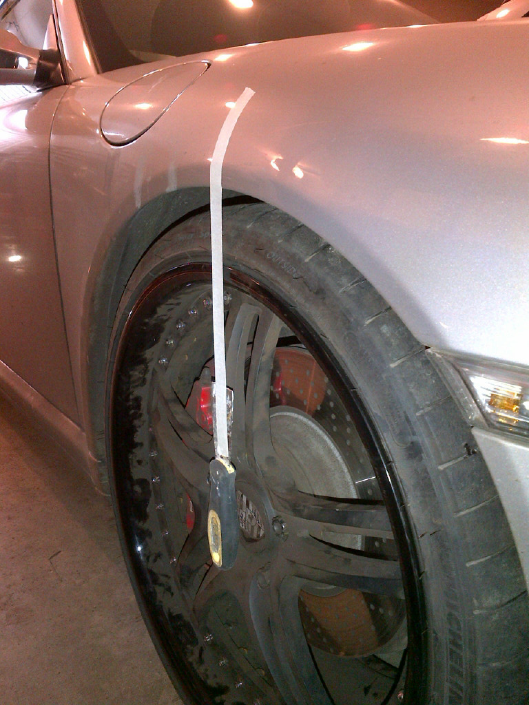

9.5" has worked for some people, BUT you'll need offset to be bang on. Probability is that the Pano wheel's offset isn't right.
I wanted to go 9.5" for track rims with 255 tires, but didn't want to gamble getting custom 18" rims wrong.
I've got 20 x 8.5" fronts w/ 245/30 MPSS. GMG Eibach lowered. I measured a +48mm offset on the wheel. The outer rim is 10mm from the outside edge of the fender. The inner rim is 28mm from the shock.
pix for perspective....ya they're dirty....only pulled off the rack to measure.

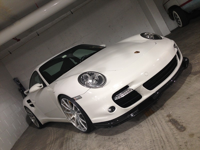

I run 20X9 front and 20X12 rear.
