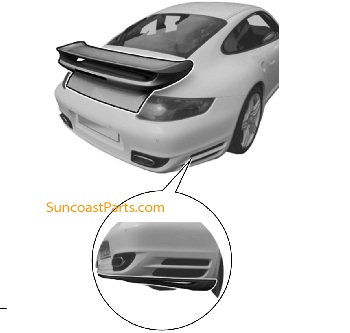

According to the tequipment catalog, the aerokit does indeed contain a rear valence/diffuser unique to the aerokit.
Personally, if I had a factory aerokit, I'd leave it alone and not mix and match a bunch of aftermarket parts. Although, some of the champion stuff looks great.
