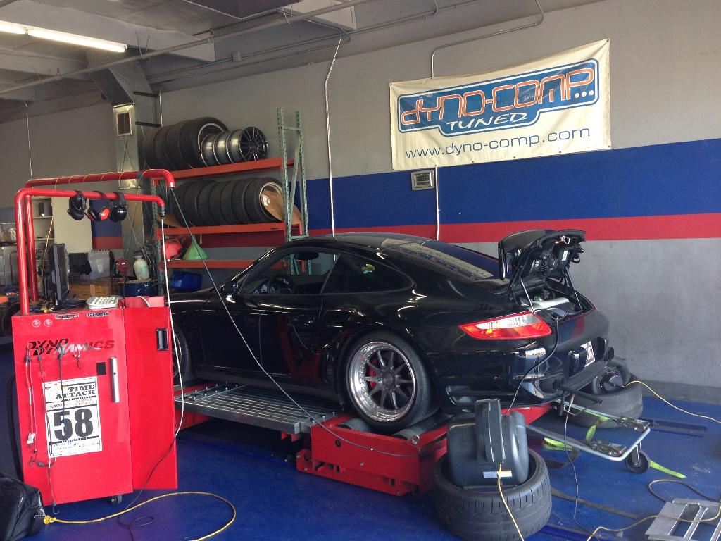

After leaving DynoComp with a 100 tune, I decided to take it over to Robert (interrupting his personal and family time to deal with my car), I asked him to give me his input on the 775. Let me summarize and say he was impressed; however, I won't elaborate on the details in this thread.

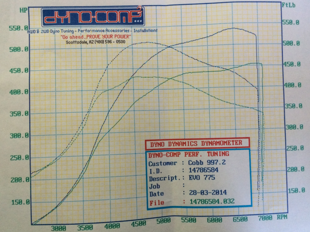

The Heartbreaker:
Lower graph is 91 tune
Upper graph is 100 tune

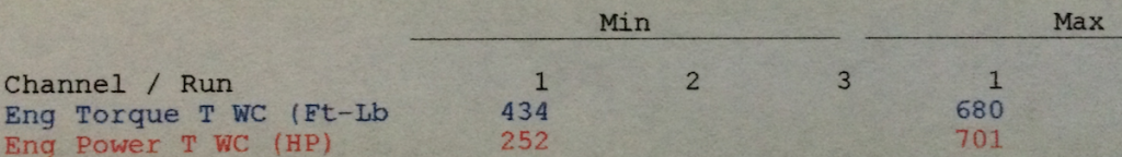

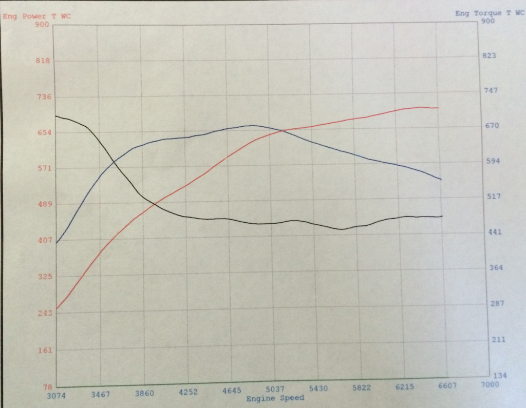

The LifeSaver (nothing was changed or modified, just ran the 100 tune on a different dyno):
If we do a bit of math:
DynoComp shows ~525ftlbs and ~540hp on 100
FAT hows ~701ftlbs and ~680hp on 100
A whopping 176ftlbs and 140hp difference between dynos.
Not that *ALL* of the tuning was done on Richard's dyno @ dynocomp. These is absolutely nothing wrong with it. It works perfectly, it's calibrated perfectly, and I've watched Richard tune many cars with spectacular results. I'd be comfortable to sit in any car that's been tuned on his dyno and watch it stomp on cars claiming the same power somewhere else.
DynoComp shows ~430ftlbs and ~455hp on 91

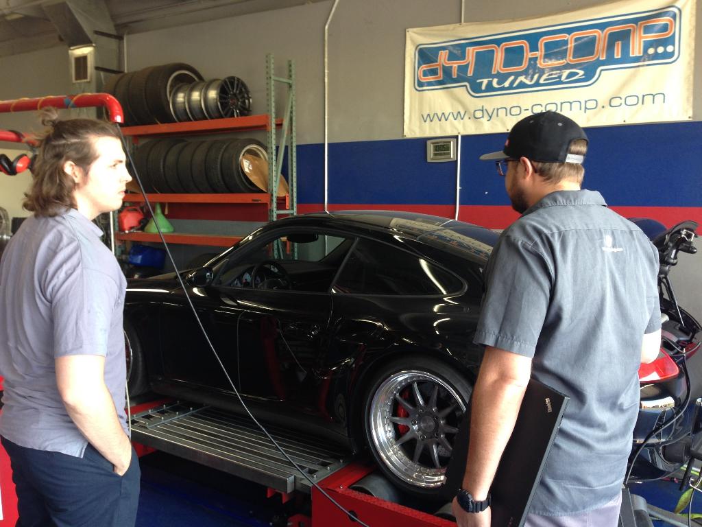

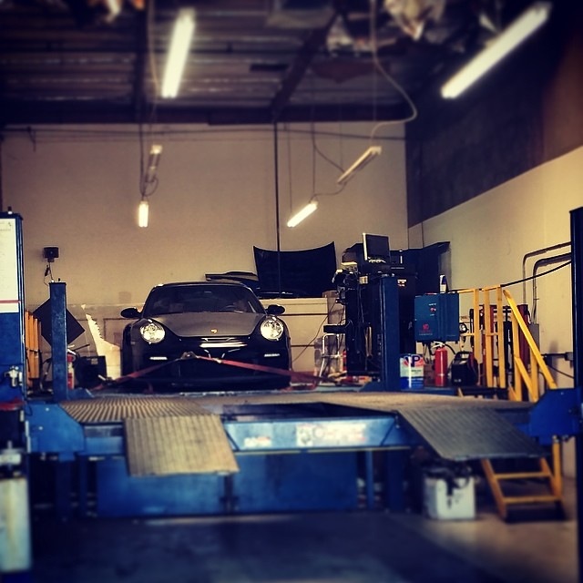

Mitch (right) educating me:
Seat time:

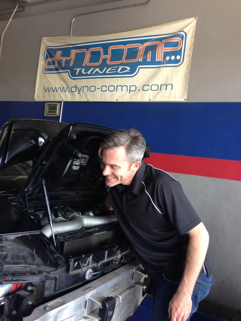

Reference line popped off FPR. Tim digging in. Where were the zip ties???
The FAT Dyno for comparison:
