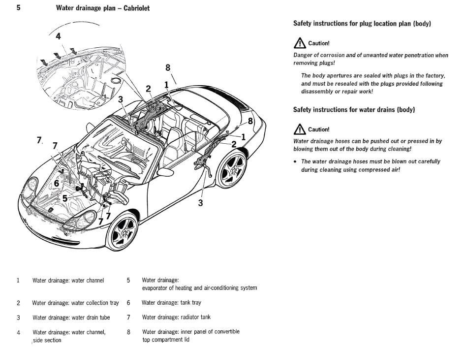

Old Apr 2, 2014 | 11:01 AM
therock88's Avatar
Joined: Feb 2010
Posts: 1,330
From: Pleasantville!
Rep Power: 167
therock88 Is a GOD !therock88 Is a GOD !therock88 Is a GOD !therock88 Is a GOD !therock88 Is a GOD !therock88 Is a GOD !therock88 Is a GOD !therock88 Is a GOD !therock88 Is a GOD !therock88 Is a GOD !therock88 Is a GOD !
Jako...
See if this helps any??
For the 997, porsche devised a system of drip trays which run against the inner walls of the car, down into a 15mm x 250mmx400mm tray behind the driver and passenger seats (below the carpet insulation) and out a set of narrow drain tubes into a cavity between the body and the plastic inner fender. Silt and other road grime accumulates in a "cake" about 1 inch x 7 inches in this space and can get thicker and thicker as silt deposits.
or maybe this for 996?
DC
Old Apr 2, 2014 | 11:20 AM
Jako's Avatar
Joined: Nov 2009
Posts: 629
From: North Vancouver
Rep Power: 49
Jako is a splendid one to beholdJako is a splendid one to beholdJako is a splendid one to beholdJako is a splendid one to beholdJako is a splendid one to beholdJako is a splendid one to beholdJako is a splendid one to behold
Hey Thanks! The problem with schematics is that is hard to interpret. This channel that you are referring to. Is it the one which is accessed through the rear wheel inner wheel lining?
Old Apr 2, 2014 | 05:48 PM
therock88's Avatar
Joined: Feb 2010
Posts: 1,330
Rep Power: 167
Yeah...Agreed. I think that is the one. I had these references from previous cars. Do not have any better pics or more specifics..but at least that gets you in the ballpark of where to look...
Good luck,
DC
