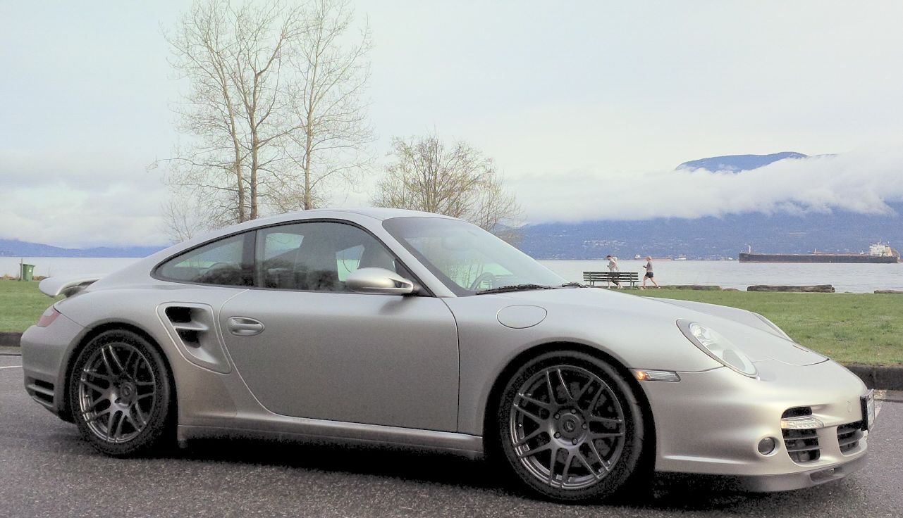

I picked up some new wheels for DE’s and autox. While I haven’t hit the track yet, I’m pretty pleased with how they’ve turned out so far.
Wheels are 18" Forgestar F14. Tires are Toyo R888 in 255/35 & 335/30.

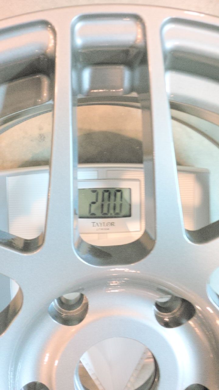

Fronts are 18x9.0 @ 50mm – 20.0 lb

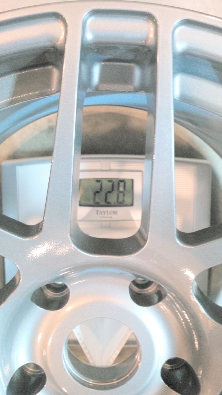

Rears are 18x12 @ 48mm – 22.8 lb

Sorry for the crappy resolution. The 18’s and the thick sidewalls give it a bit of old school look.
<O</O
For those that like the details….
<O</O
The (10” overall width) wheels and the (10.2” overall width) tires are essentially flush with the top of the front fender. This has a nice and wide front track for the DE’s, but if I was doing street wheels I’d back off the offset a few mm. In the rear, the (13.3” overall width) tires are essentially flush with the fender (the rear wheels are 13” overall).
<O</O
I just drove a little to scrub the tires. Lock to lock turning is fine and no rubbing. The stick at this early stage seems pretty nice! I hope to hit DE and autox around the end of the month, so I’ll share some more impressions then.
