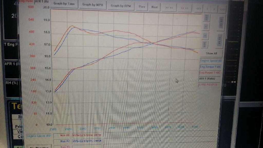

IPD Plenum Install, Dyno Numbers
Install the Plenum and put the car on the Dyno, looks like it need a retune to get the peak HP up, but good midrange power (25whp & 34 wtq)

This is a 997.2 Turbo on 91oct

Nice. How does the butt dyno feel? It gets better and the car responds faster as the ECU adapts.

Very nice! My dyno stock vs plenum showed very similar results.
Unfortunately you need a tune to unlock the plenum's full potential because the stock ECU includes measures to limit torque in the upper RPM range which is why you see the torque curves converging above 5K.
It would be a good test to see dyno's of a tuned car and then once the IPD plenum is added to see how much is adds to the upper RPMs.
My car have Softronics tune before the plenum, but eather way softronics dont have a tune for a plenum

That anybody know if there some tune that work with this mod? I read that GIAC tune work with this plenum... Any dyno to see this??? I believe this mod is not that good if the ECU can't adjust to it.
