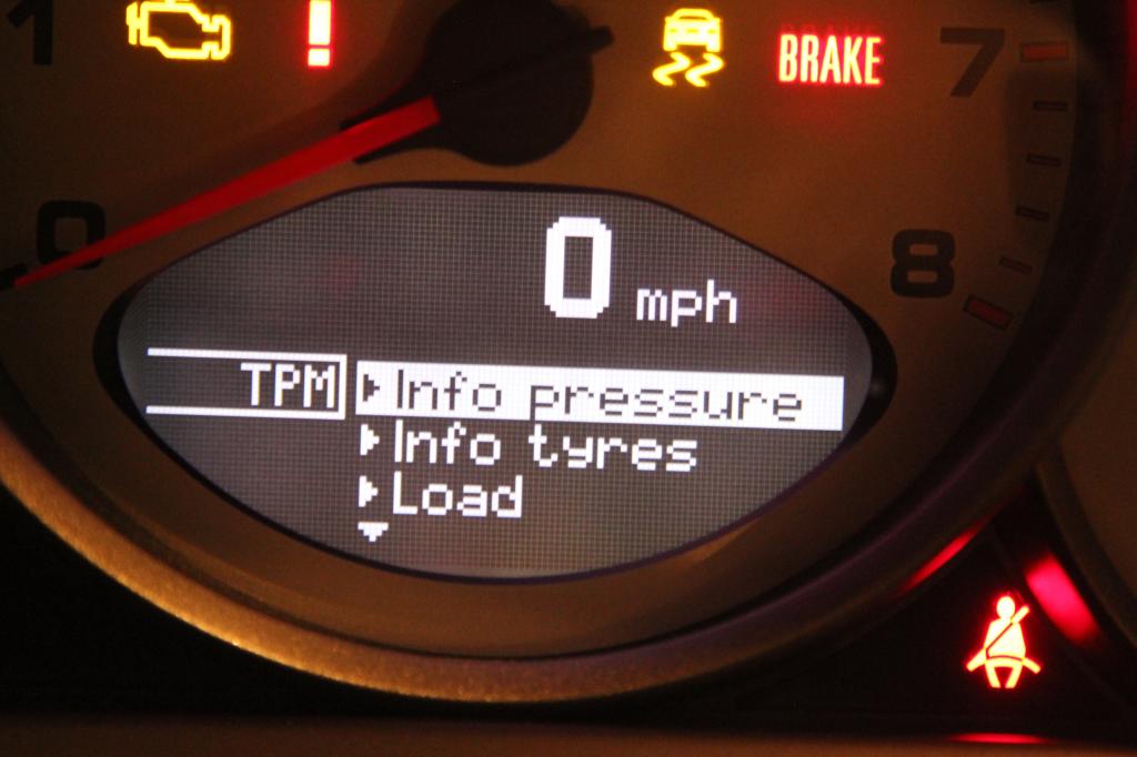

I figured I would share this quick simple tip on setting the optimal tire pressure for our 997.2 Turbo/(S). Quick background, Porsche engineers designed the TPMS in their cars to be so sophisticated that it can be optimized for both the type of tire and the cabin weight! Once selected, the TPMS determines the optimal tire pressure based on a pre-calibrated ambient temperature (I am told this is 68 degrees F/20 degrees C). The TPMS then adjusts continually as you drive and temps change.
Using the lower left hand stalk, delve into the menu and select "TPM" (car should be turned off but ignition in the "on" position where the dashboard lights are on). You should see a few selection options (i.e., Info Pressure, Info tyres, Load, etc).

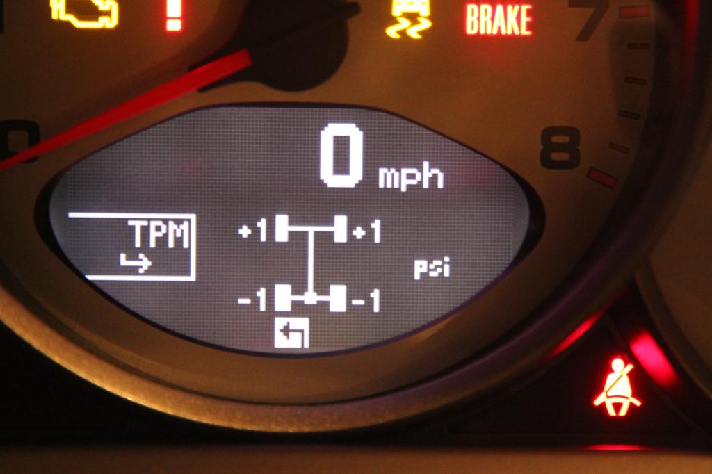

Info Pressure - indicates over/under inflation of each tire based on the pre-selected settings using +/- psi readings
Info Tyres - allows you to select between Summer or Winter tires
Load - allows you to select Partial Load (Best - assumes only two occupants in the car) or Full Load (assumes four occupants in the car and a fully loaded frunk! Yikes!)
Select Summer tires [Info tyres setting] and Partial load [Load setting]. Either early in the morning (Best) or after the car has been stationary for a while in the shade check the inflation measures by selecting [Info Pressure]. If you note + or -, you need to correct your tire pressure by the indicated amount to set the optimal tire pressure (i.e., a +2 reading means that the particular tire is +2 psi OVER-inflated thus reduce tire pressure by 2 psi; -3 psi means the opposite, under-inflated thus add 3 psi). The goal is to show ZEROES at each wheel..!! Optimized.
The car's handling characteristics are greatly improved when zeroed. When I initially got my car, it was on the Full load setting, Winter tires and readings of +3 to +5 psi across all four tires. The car felt fine under normal driving conditions but push over +100 mph and the rear seemed to have a slight shimmy that sapped confidence (to be fair the cold surface street temperatures in March didn't help, these babies need to be warmed up to bring out the best in them)! I thought I needed suspension upgrades! I was informed of these settings by my indie, made the adjustments (zeroed in) and WOW, what a difference! Nicely planted even in the cold!
Many of you may already know this, for those who don't, check your settings and ZERO IN!! Happy motoring! (tip: if you show +/- 1 psi I wouldn't make any corrections, ambient vs. current temp cause slight fluctuations, however I would remedy anything over +/- 3 psi)
TPM menu
Sample incorrect tire pressure (illustration purposes)
Zeroed in!

So by this you reduced the fronts by 1psi and increased the rears by 1psi to get it back to zero?
And does this somehow affect PASM or PSM?

For this illustration, yes (I actually inflated the front and let air out of the rears for demonstration purposes). When I initially performed this adjustment I had varying reading on all four tires between +3psi to +5psi at each! The car was set on winter tires and full load!
I don't think it has any effect on PASM, the suspension works exactly the same. To be honest, I've only driven my car with PSM off once, when I did a few launch controls so this comment is pure conjecture. Given that PSM is primarily a traction/stability management system, I would think "zeroing" and improving traction thus handling may cause PSM to engage less frequently.
