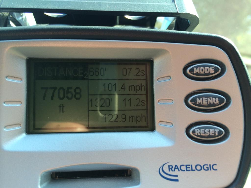

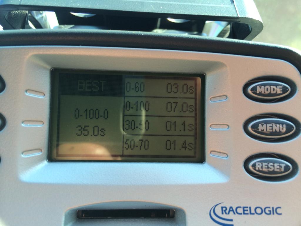

How accurate is the racelogic vbox? I just received mine and tested it yesterday and my best was 0-60mph in 3 seconds and 1/4 mile in 11.2 seconds at 122.9mph. Can I trust these numbers and use them as bragging rights or will I be shamed when I do go to the track?
I have a 2008 997.1tt tip and the only mod is a softronic ECU flash, 93 octane.

Seems about right to me for the 1/4 mile ET and trap.

It's more accurate than some 1/4 miles tracks! One big difference is usually trap speed. VBOX reads 1 or2 mph higher since it measures actual speed at the end of the 1/4 vs. a 100 foot trap at the end of the 1/4 at the tracks. Having said that, it's within 1% accuracy for me and the local tracks.
^^ 100% right on.
Your Vbox ET times will be very very close to a 1/4 mile track.
Whenever I am on the track my Vbox MPH and et are about .1 and 1mph slower than when I am on the street. I think it has to do with the sticky prepped surface.
Brag away!
Also, go ahead and upload your Vbox data into this graphing software. It will show you an amazing amount of data. http://www.vboxtools.com/

looks spot on to me. my buddy's GIAC only flash tippy car went 11.2 @ 122/123 at Atco with 1.66 60ft.

Verified p/vBox acceleration data the only type accepted on this site (and others) for 60-130mph and 100-200kpm times. Car magazines use it. And as others have said, it will typically provide for 1-2mph higher 1/4 mile traps because the drag strip will average the mph over the last 100 ft but the vBox will provide terminal speed.
The vBox also has 1-foot roll-out option that is also what the drag strips use. However the 1-foot option should not be used for 0-60 times because it will end up being slightly better. However, the magazines seem to enable the 1-foot roll out method and is why they get such good 0-60 times.

Their fast alright... Did you check off the 1 ft. rollout on the main menu? This will make it closer to what is actually happening at the track
I had it off, I think by default it is off.

If that is the case you are under 3 seconds already... Keep in mind most magazine use the 1 ft rollout C&D, Road and Track... You can take .2 to .3 seconds off you 0-60. Try it again and post the new result here. Would love to see the results. Also at the track there is up to 1 ft before you hit the beams.

Here you go I just took a little ride, 2 attempts 0-60 and 3 1/4 mile
