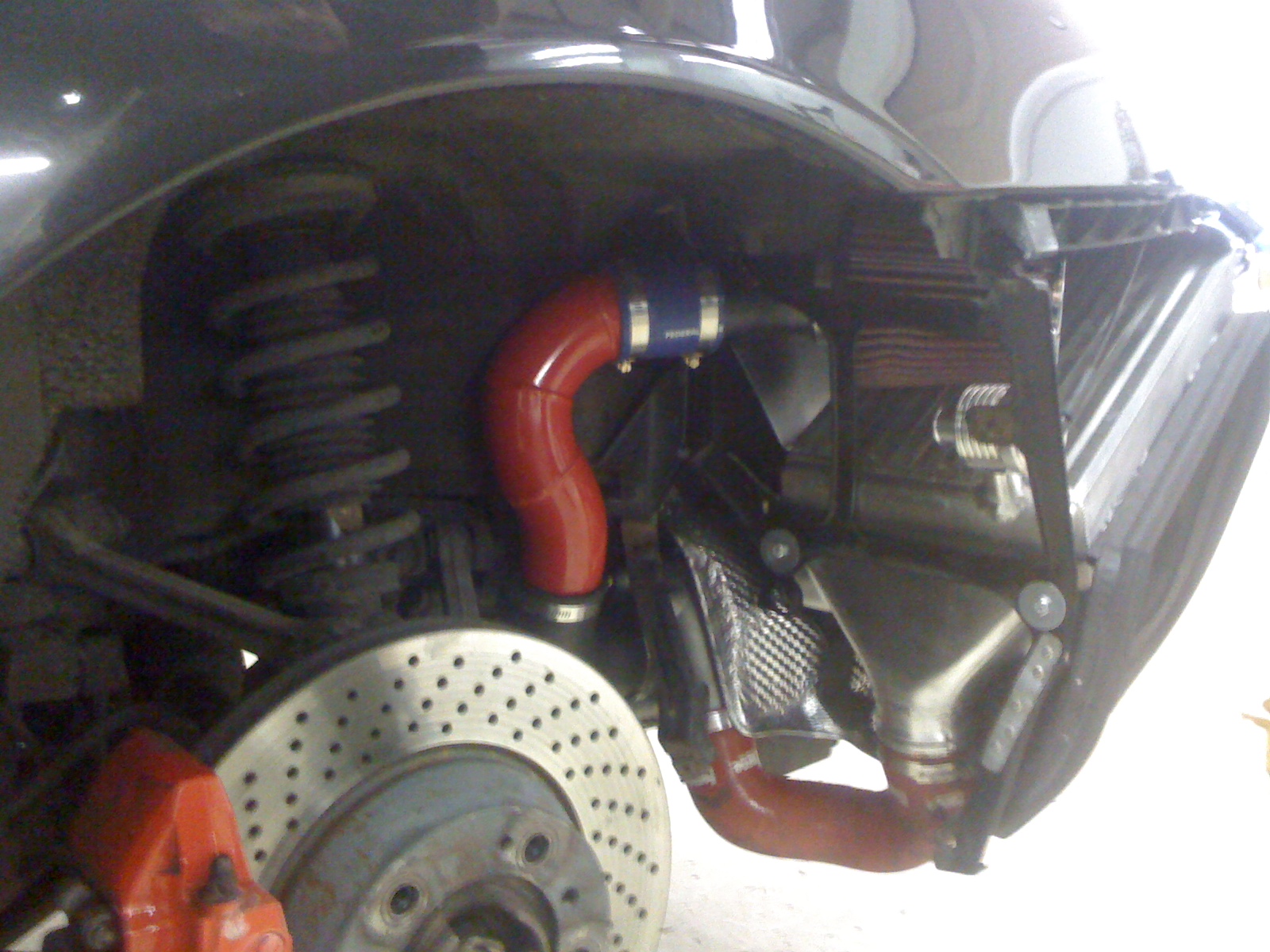

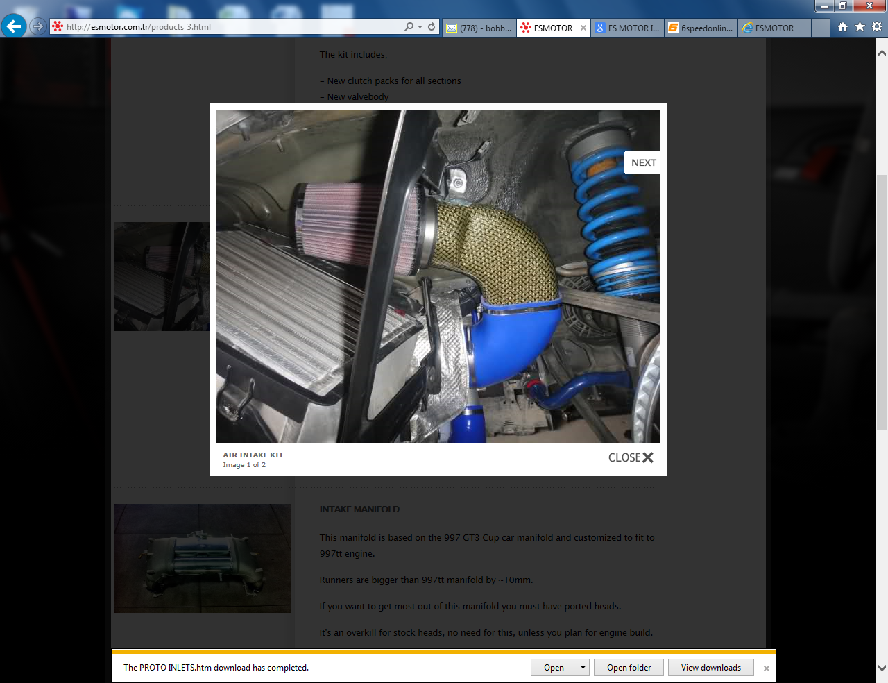

So the only difference in the Protomotive one is the material used and the ES one does not cover over intercoolers , but is placed more to the sides of the intercoolers??

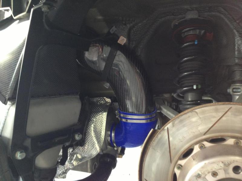

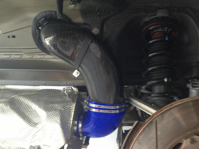

It looks like a fenderwell intake and has the same characteristics in flowing air to the turbos but it's a inlet pipe.
Those red/orange silicone hoses are the inlet pipes that connect the air box to the carbon piece.

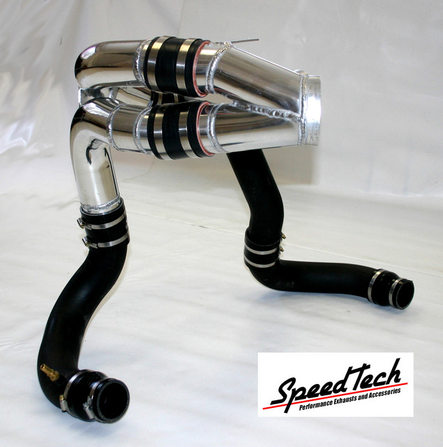

The 996 inlets have two coming off the turbos that "squish" down very small (bottle neck) in a couple of areas and then they both merge into one with another odd "squish" (bottle neck) and then they share that into the airbox.
The 997 have two separate inlets right into the airbox, making them less restrictive for smaller HP applications.

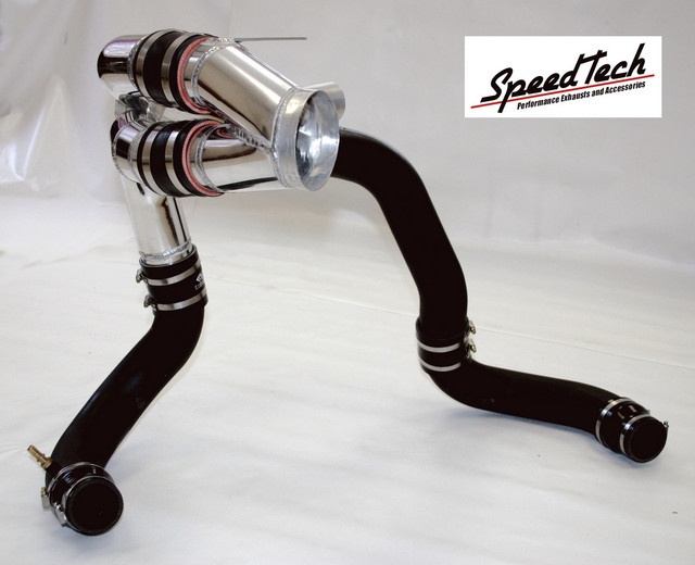

With my 996 I did the EVOM's inlets with Speedtechs Plenum that gets rid of that stock y-pipe join for a wide opening. This is what a FULL proper set up should be and not just the EVOM's inlets getting bottle necked by the stock Inlet Plemum!!! If you see a picture of the stock 996 inlets you wonder how even stock turbo's breath!
After the install of this with just a flash to get the car idling & to drive to 20km home (so I could trailer it to EPL and get a live dyno tune) and just off wastegates, This set up outspooled my Billet K16 WITH K24 BILLET 20 WHEELS!! The boost was more responsive & felt like it out spooled my BILLET 16's (with stock inlets and plenum) by over 400rpm's with the K24 BILLET 20's!!
This is why I am being a little picky to make sure I put on the best overall inlet's for performance, fitment, engineering, quality and represents what Porsche would of done if they were designing inlets for 800bhp.
Again this is why I love the AMS Alpha 9 Setup, because I believe it represents exactly that, bit for the full kit.
I most likely will be sticking with the VTG's so I am looking for something that would work now an if and when I go to Alpha/Gt turbos.
