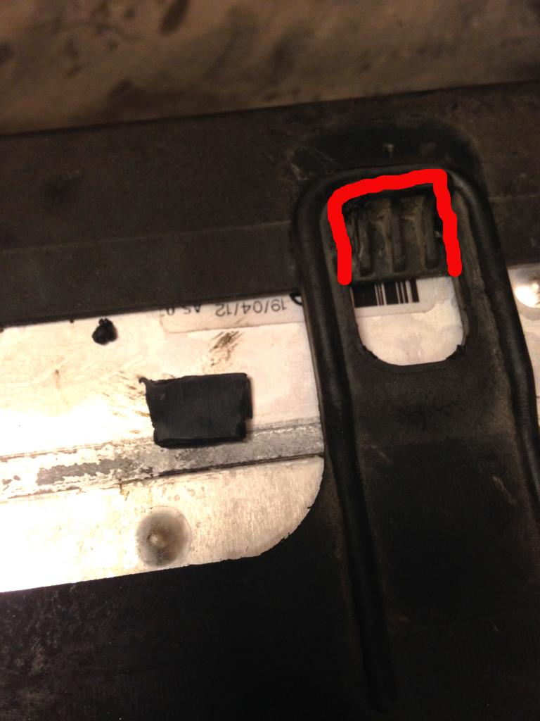

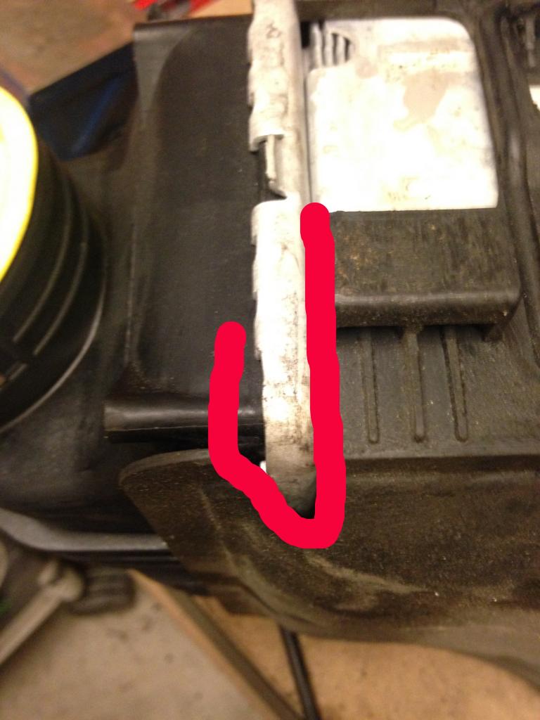

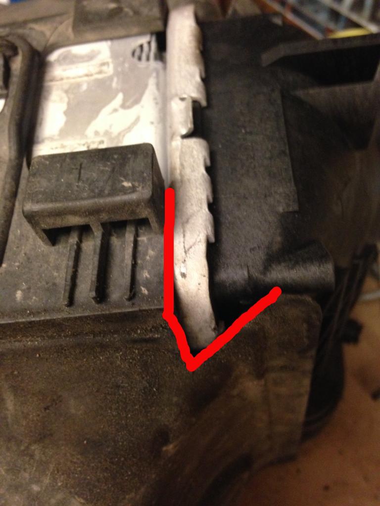

I followed therock's DIY for changing plugs to swap the exhaust and IC's, so assuming you have the IC's off the car and removed the metal frame that attaches the IC's to the chassis.
There is two air-ducts channeling air through the IC, they attach to each other with plastic "clips" (the plastic is a bit like rubber).
In each duct I cut slots for the wider core edges. Only took 2 pictures, but the idea is similar for all corners.
And then the clips that holds the air-ducts together I just made a bit "longer" by taking as much as I could/needed out.
I did cut a strip of plastic away on the "inside" of the air ducts, but I don't think it is needed, no picture of it and I think I might only have had done it on one side so...dont believe it was needed in the end.

Since the new core is about 20mm thicker the plastic ducts are a bit further apart than with the 997.1 IC's but reassembly was straight forward and didn't cause any issues due to this.
