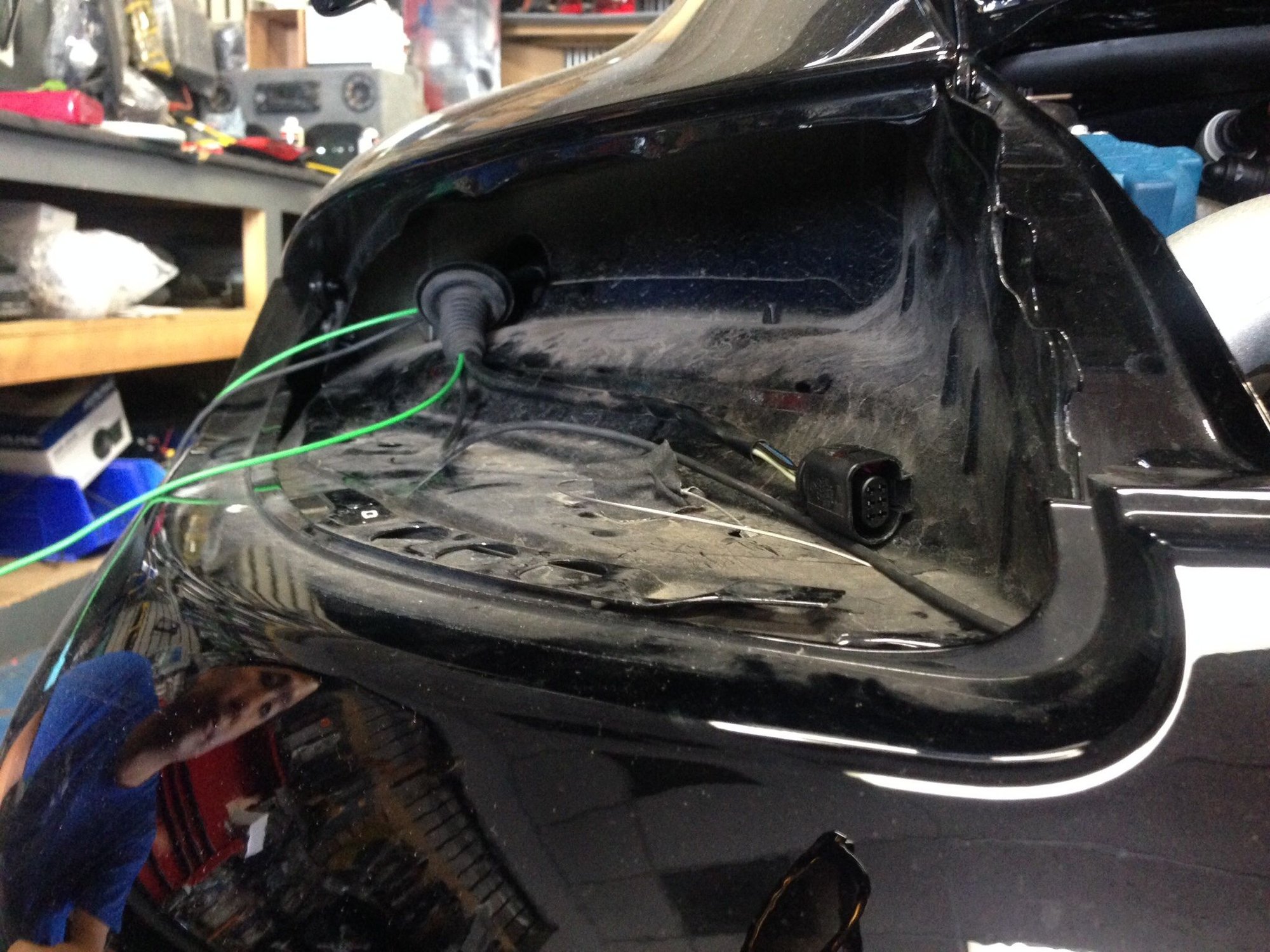

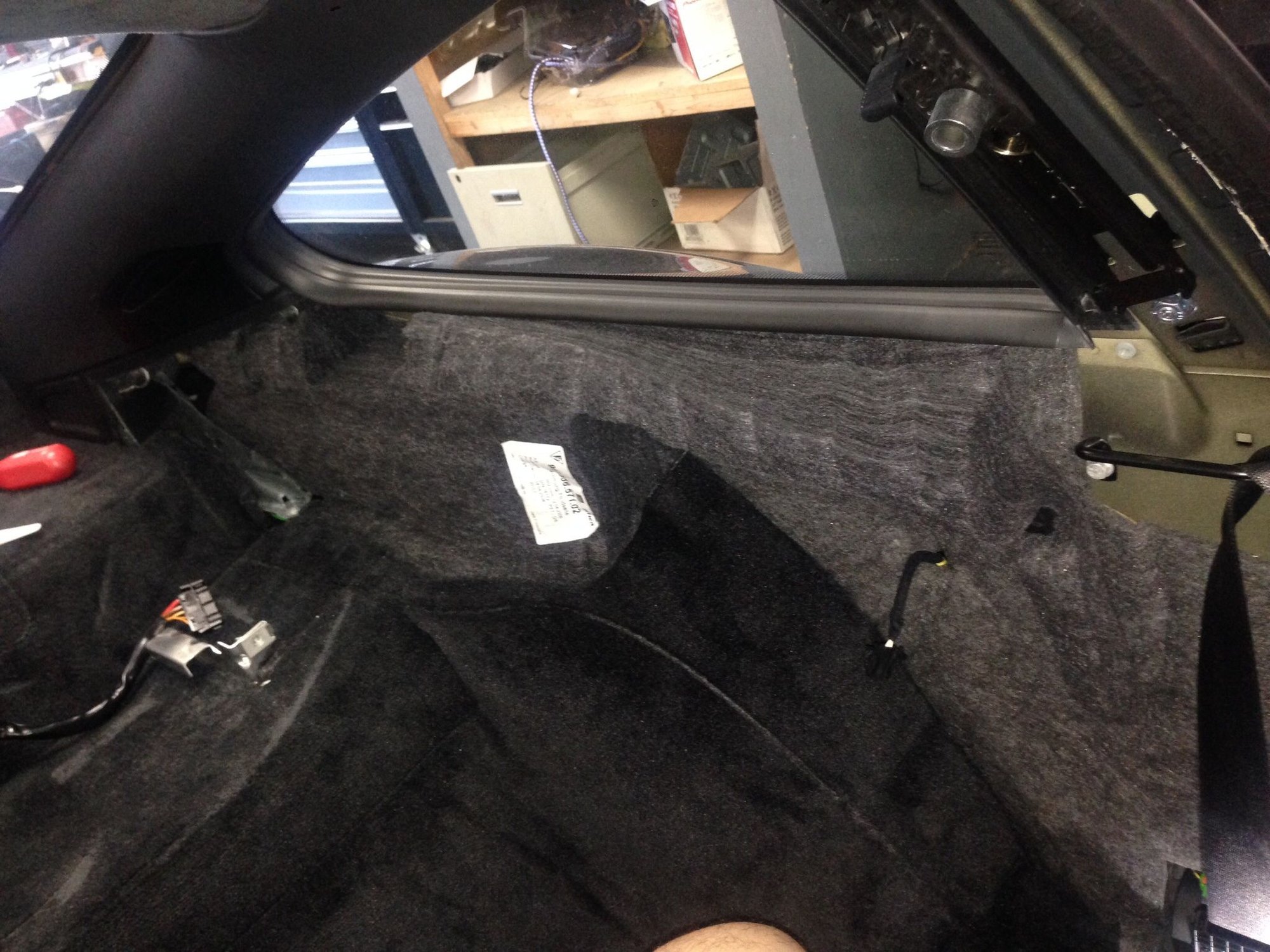

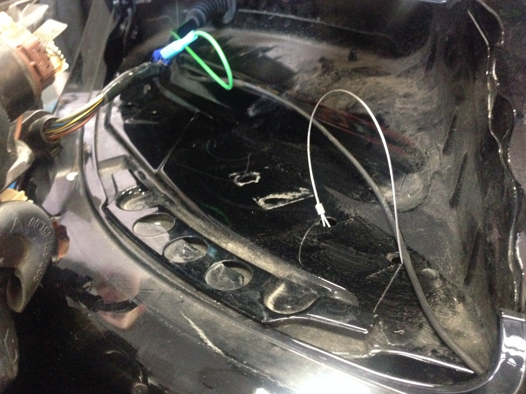

I had a license plate camera installed through NavTV:
http://www.crutchfield.com/S-UulBc8A...ck-finish.html
Wires routed through hole behind plate through bumper and then through taillight. No cutting.
Through taillight
From taillight through interior rubber grommet
