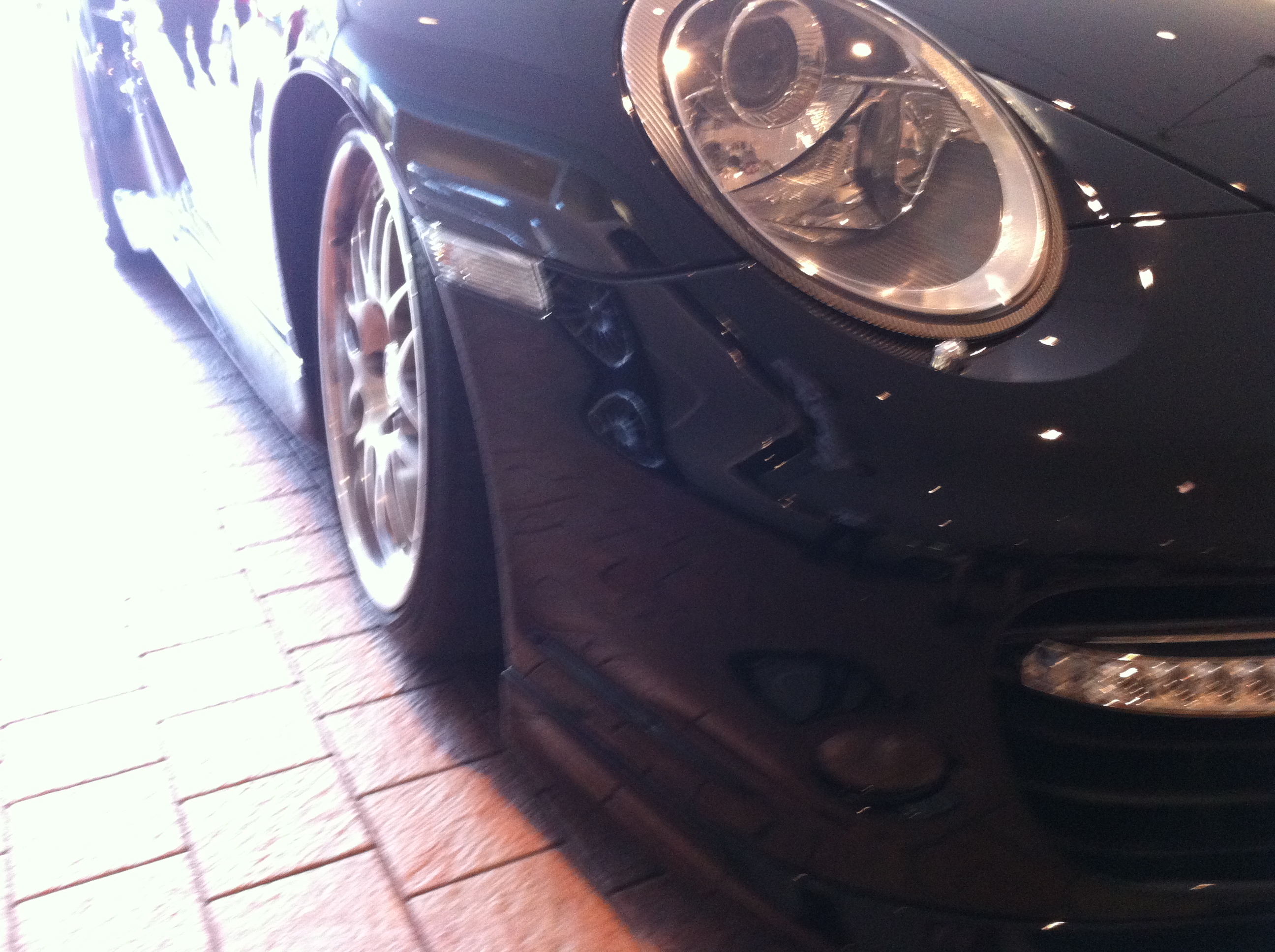

Mine werre installed correctly and even had the updated drop links . in fact it was my installer who noted that Dereks car was an installer issue directed at the washer concern .I posted on that old thread and even had met Derek in person as he came to Miami to buy his car. My car ran fine for 6 years on them until one day i was driving over a speed bump at 3 MPH or so and i heard a crunch . when i turned the steering wheel I heard more crunching and my car looked like this .

Ouch, what failed?
