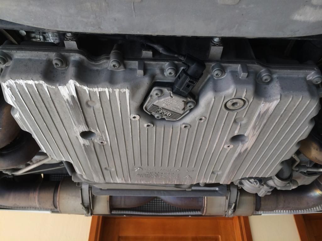

What happened to the car??? Well, here's some pictures;

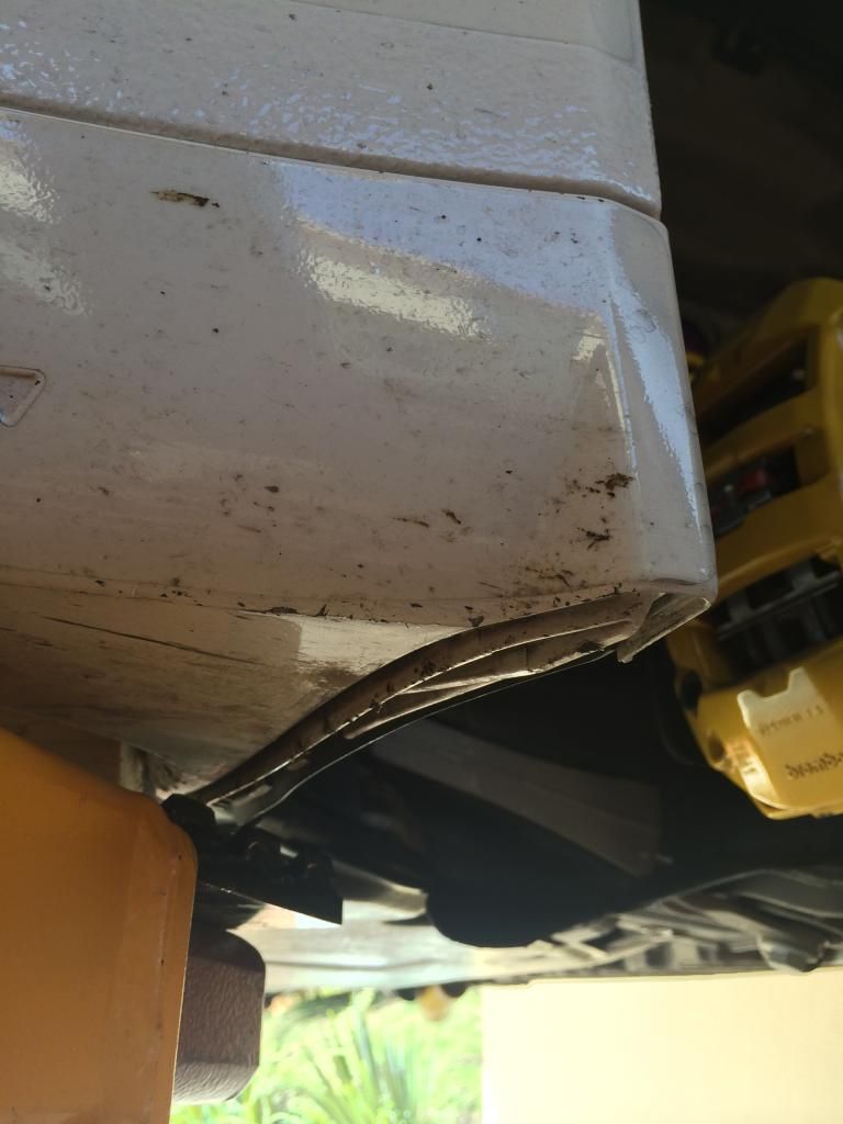

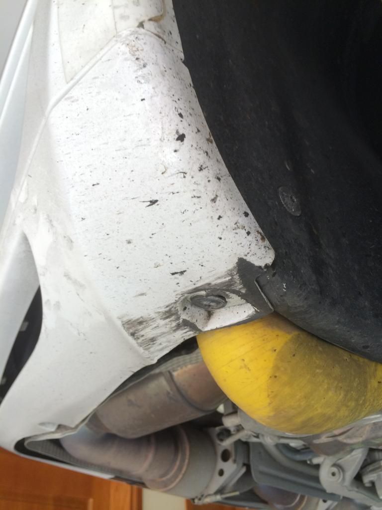

Scraped rear bumper trim.

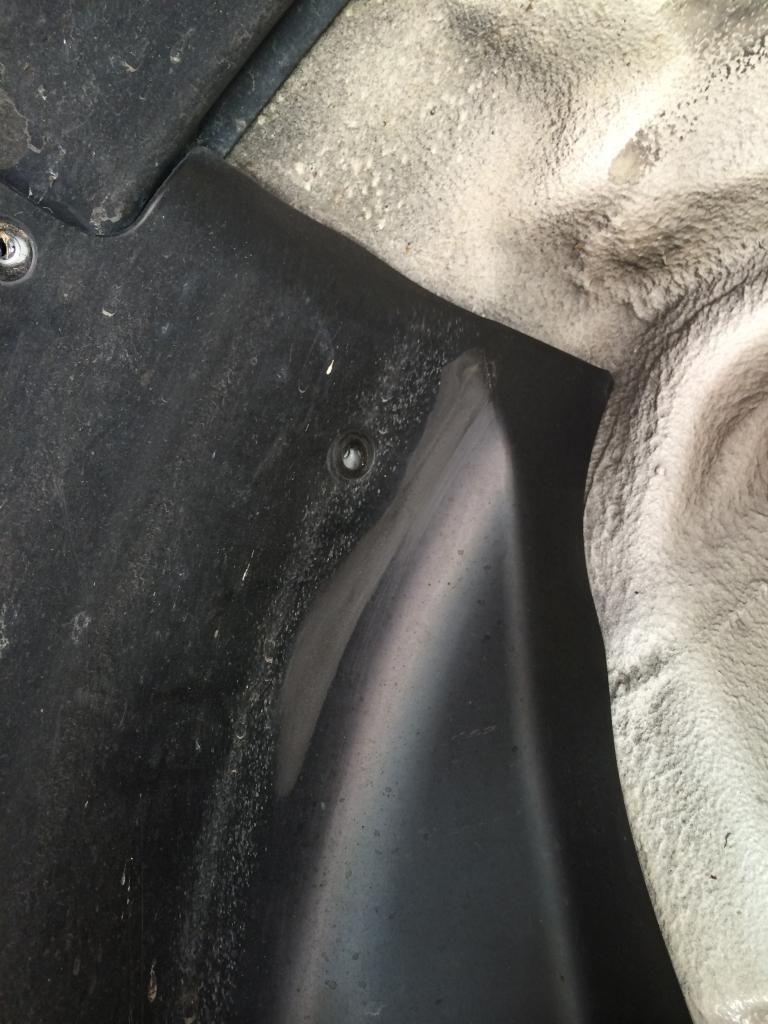

Huge hit here.
Notice where the rubber things? Notice where they are?

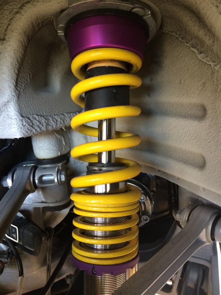

Front spring.
Front spring.
Bottom part of Turbo.

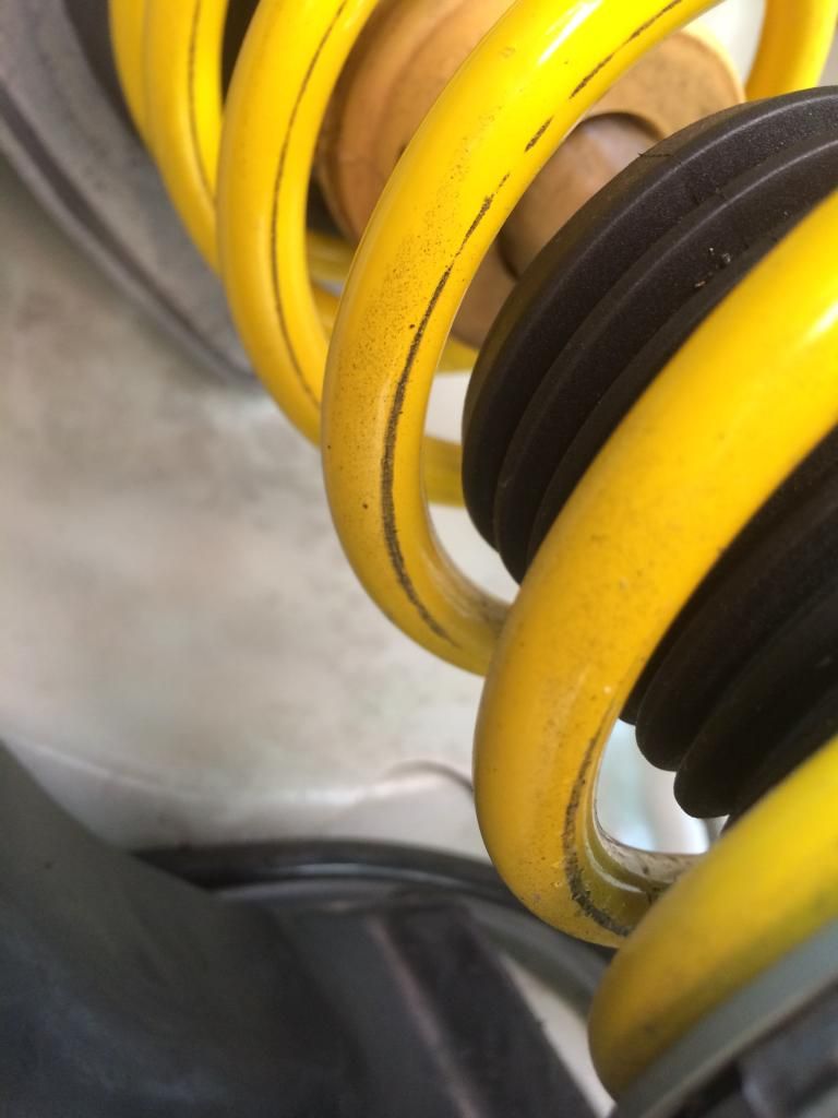

Front spring marked.
I'll probably get people saying I drove on some incredibly ****ty road, but no, it was a perfectly normal canyon road, I've done this road over 10 times with JRZ and 5 or so with OEM... And never ever had an issue like this.
I have a video, taken from the GTR, showing the road trip from beginning to end, and I'll post a part of it if you guys want to see the type of roads we drive in. They're not Nurburgring, but they're fine.
My point with this thread is to share my experience with this suspension... If you somehow have some rough roads, or anything that isn't perfect surfaces, think twice about this thing.
For now, I'm going back to JRZ, and getting over the 9,000$ down the drain, and be thankful I didn't break anything on my car.

I had the same issues. Had my V3 with lift kit for over a 3 years. The front spring is toooo soft. It is a progressive spring that's under 200 lbs. I talked about this here before and you can see the spring coils scraping each other on full compression. I removed the front spring and found an eibach linear spring that would fit over the strut. Eibach spring is 425 lbs I think. Much less front end dive at the track on threshold braking. I also installed appropriate monoball top mounts. It kept sounding like the front shocks were bottoming out before. Also make sure you don't lower the car too much. Originally mine was lowered beyond kw recommendations. I had the car raised to their max lowered height and now there's more suspension travel thus less bottoming out with the new spring. Can't lower the car too much with this kit which sucks. We called kw and they said nothing was wrong with the front spring and that's how it's meant to be. Poor design and engineering if you ask me.
I will be getting jrz too. What I recommend is you retrofit the lift kit system on the jrz. That would be best. I get noise too but would imagine it's more than you as I have the full RSS tarmac kit, gmg sways, and monoball top mounts. .

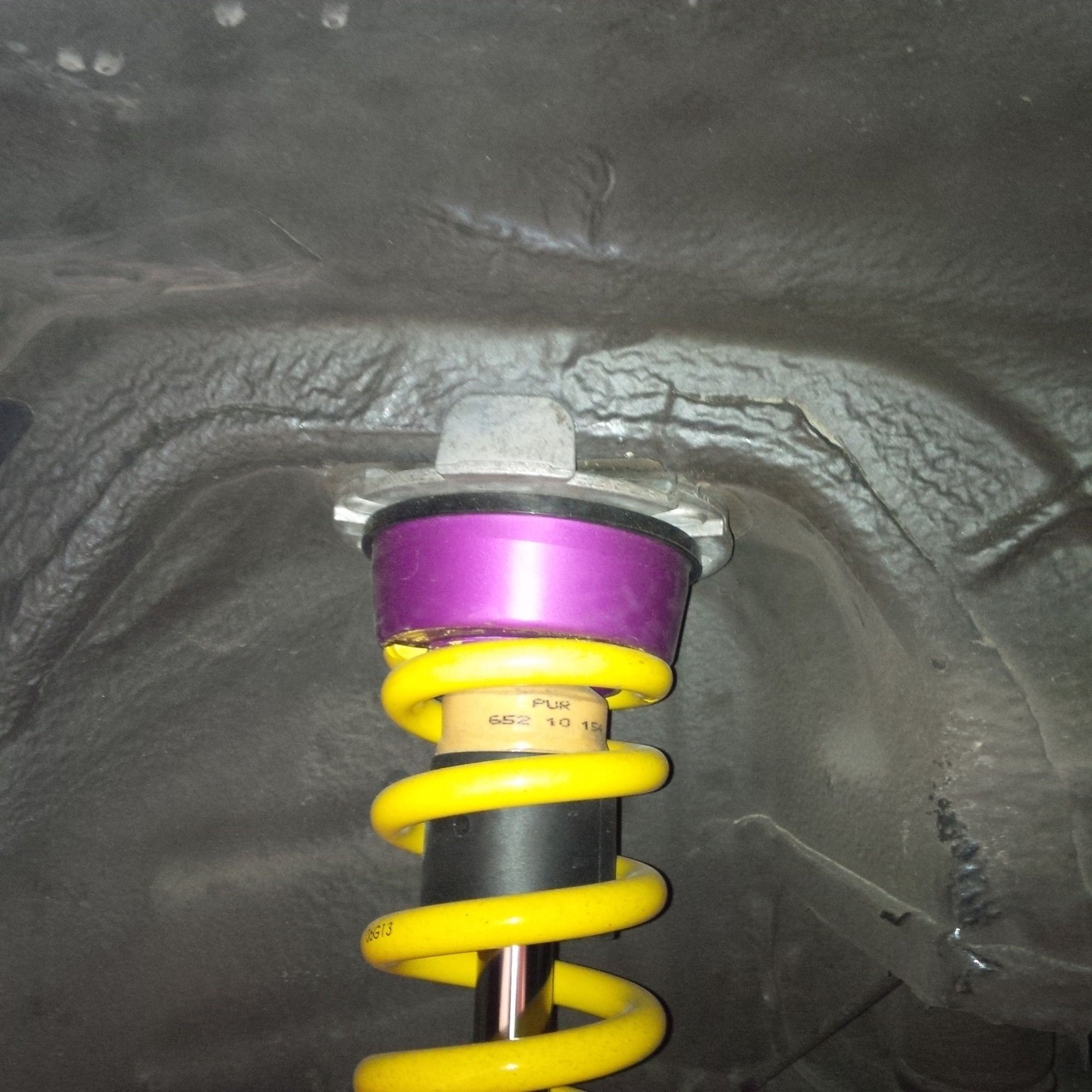

your pics are not working, i am curious to see position of springs.
Like chris mentioned, i also thought about consequences to lowering beyond recommended levels.

Seems like I lost the rubber thing on the left side of rear wheel;
Never before have I even hit my car, the front lip I'm surprised didn't break, it's the Werks carbon fiber lip, it's scraped. But I won't post any pictures of that as that can be scraped easily.

I didn't see your pics until you fixed them, but yes that's how my front springs look too. They are so soft that on compression the coils are sitting on each other. I forgot to mention this was so bad I bent both my front tarrett drop links. If you want to swap out the front spring and put on some monoball top mounts I can send you the info. It gives the best of both worlds and was a cheap fix.

my rear coil over pic attached when on a lift. Your foam part sits deeper.

My foam part is all the way pushed to the top, you can barely move it... It's pushed there by the force the shock did, it completely compressed, car pretty much hit the ground...
This is unacceptable on a performance suspension. Not even the OEM had these issues. The spring is just WAY too soft...
I haven't checked the drop links yet.

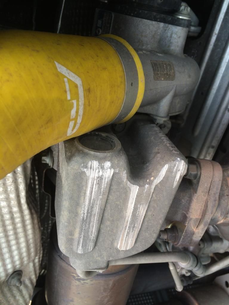

I'm taking intercoolers apart as well since I'm changing them too, good thing as the impact also broke one of the silicone hoses of the lower part that go to the Turbo.
You can see the marking where the tire hit the inner part of the fender.

I always thought the springs of the KW V3 were 900 or so lbs, from what I saw on another thread. But they're not, they must be 200 or less to bottom out like this.
