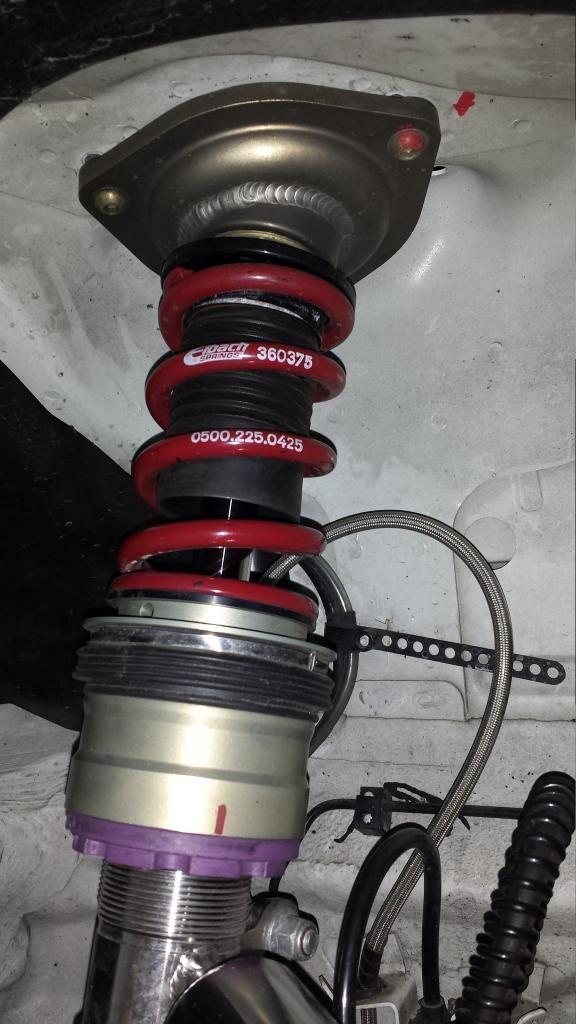

Both my tuners said they can retrofit the lift kit. So it should be possible. But we are really paying a premium for this lift kit as the full kit with V3's is 9k. V3's alone can be had for under 3k.
Anyway, KW won't fix this as they said it works as intended. I believe the rear spring rate is around 700lbs. The rear rates are very good. I believe the springs rates are softer on the HLS kit as opposed to just a V3 kit.
Here's a pic of the spring. I found them online for $80 bucks each. You will need new top hats.
Also check the collar that sits on top of the lift. Mine came loose and rotated 180 degrees. The locking nut stuck out and scratch the inner lip of my HRE's. It's not shown in the pics because i rotated it back to the inside.

I am running KW HLS2 on my 2010 997.2 Turbo.
I had major problems with the stock front springs of the HLS kit. After TTChris pointed out how to fix it (thanks TTChris!), I changed my front springs to 224lb spring rate using:
Swift
Part number:
z70-178-040
70mm x 7" length x 224lb spring rate
and things have been great ever since. No more crazy bottoming, decent ride on the street, and very good at the track.
