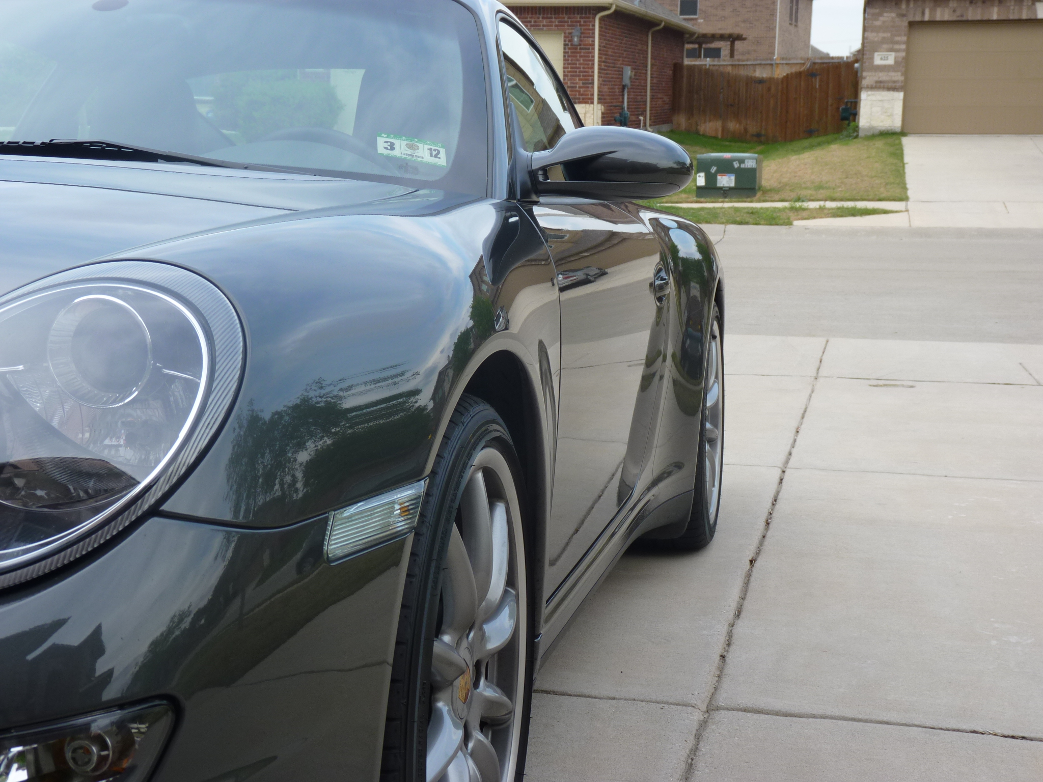

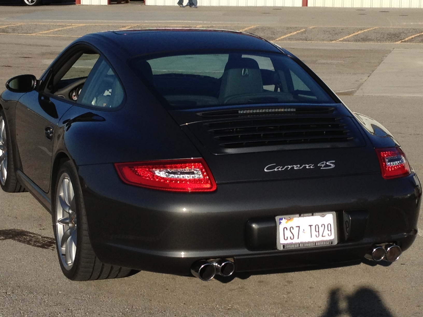

Pics
Hope these help. I couldn't tell that they stuck out any more than the 235/305's
