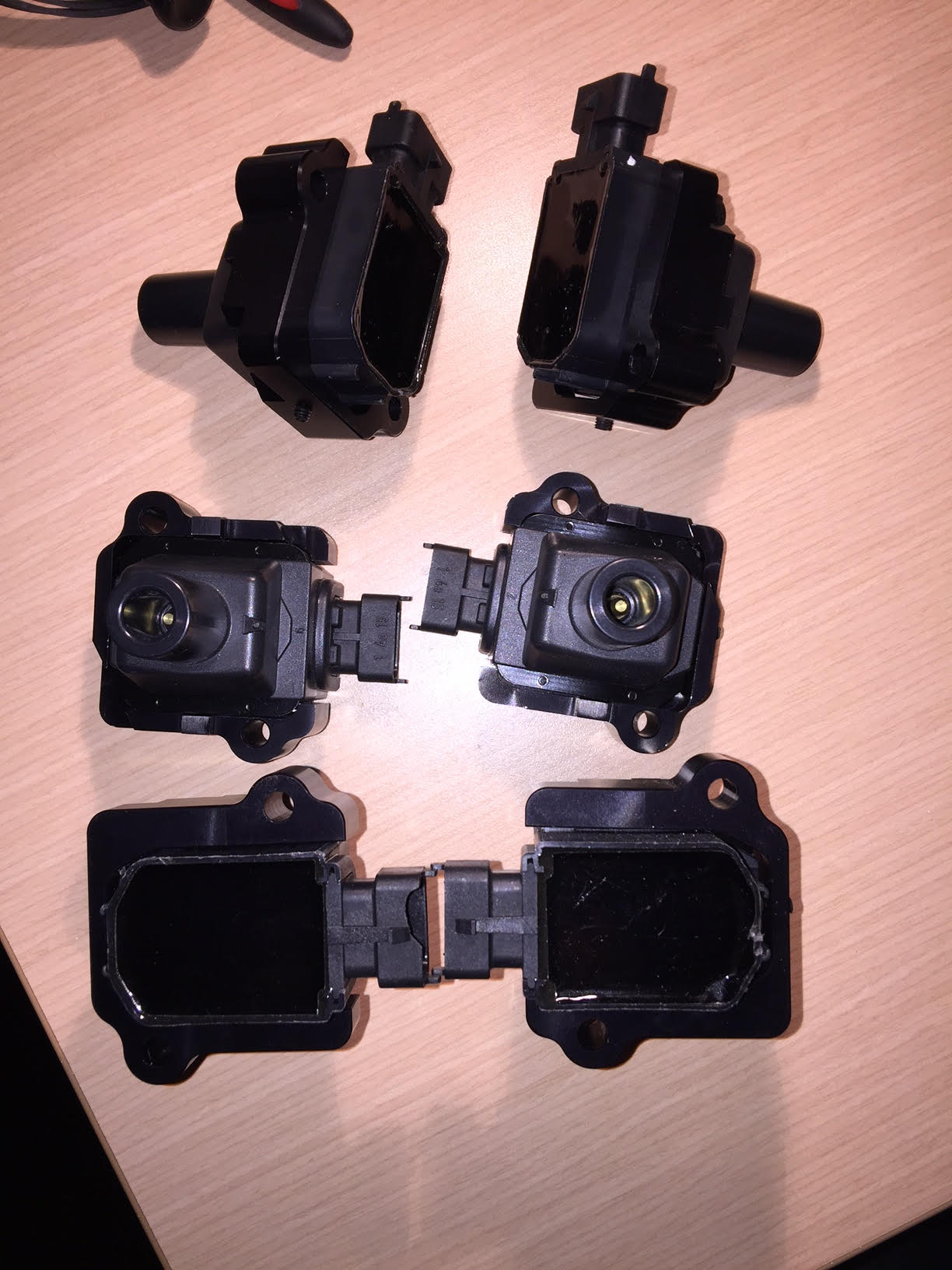

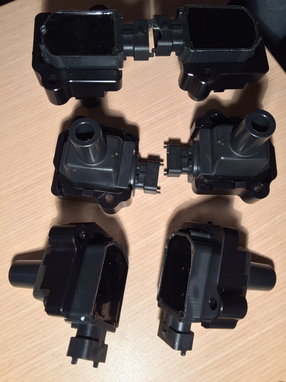

Just a quick one for those that have ordered the EVOMs coil packs.
I bought these NIB from a forum member, but want to verify before I get everything ready to install.
See the attached picture; can people verify that these are legit EVOMs coils?:
The coil packs I've received do not include the rubber 'stub' pieces down to the plug, do I re-use the OEM ones? or do I have to order new pieces?
The pieces are pretty straightforward. Some quick comments are that they seem to use a Bosch P50 coil, with a CNC adapter.
One comment I have to make is that they attempt to hide the Part Number by grinding the numbers off and attaching a piece of plastic over the coil. They are legit bosch coils though...
Also, on the 6 coils I have the set pin hole is a m5 thread; 3 have metric threaded set-pins, while the other 3 pins have a standard thread that does not match the hole. But that could just be where they have changed hands a few times.
Anyway, Do I need the stubs? anyone else have these to give opinions of?
Also have P8 plugs to go with these.
Thanks!

Don't know how old these are, but the new set doesn't have paint on them and appear to include the extension.
Personally, being that this job is a lot of work or expensive if you don't choose to DIY, I wouldn't chance it.

looks like one of the coils has a broken or cracked electrical connector already 50 mj isn't a ton of juice either
Haha, yes, the joys of postal shipping.
The electrical connector doesn't bother me, I have access to other Benz branded P50 coils.
I did notice that the evoms picture above seems to include the 'tubes' but I always imagined that as a promo photo, as well as the un-anodized finish.
You'll notice they do not have set-screws either... however they are most definitely required
Thanks for the replies, I purchased these during the active season last year, so now that it's currently winter here, it's time to swap...

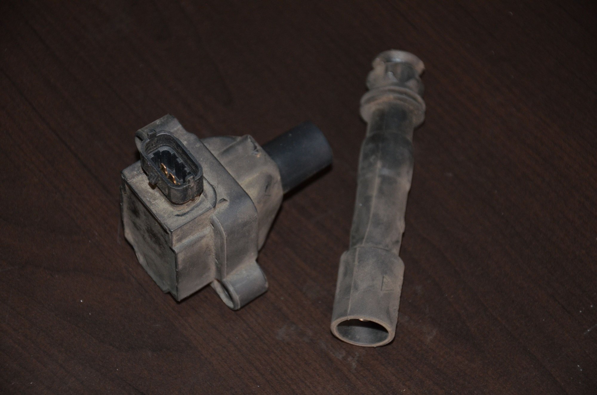

Here is the stock coil. You can remove the rubber extender and reuse.

The OP's coils look like what we've been building for the past little while. I believe the set screw spec changed at some point, so you might have gotten a crossover between two batches. The factory spark plug boots do get transferred over as mentioned above.
