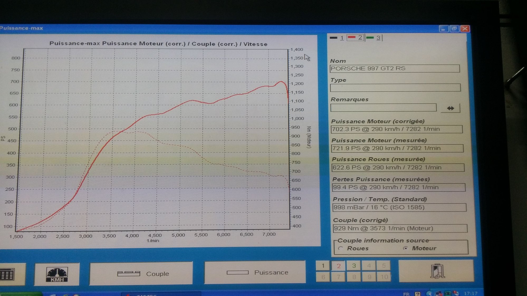

Originally Posted by prodigymb
Have you ever put the car on a dyno to see how much WHP it actually makes and how the curve looks?
See below :
Another one :
WHP is at "Puissances Roues" -> 622.6
