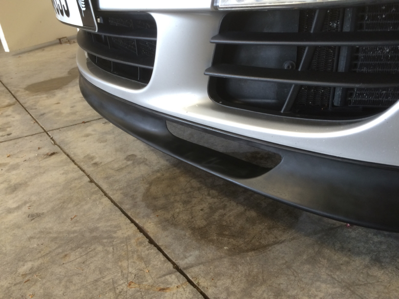

I bought one of the cheap eBay aero replicas. Finish was pretty rough, needed a wet sand. Still needs another pass with 2000 grit paper.

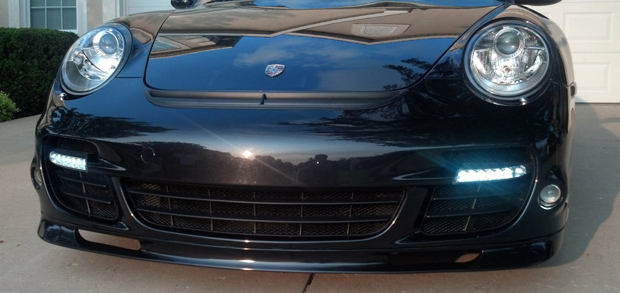

Bought one of the eBay ones and thought it was pretty good quality for the price! I sanded, PAP(adhesion promoter), primed, sanded, degreaser, 2 coats Basalt Black Metallic, 3 coats clear...polished (all took a couple hours with lots of it just waiting for paint to dry)...Thought it came out very good.
If it has any slight warping or mis-shaping (as most any kind of flexible part will) you simply hit it with a heat gun and if forms perfectly.
Good luck!
Good luck!
DC
+1 - i did the same thing (well a body shop did the painting - i am no DC ) and really like the result - very happy with it!
