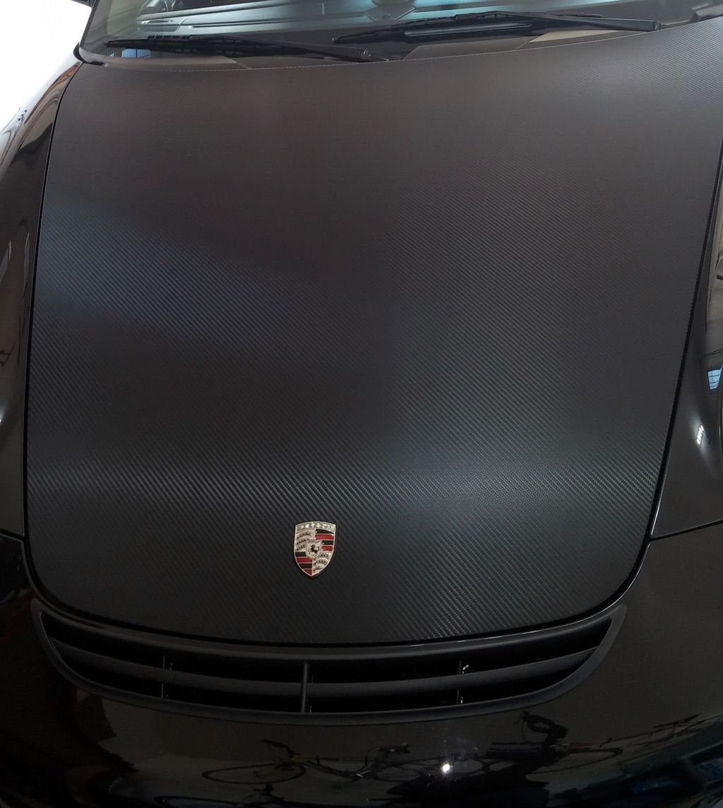

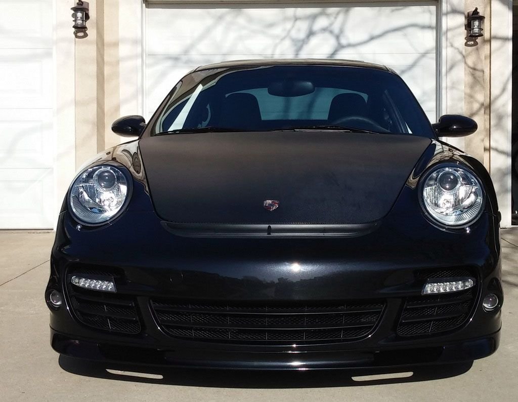

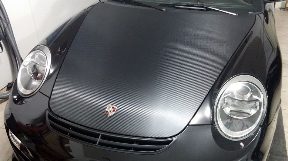

So yesterday, I had some free time (rare)...And I was out of projects to do on my P-cars for the moment...But I did have a sunny day (FINALLY!) and a large sheet of Carbon Fiber Vinyl Wrap.....Soooo, I decided to give it a try.
I only spent about 1 - 1 1/2 hours start to finish. I took the badge off the hood, made sure the hood was wax free with some ammonia cleaner and microfiber towels, and used a blow dryer, felt wrapped squeegee, credit card, and fine X-acto blade...And most importantly some patience!
I was just curious how it would look, and I thought it would help protect the hood, and it is easily reversible...Also the look started to grow on me with the GT2 hoods...
Posted pics below, and I am quite pleased with the outcome...and surprised I could get it applied so well since I have no WRAP experience...But not a bad job.
I know the look is not for everyone. But I think it looks pretty good for the small investment of time and money.

Hey, great job. From the pics, it looks just like a professional job.

Thanks! It looks good up close too. I was shocked that it came out pretty much flawless. Guessing the new materials/technology make it better...Slight heat helps a bunch too....the material is semi-stiff, but when you warm it up (not overheat it), it gets very soft and workable...
I remember in High School, trying to tint windows in my car...and ...well...Let's just say there were bubbles everywhere and it was hard to work with.

Looks awesome - event better on a black car!

Thanks....Appreciate it. And Yes, I think it blends very well with the Basalt Black Metallic....Likin' it so far

I like the carbon wrap on your black car. It's a nice subtle touch. Are you going to do the roof?

Thanks. Had not thought about the roof....But may give it try??
