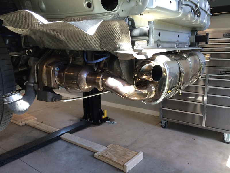

No Problem....Here is a picture of what they look like when you get the OEM Cat off (soaked a little from the PB Blaster (USE PLENTY OF THAT AND LET IT SOAK). I just took them off, cleaned them with solvent, and wiped them with a scuff pad so they were clean and smooth...then re-installed.
And the other picture is after HJS Cat is installed using same gasket. Has been on there for almost 2 years and no leaks or issues.

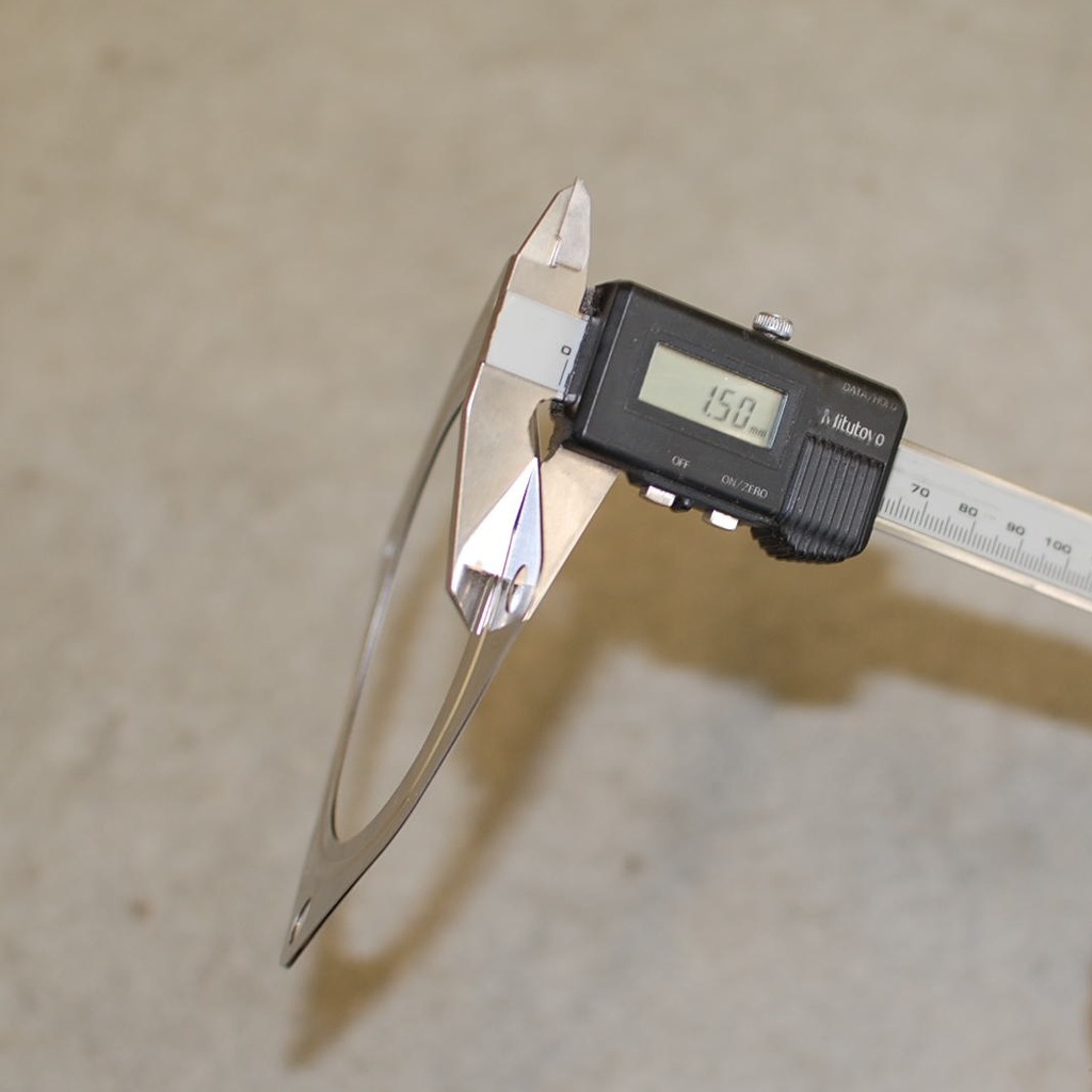

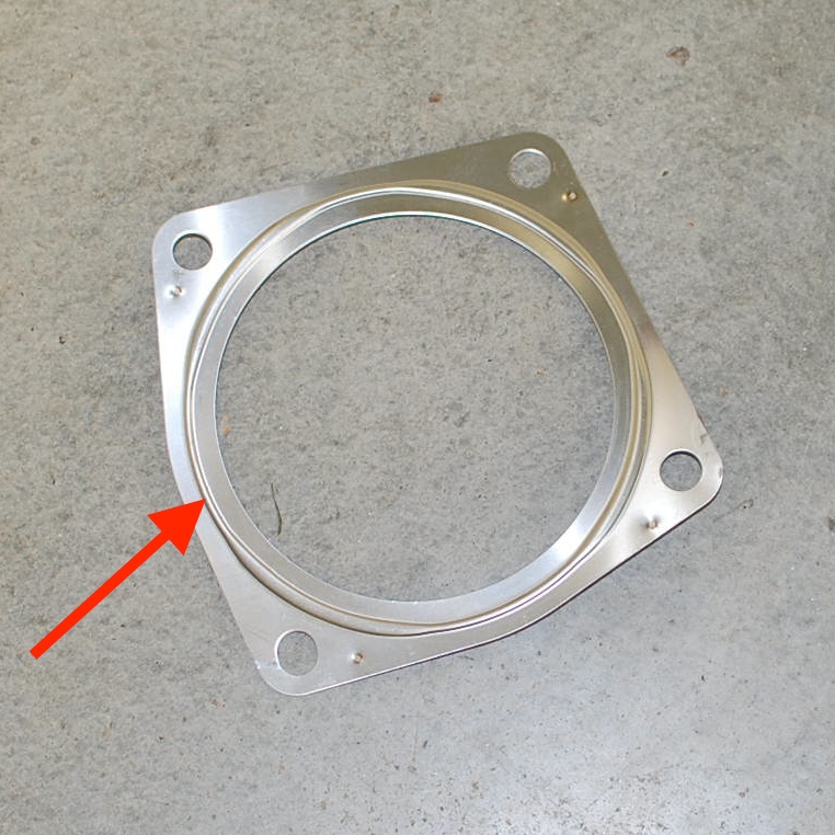

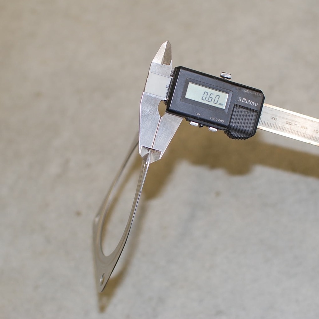

New gaskets have a raised portion that gets crunched when you tighten the nuts at the turbochargers.
Seals much better than a used flat gasket.

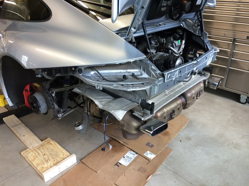

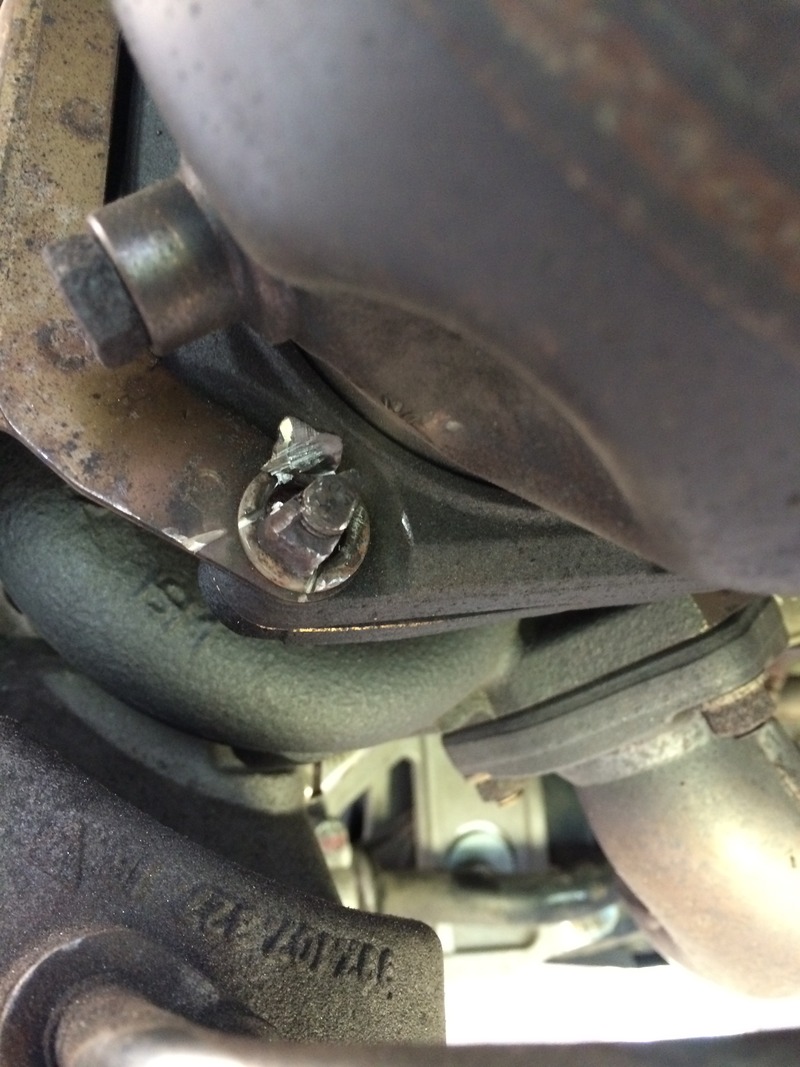

I got the exhaust installed this weekend. Oddly it took me the 6 hours everyone said it would, but for different reasons.
My main 2 issues were the bolts that held the exhaust tips on were really rough, almost like they were cross threaded. One side broke off, and so I put a stainless nut and bolt combo on there after I drilled it out. The other I was real carefull with, and still am afraid to touch it to adjust it
The other thing I was not as prepared for was taking the heat shields off the OEM muffler to get the straps off that hold the muffler to the car. There were about 8 allen bolts per side, and each one was a 8!tch to get off without stripping or breaking them off. I probably tied up an hour or more taking the muffler tips and the heatshields off.
At the end of the day it was all worth it. Improved pedal response, and of course a lot nicer sound coming from the back of the car.
Thanks theRock88 for your help and the intercooler DIY, it helped make this go smoother.

One of the 2 outer bolts that gave me an issue. Like 93LS1RX7 mentioned they seemed to have eroded to a smaller than 13mm size. I cut them off

Does the little ridge go against the turbo or the exhaust? How about the ridge on the gasket between head and manifold....which one does it face?
