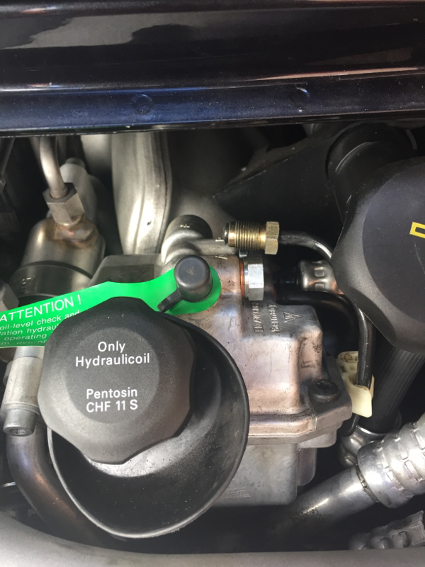

If it is Pentosin, it could just have leaked from the disconnected line from the steering pump after the GT2 slave mod. (See disconnected line in picture) Hopefully, that's it. Check the position of the puddle and see what it lines up with. If it is near the clutch slave and it is Pentosin, all is good - it just leaked from the disconnected line. If it is Pentosin and under the steering pump, it could still be from the disconnected line.
I would suggest a really good clean up of the disconnected stuff, top up the Pentosin, check the clutch fluid level and wait for the next puddle.
If it is brake fluid and the puddle is under the slave, you may have an installation problem with the new slave - check the lines and look for leaks. The clutch fluid reservoir will tell the story there.

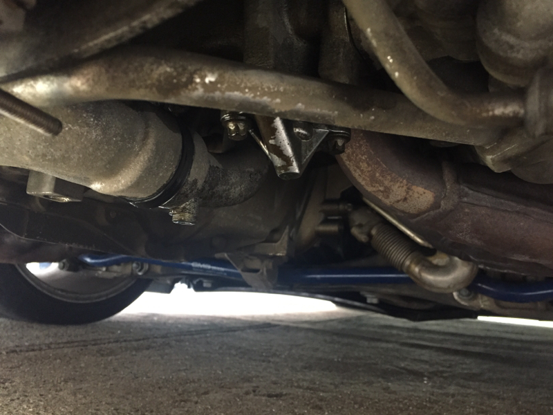

The puddle is on the left rear of the car, which side is the slave on and where is the steering pump located?

The slave is under the rear of the passenger seat (on the transmission). The power steering pump is in your picture (#3) where the disconnected hydraulic line is.

Edit: From the picture it looks like the right side - under the power steering pump...
