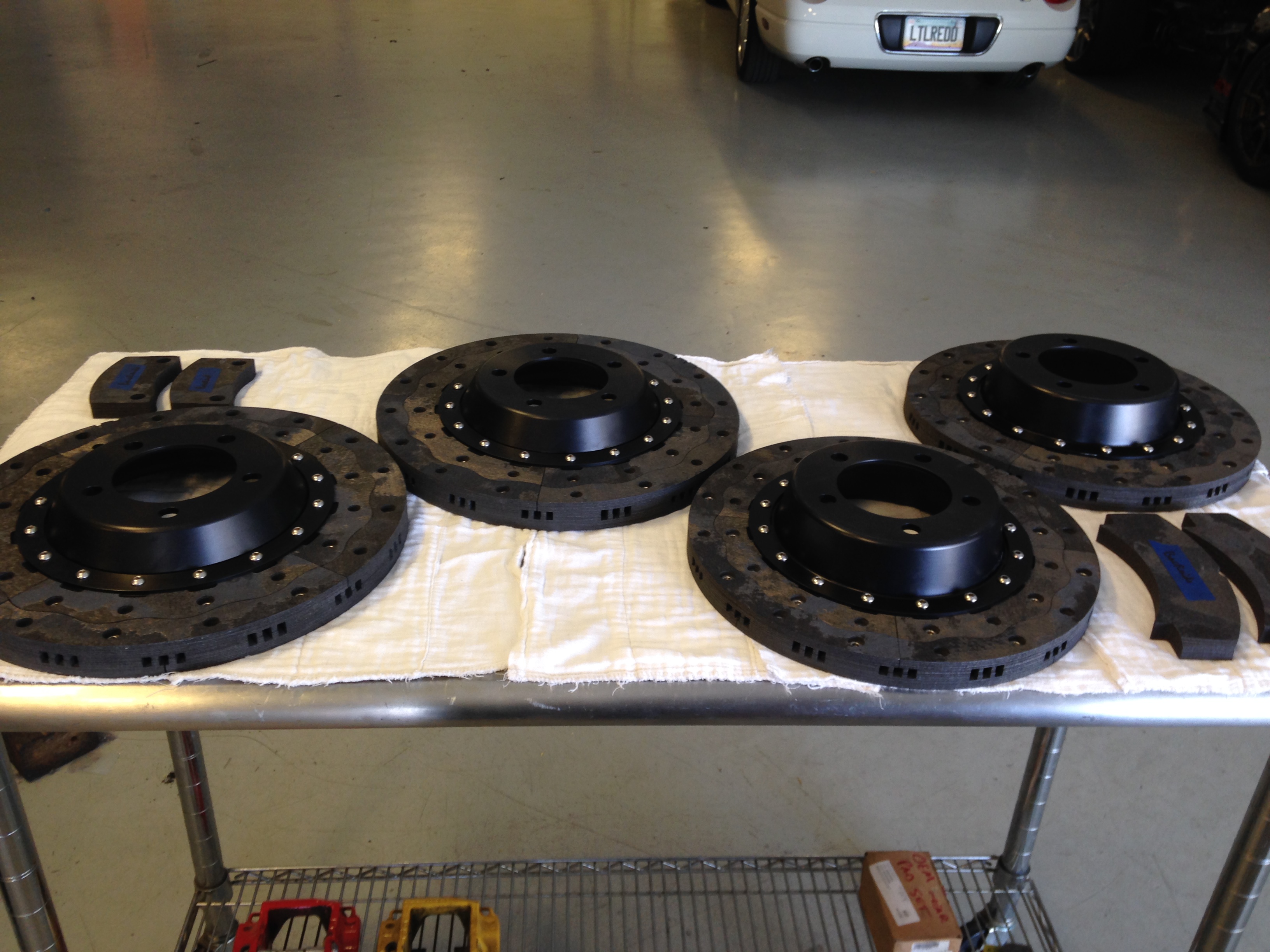

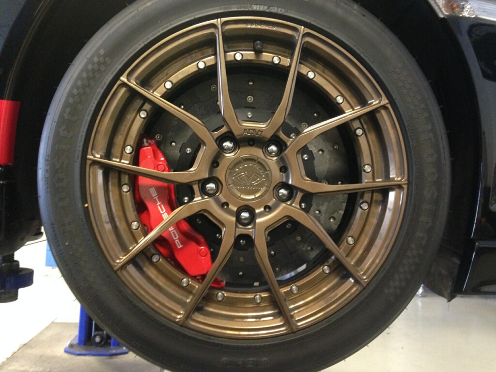

RPS Formula 1 Style Carbon-Carbon Brake Kit
I was in the market for a Carbon Brake Kit for a while. I heard great things about RPS with there Carbon-Carbon Brake Kit so I gave them a chance. This kit also includes carbon brake pads as well. Evoms and RPS worked together to fit a 380mm rotor upfront with an 18" wheel. I stopped from 219.2mph this past weekend and had zero fade. It's a good amount lighter than PCCB as well. I saved almost 70lbs of rotating mass with the carbon pads. No chipping or wearing like PCCB as well. The price was not bad either. Evoms sells this kit for $11,000 plus install. Evoms has the exclusive rights to sell for RPS in the porsche platform. Only downside to these is that you can not drive them in the rain. My car doesn't see rain so there is not a problem for me.
Any questions let me know! Happy to answer!

Why can't they go in the rain?

Pure Carbon.

Most likely they need to be heated up to stop well and the rain keeps them cool. My PCCB work fine in wet, but are awesome in the dry. I can feel the difference.

they soak up water when they get wet and you cant really stop until they are dry. otherwise they are a sick option for a car like this.

Sick looking set up... can't they do the old abrasive interface for wet weather like they did on the old 1970s V8 Group cars ?

These are awesome! Thanks for sharing.
The would however be an absolute FAIL in Vancouver, Canada... living in a rain forrest :P

Curious. The caliper is in a different position in the photos and I noticed in your shift sector photos the front caliper is on the bottom.
Is there an advantage in that??

Beg to differ. PCCB's, and the ones cited are not "pure carbon". They are a carbon matrix treated with a ceramic coating. The "cooking" of the discs takes a very very long time, using huge amounts of fuel (electric or gas), and are then finish-machined individually. Expensive process. At some point, hopefully soon, a larger-scale, less "fussy" process will appear.
Interesting to note these discs seem to be made of mechanically fastened segments..riveted?

I agree. I'm don't know of any production cars with pure carbon brakes.
