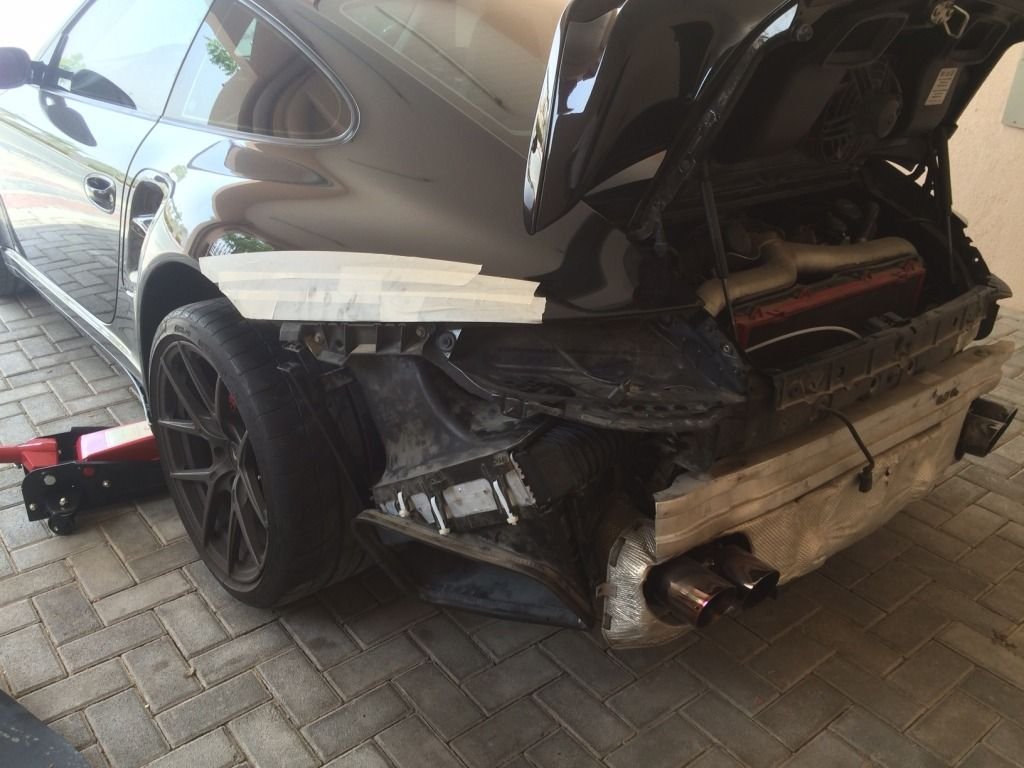

Right, So i had some spare time this weekend to carry on with the install.
I had to remove the rear bumper so i thought id install the 997.2 coolers at the same time.
First things first, download and print The Rocks great guide!
Jacked up the car and removed everything
Swapped the coolers
Reinstall..
Install the Aquamist gauge

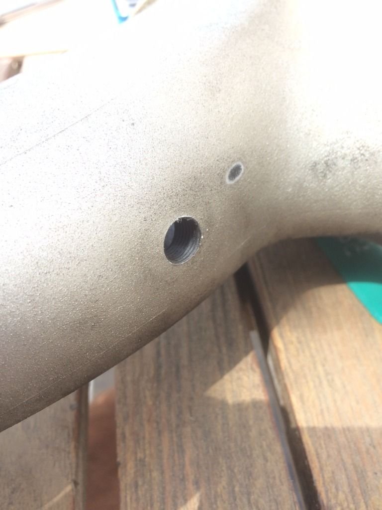

The next step is probably the one i was most worried about... Drilling and Tapping the Y pipe.. I used an 8.5mm drill bit for the initial hole, then a 1/8npt tap and took my time. Y pipe is actually plastic...
Check out those threads!
Some lock tight and they went in without mishap...

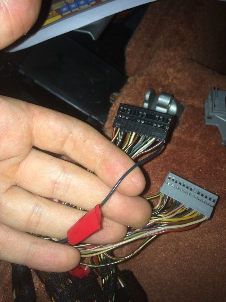

Ok, Well I'm into bigger problems with the wiring and before chopping wires i thought id consult you guys.
I followed the HFS3 wiring diagram and found the CORRECT pins mentioned but the wires are the wrong colours!
I sorted out the harness.
I wired in the power to the ignition switch, that was fine... LARGE PIN 8
Next was the CUT... But the wire was totally olive green not white/green. PIN 4. Also does the brown go to negative for the CUT?
Next was the MAP sensor, it was dark green, not white/black... PIN 39.
Next was the F.IDC Its supposed to be Brown/Black but it was brown/cream. PIN 41.
Any idea's?
Also what do i do with the spare harness wires? I just left them.
