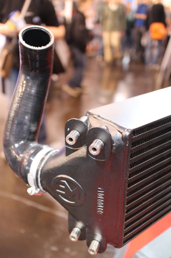

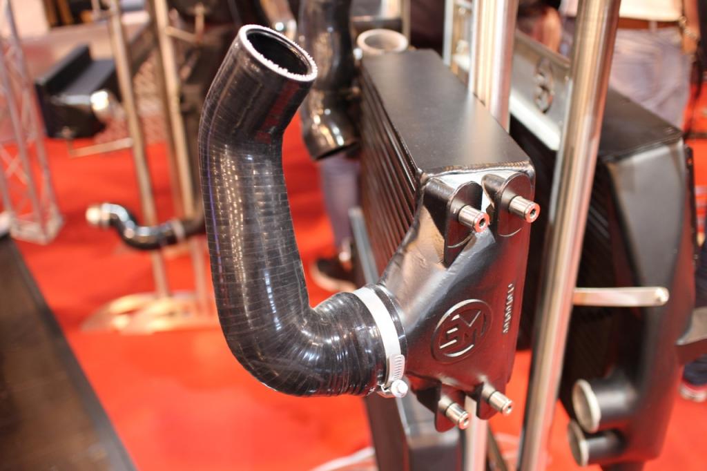

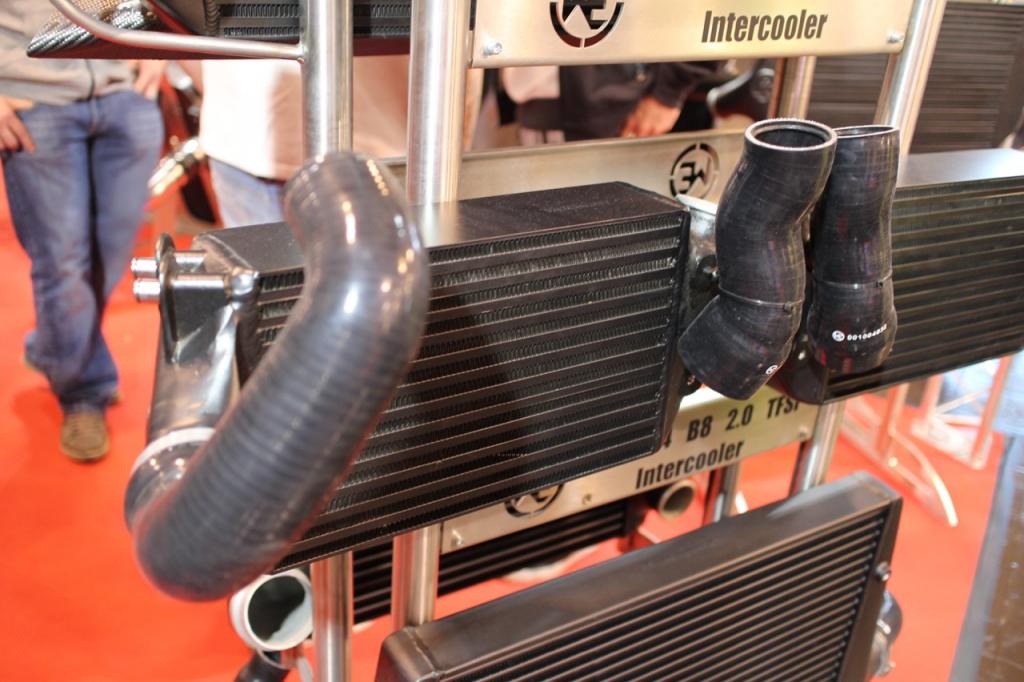

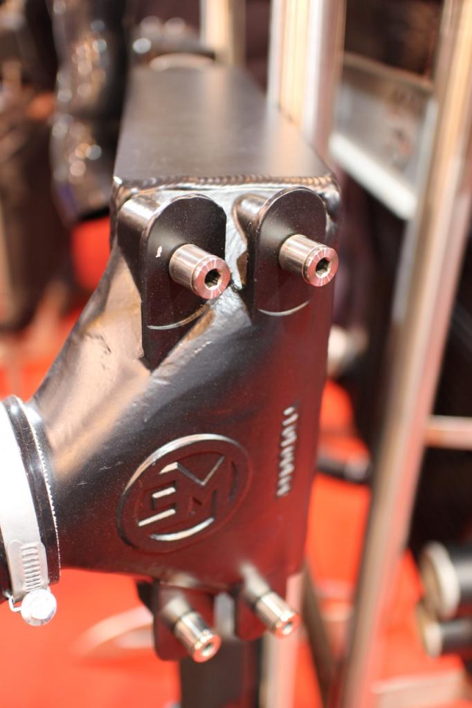

Saw them in Essen Tuning Messe in 2014. Definitely not german's quality.
Went for 997.2 for myself
