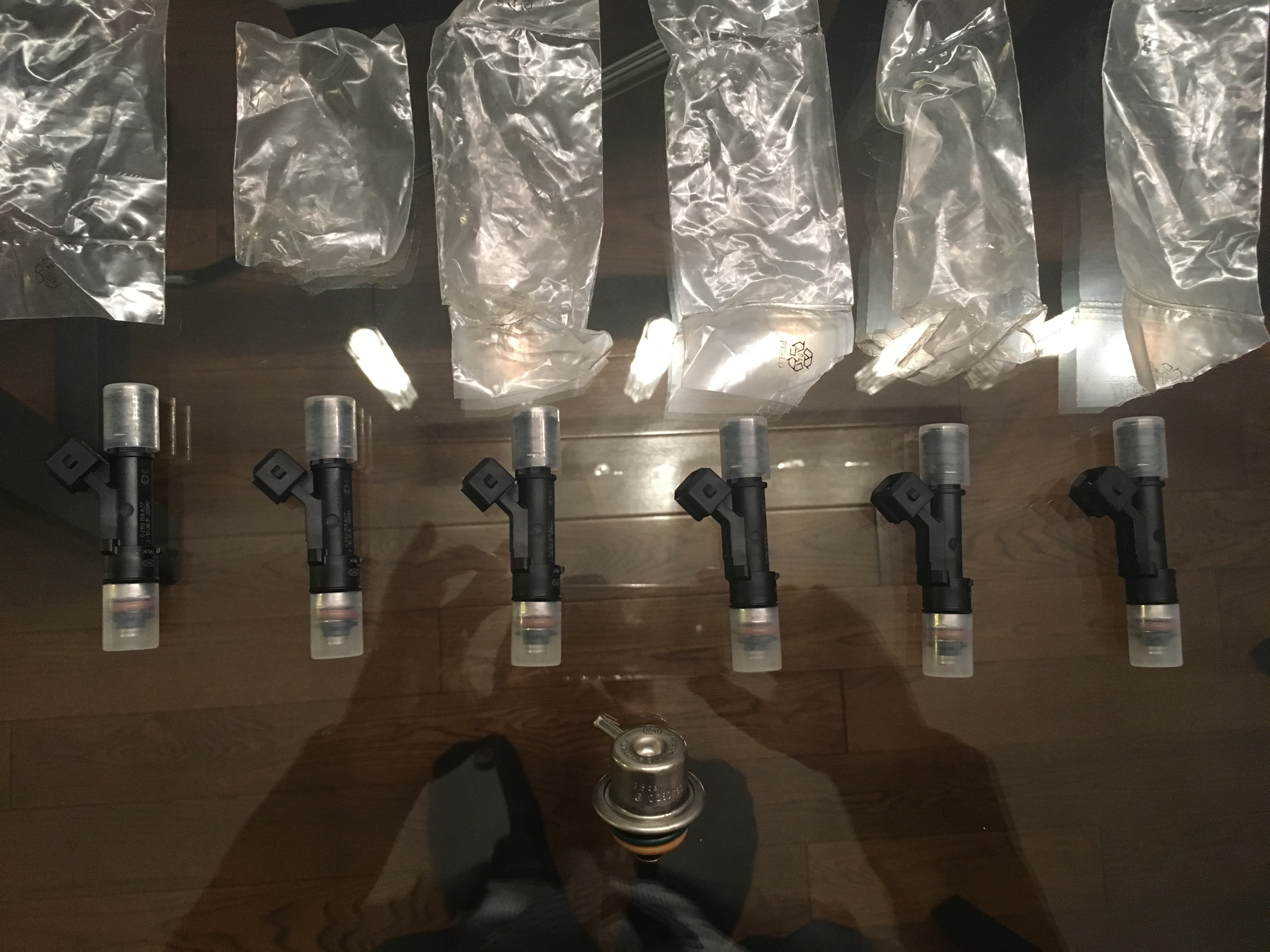

Installing Protomotive 1680cc injectors
I am completely out of fuel on the top, as in 95% and in a couple of point 100+%! Todd has my timing down and boost down 3psi up top because of lack fuel.
I just received Protomotive's 1680cc injectors and going back to the 3.8BAR FROM my current 5BAR. Based on my logs,Todd and others are estimating 50+hp up top with the increased fueling!!
Let's see what she does 60-130 by the end of this week with the injectors install and logs back and forth to Todd!

Not sure about a re-vised generic E85 tune, but we are currently in the middle of going back and forth re-tuning mine with the larger 1680cc injectors & back with the stock 3.8BAR FPR. He freed up a good bit of power up top, but we are just going through logs and re-cals back and forth, as I just sent him another log as I wrote this.
Will keep everyone posted when the tune is perfected & we are running consistent.
