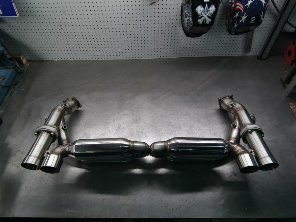

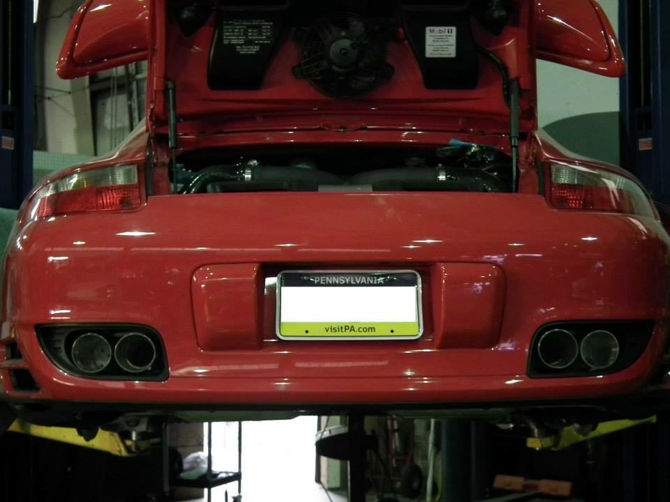

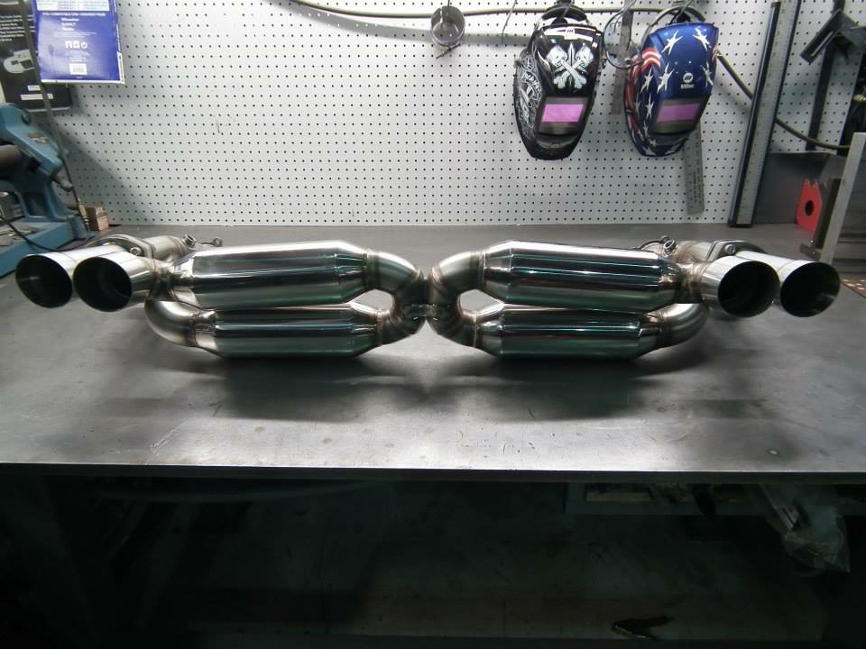

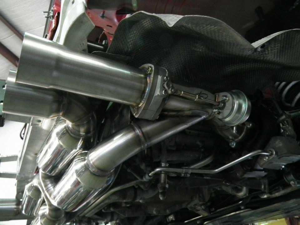

i have a switchable path exhaust that opens into straight pipes at 10psi of boost. however it was over your desired budget of $3.5k by quiet a bit. i really do not think you can get a quality system with actively changing path for that money. heck the sound performance cutouts and valves used in my system were almost $1k just for them.

When switching from one mode (open & loud) to the other mode (closed & quiet), I'm assuming 2 different ECU tunes are necessary? Or can the 997tt run in either mode with the 1 same tune?
Apologies, if this is a silly question. Logic tells me 2 different tunes will be needed.

And folks.. that right there is how you do it. Thanks for the pics Prod. 3" to 3.25" tips?
well that depends on how much power you are making and if the open path is actually freeing up any power. up until a certain point all it is, is noise.

.. or go with proEFI and use an exahust back pressure sensor to tune for BP vs VE

jordonmusser Is a GOD !jordonmusser Is a GOD !jordonmusser Is a GOD !jordonmusser Is a GOD !jordonmusser Is a GOD !jordonmusser Is a GOD !jordonmusser Is a GOD !jordonmusser Is a GOD !jordonmusser Is a GOD !jordonmusser Is a GOD !jordonmusser Is a GOD !
Curious.. did you dyno or 60-130 the difference between closed and open?
