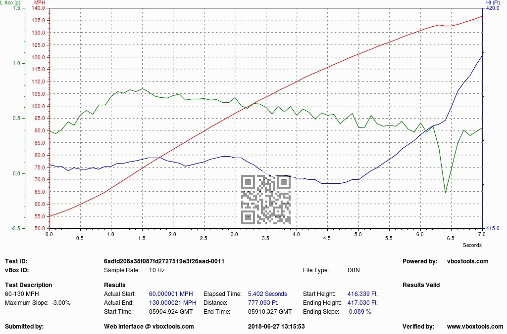

We did a 100-300 measurement yesterday: 15.05 seconds. That's all ***** out now. Fuel tank is almost 1/2 full. With a little bit of tail wind and/or almost empty fuel tank and/or cold weather we would break into the high 14s, but that's actually all this platform can do without further hardware changes - or at least all I can do.
We stop here and call it a day pushing these VTGs harder, before they melt off of the brackets

Same run, more data for different times. The car has a pretty good power bandwidth:
