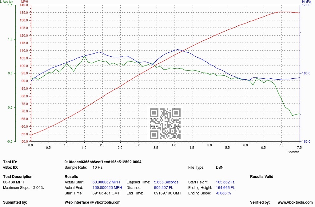

100-200 is repeatable 5.8s and 5.7s being the fastest measured time in 4th gear - so far.
Quoting myself here to update this time
This is a single pull in 4th gear, 997.1 6 speed. 100-200 kmh in 4.8 seconds. 60-130 mph in 5.6 seconds. Not too bad for VTG turbos...

Thanks,
this a 997.1 with GT2 VTGs and 48.5 mm compressor wheel (we measure the intake side here). Built engine, so I can run some torque down below, but that doesn't explain the difference to yours. Running 102 octane Aral pump fuel, but 98 should do fine as well.
Many things have changed since when I first replied here. This project is not yet finished. Very complex, very time consuming.
A 600 hp 997.1 tiptronic with OEM VTGs and just exhaust and GT2RS ICs is 0.5 seconds quicker than yours in a 100-200 run. Your car maybe has a problem. Did you ever log a run?
