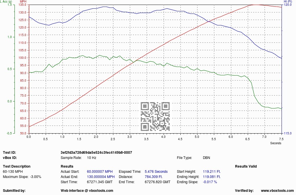

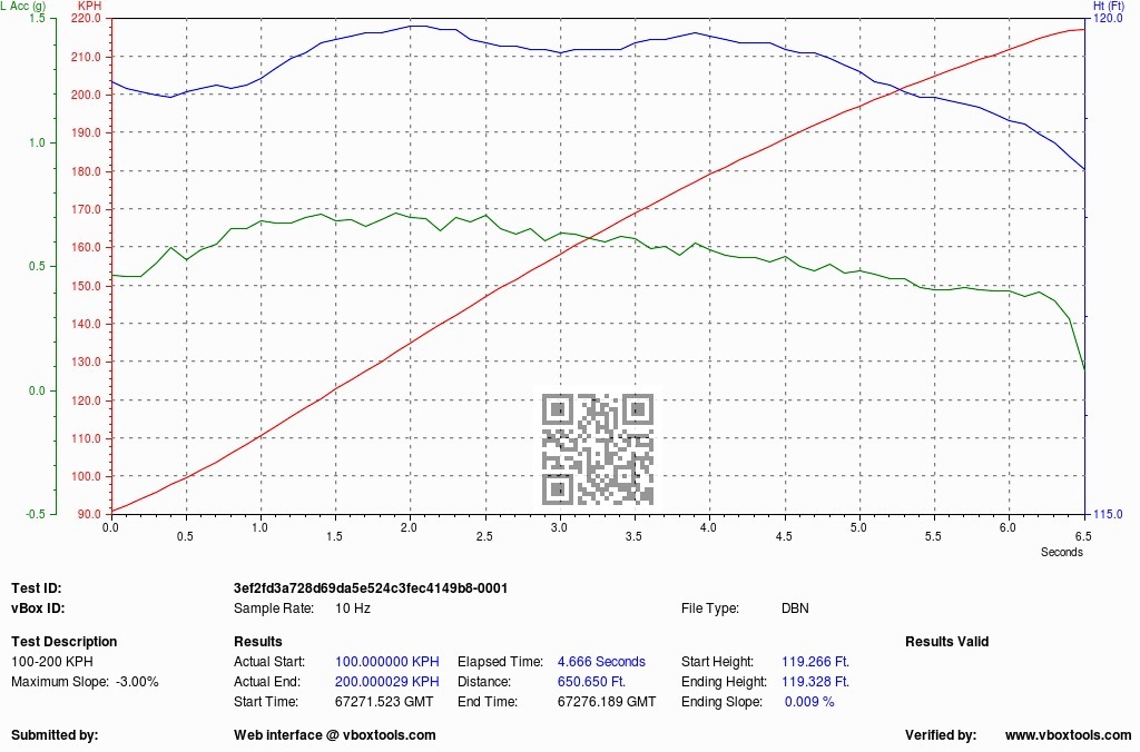

A little update on the VTG progress. All times 4th gear, flat surface, no decline, no brake boosting or any other little help that I could try Just pedal to the metal and the car does one run after the other like this...
This is not my car so I will not go for the record run, but I think it has a couple more 1/10s in it that could be activated on a dedicated run. Whoever has the record for 997 VTGs: take a look in the rear mirror. I am right there
What are your list of mods and do you have a built motor right (as I think I read that on a thread)?
Your car for sure is moving out.
