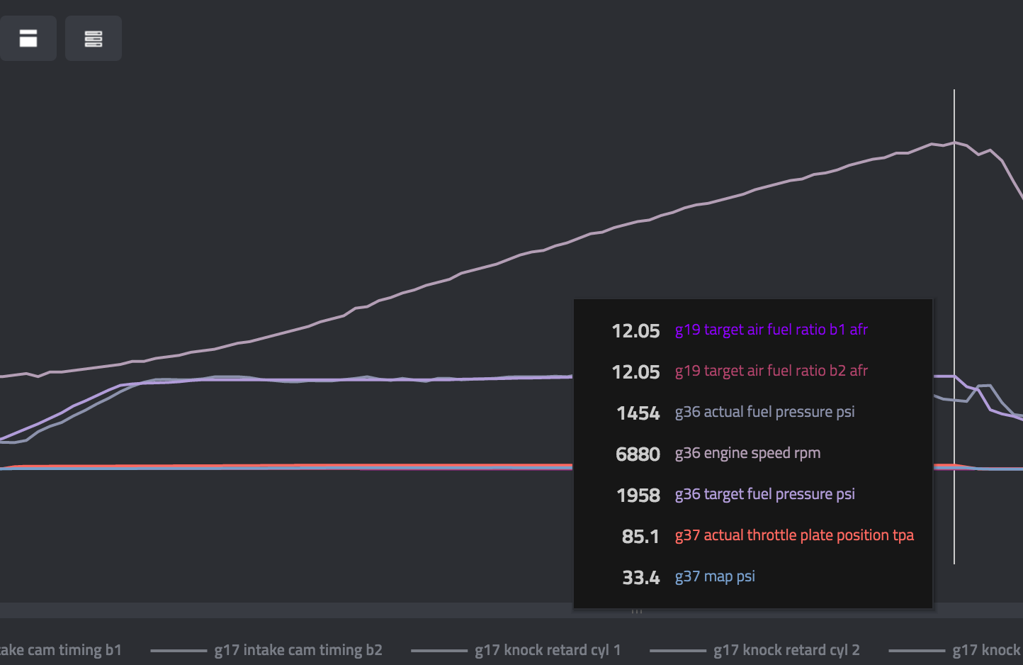

I'm remote tuning a 997.2 Turbo in Turkey and thought I'd share an example of just how badly the 997.2s need fuel to make power. This car is on stock VTGs and the only modification is an exhaust and our custom tune. Even at these relatively low-ish boost levels (33.4psi absolute logged is around ~19psi gauge at sea level) the car is having quite a serious fuel pressure drop in the top end.
This is a 3rd gear pull and as you can see the customer is at WOT all the way through (TPS is at 85%). With higher load in higher gears the situation would look even worse. We're targeting ~2000psi to redline as you can see in the graph but the pressure drops close to 600psi down from target into 1400s.
We're waiting to receive a secondary fuel injection kit here from SRM to test on a fully bolt-on 997.2 that has Champion's 68mm turbos and these issues should be history and some incredible performance to be squeezed out of 997.2s to come. Alternative is adding meth for a little more headroom or an inline fuel pump.
Let me know if any questions.
Dzenno@PTF

Yes, even on pump gas they're out of fuel and I bet they'd drop out with the stock exhaust and our custom tuning but everyone we've had a chance to work with had an exhaust on the car at the least.
Lambda is on target in this case and short term fuel trims are in the acceptable range (6-7%) most likely because even with the drop its still able to hit the desired lambda but on direct injection setups you don't want your fuel pressure in the rail dropping further than 4-500psi as its usually misfire territory at the least.
People should at the least try as simple as adding an inline pump in the tank to help keep the pressure on target. Its a simple change and given volume is still there for starters it'd be most likely help to keep at least the pressure in check to a point.

Also I can't tell from your graphs but at what rpm does the fuel pressure begin to drop?

Meth as a secondary fuel source in this case. It'd take some load off the HPFP as the DME is running closed loop fueling and it'd automatically pull back on the HPFP via injectors/fuel trims.
Originally Posted by changster
As far as the inline pump, which specific inline pump would you use, where would you install it and how would you wire it? Can you make a kit?
I'd convert a Walbro 455 into an inline or even as simple as an inline 255 to see if it keeps the pressure up. When you're fighting volume delivery (not this car) adding a pump in parallel helps. When you're after fuel pressure drops you'd add an inline....or, you could just swap in two 455s running in parallel if you can fit them in the stock bucket.

Mid 6k.
