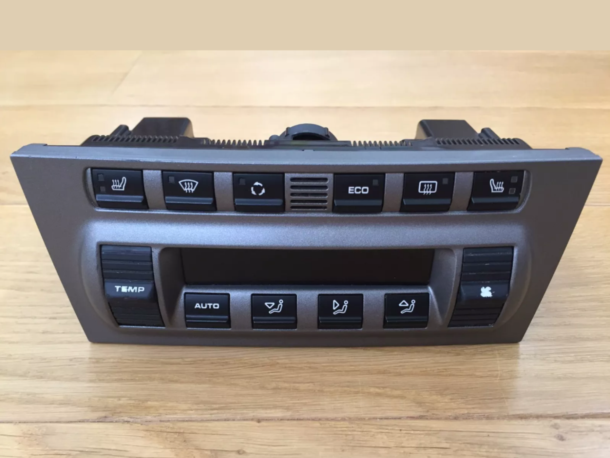

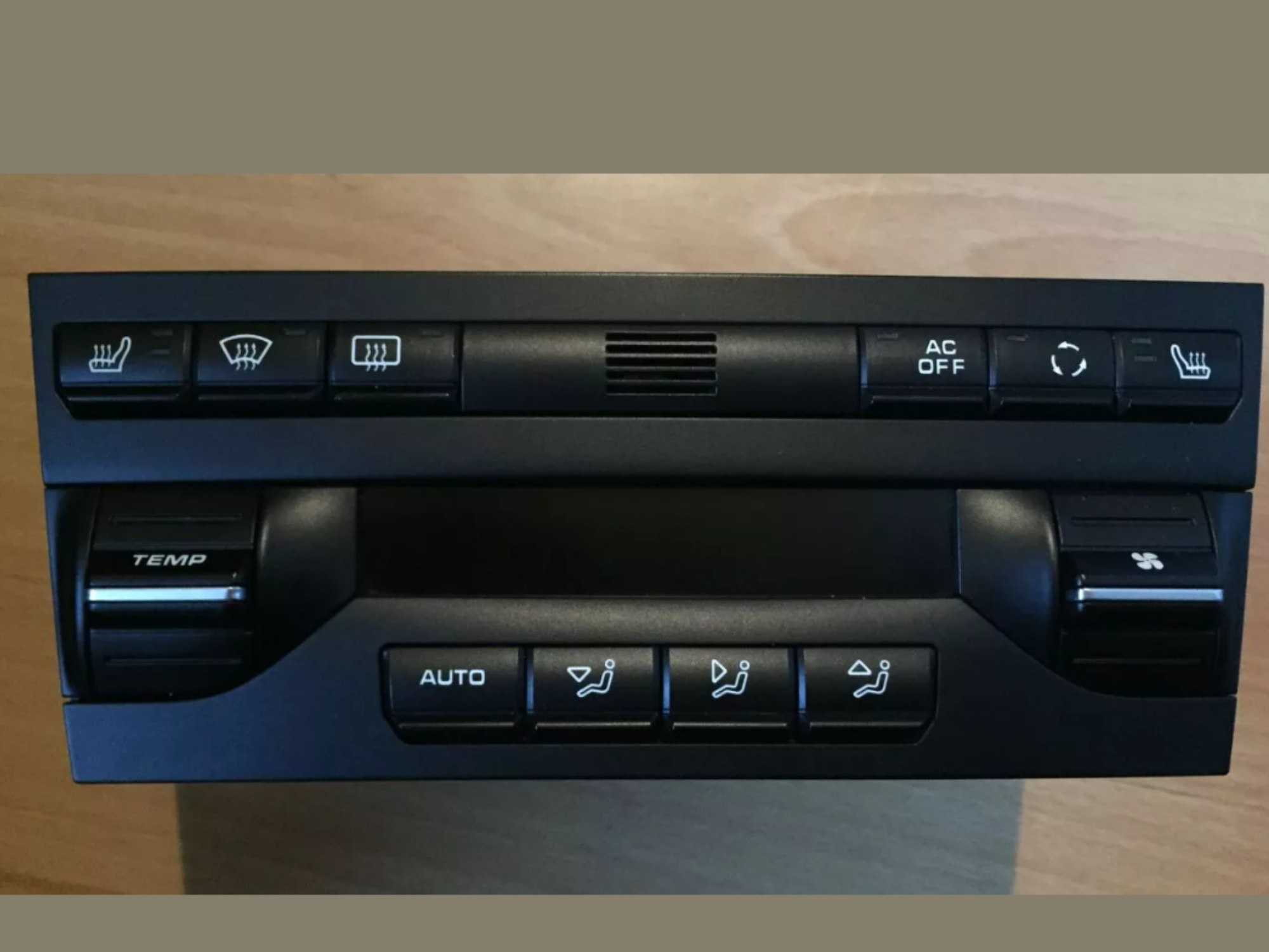

Gen 1 unit
Gen 1.5 and gen 2 unit
These pics show the difference in Hvac units. This upgrade is primarily for those of you who have upgraded your old PCM 2.1 to PCM 3
FNG the xx are version numbers and are identical in looks and operation and are 01,02,03,04
Any should work fine.
